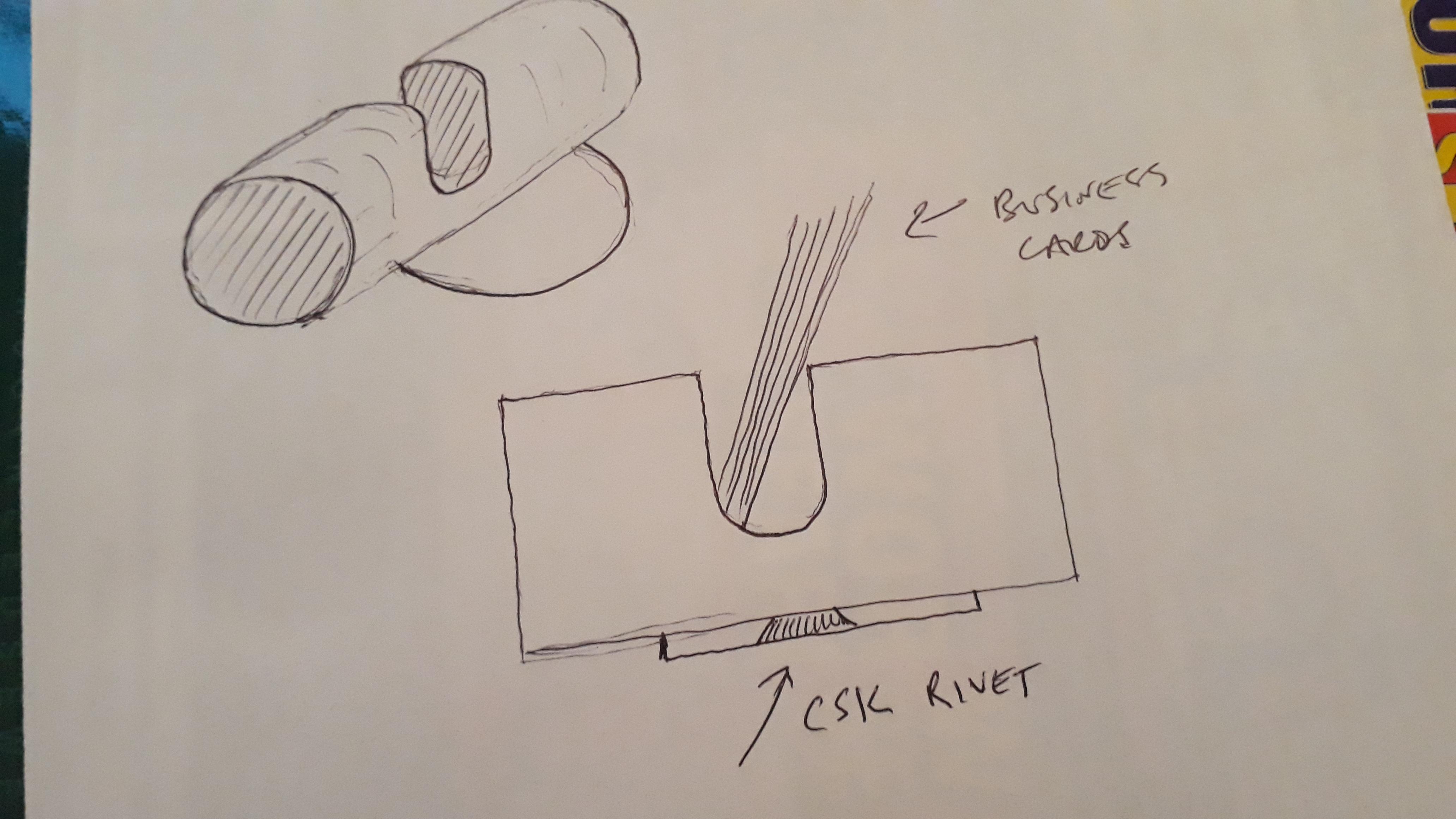

Joel OF Posted June 28, 2018 Share Posted June 28, 2018 I haven't got a picture to hand but the way I made mine was by getting about a 50mm (2") long piece of tube that was about 40mm (1,1/2") diameter, drilling a 16mm (5/8") hole through the centre on both sides, cutting out the top section down to the bottom of the drill hole, then riveting that to a little round disc. Doodle doesn't really do it justice but helps with the description anyhow. They work well and are nice and simple. Have been asked a few times for a price on making them. Quote Link to comment Share on other sites More sharing options...
lyuv Posted June 28, 2018 Author Share Posted June 28, 2018 Thanks Joel. Looks nice and smart design. I think I"ll try something like this, but forged out of a solid piece. Perhaps draw the ends into short vines. Great inspiration! Quote Link to comment Share on other sites More sharing options...

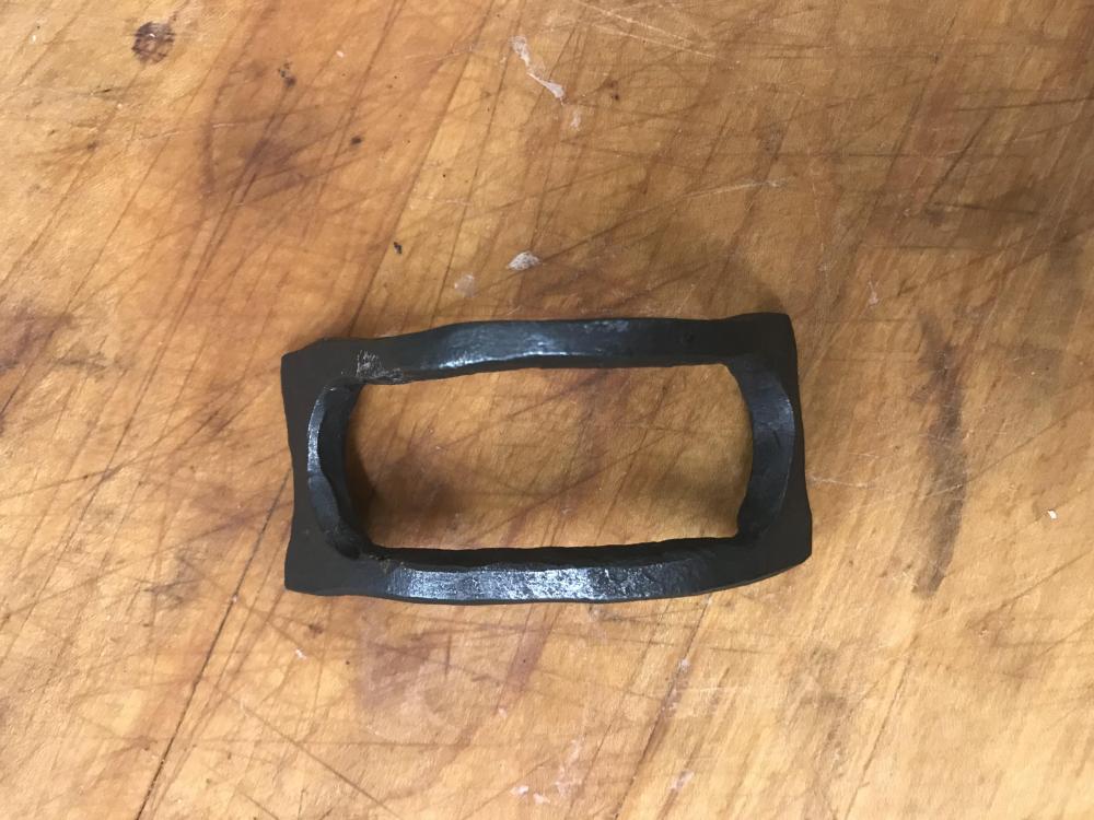

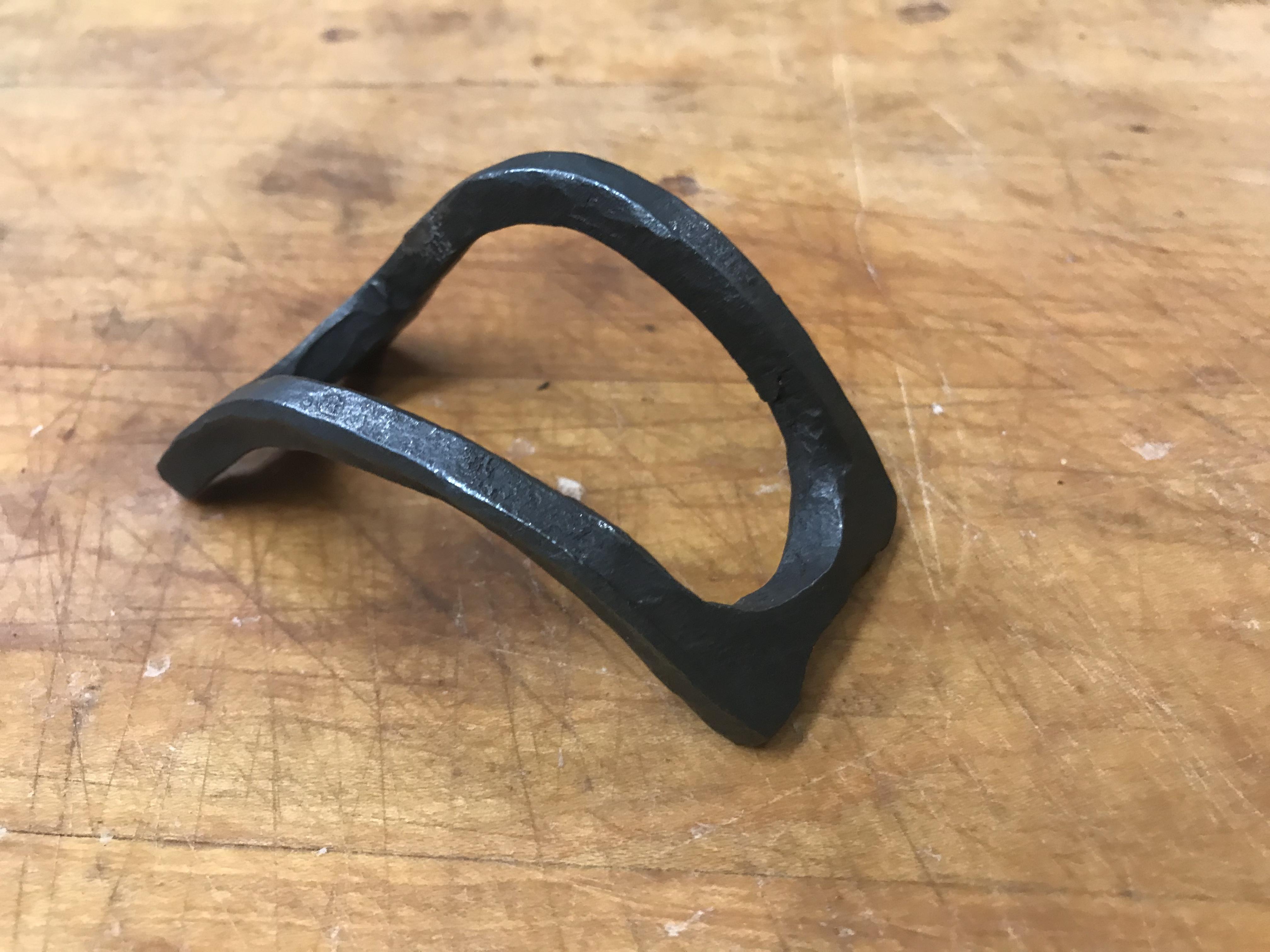

JHCC Posted July 25, 2018 Share Posted July 25, 2018 Made this up last night, following an idea that had been rattling around in my head for a few days. The starting stock was 5/16” x 1-1/4” flat bar, slit asymmetrically. Once the metal on either side of the slit was drawn out to about 1/4" square and arched, the larger amount of metal on one side gave the arch on the back a longer circumference and therefore made it taller, which supports the cards at a nice angle. Quote Link to comment Share on other sites More sharing options...
ausfire Posted July 25, 2018 Share Posted July 25, 2018 Simple and elegant. I like it. Quote Link to comment Share on other sites More sharing options...

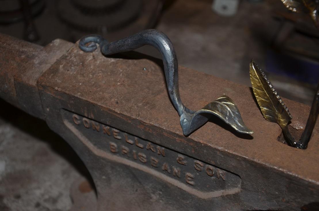

ausfire Posted July 29, 2018 Share Posted July 29, 2018 Jim, I was inspired by your elegant design. I thought I would try a similar one making the card holder in the shape of a broad leaf. I found that having the scroll upright wasn't as stable as I would like so I changed it to horizontal. It holds the cards OK, but I think my next one will be better. I'll make the leaf a little wider and curl the scroll back more. Thanks for the idea. What was your starting stock? I used 12mm round bar. Quote Link to comment Share on other sites More sharing options...
