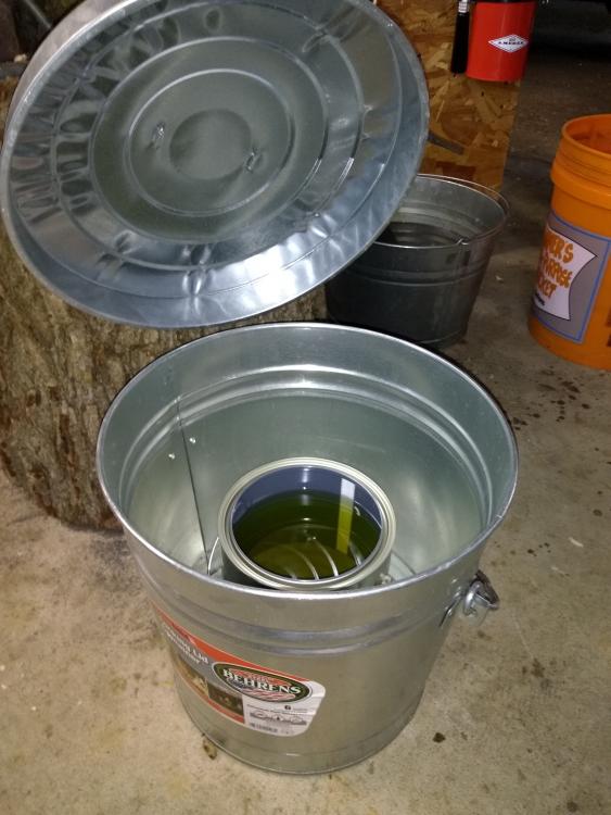

I just got a lidded bucket for my quench oil.

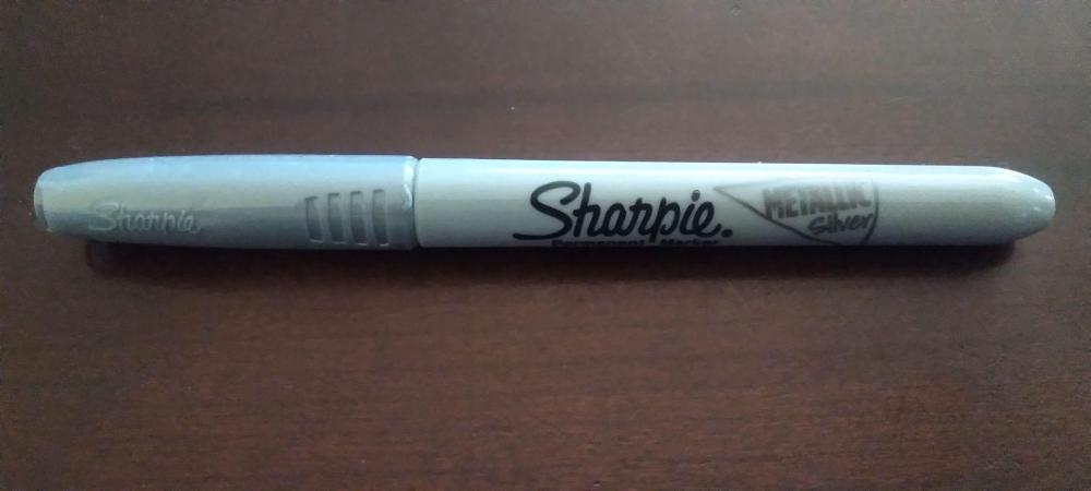

  That's a handy idea Lary.  Do you give them a little twist while pulling them out to help keep the caps in the hole.  Have you ever tried metallic silver sharpies?  They show up suprisingly good on steel, brass and copper for layout and marking.   Not so much on shiny material or rough rusty stuff, though.  Maybe it's been mentioned before....
Thank you Scott. I just push them in tight, did this a couple of days ago. I suppose I could glue them in and just keep using the same cap when a pen wares out. I don't think I've used those metallic sharpies yet.
Plain old colored pencils also work better than black markers or graphite pencils.  I also like soapstone markers because the marks, being a mineral, tolerate heat better than most media.
  Part of the reason I mentioned the silver sharpie is it seems to tolerate heat.  YMMV.  I would think colored pencil marks would melt.  Soapstone blows off, in my opinion.
