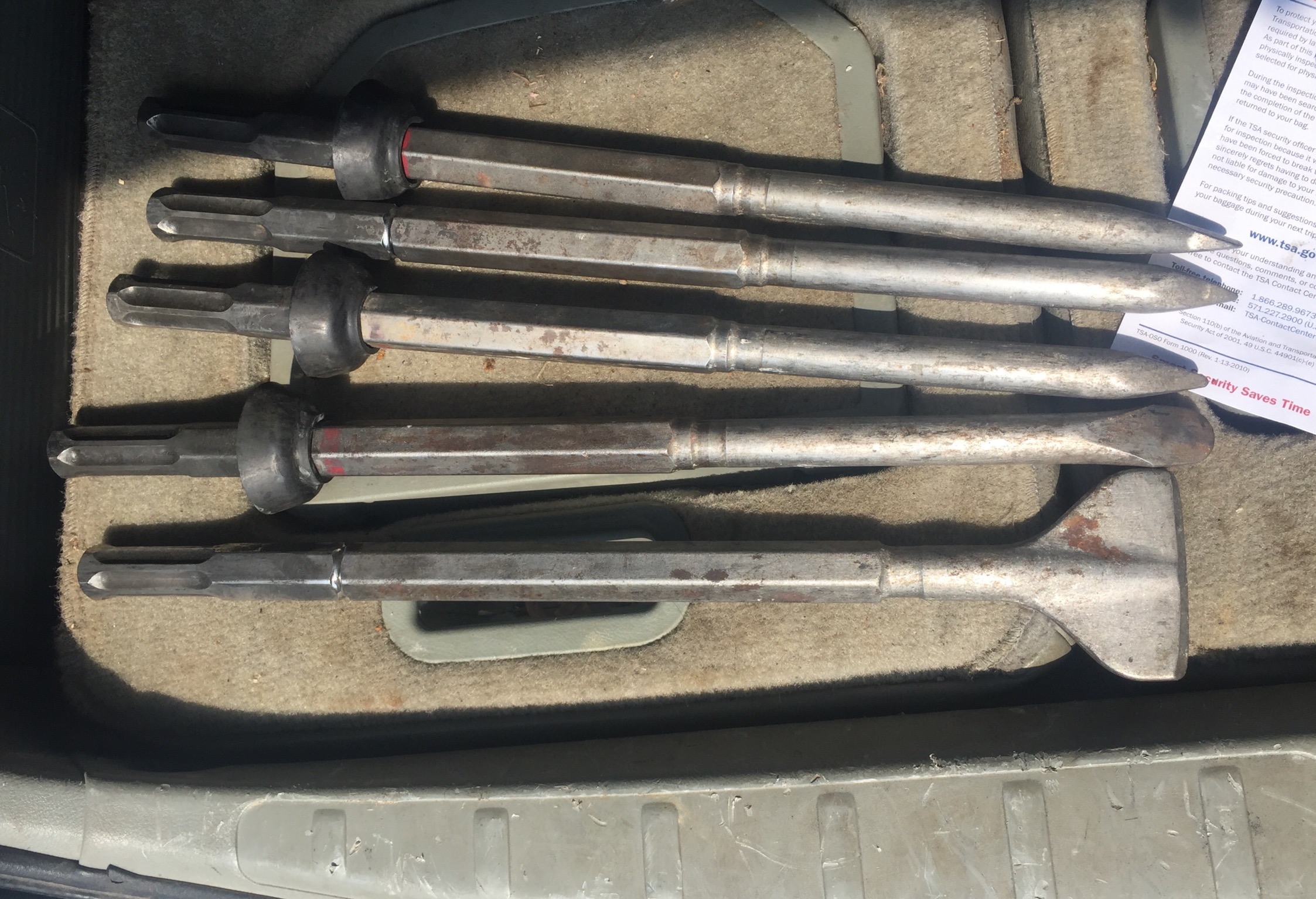

JHCC Posted May 25, 2018 Share Posted May 25, 2018 2 hours ago, Joshua Taylor said: Jackhammer bits also sound like a good idea... Just gotta find a place that'll have them in a scrap heap! Almost all of my jackhammer bit supply (with the exception of some unusual offerings that IFI member Stitch got at the industrial surplus place) were obtained from the tool rental counter at Home Depot for a buck or two each. In the most recent instance, the guy told me that the bits only fit a model that they hadn't carried in years! Here's a bucketful that IFI member Cavpilot2k picked up at a local tool rental place: Note the collar around the shaft of these tools. This is great for hardy tools, as it's a pre-made shoulder. Here is a hardy that I just made out of a similar bit: (After forging and heat-treatment, before finish grinding.) Quote Link to comment Share on other sites More sharing options...

dickb Posted July 30, 2018 Share Posted July 30, 2018 Many stores that rent jackhammers will routinely discard used jackhammer bits, even the ones that have little or no noticeable wear. They make excellent hardy tools and the price is right. Check Home Depot, I have gotten enough jackhammer bits from them to last a lifetime and usually for free. I just let the work air harden after forging, That leaves them softer than the face of a hammer, but much harder than the hot material you are cutting. A missed hammer blow will put a dent into the hardy, but it's easy to dress it up with a file of a grinder. Quote Link to comment Share on other sites More sharing options...
Cavpilot2k Posted July 31, 2018 Share Posted July 31, 2018 I'll second the jackhammer (pavement breaker, really) bits. THat bucket pictured above was indeed mine. I got those for nothing. I stopped by a tool rental place and asked if they had some spent ones. I offered to pay, but the guy said no - he'd rather give them away than bother making the trip to the scrap yard for the pennies he'd get for them. I am going to make him something from one of them and give it as a gift. The only downside is that they are a pain to hammer, but it's a good lesson. If you have a 1" hardy hole, they don't even require that much hammering to square up the shank. he built-in collar is awesome. Here is the hot cut I just finished yesterday from one. I left the shank long so that if it gets stuck, I can tap it from the bottom. It fits snug, but not "tight". Quote Link to comment Share on other sites More sharing options...
JHCC Posted July 31, 2018 Share Posted July 31, 2018 Plus, in addition to the hot-cut, you’ll have enough steel left to make some other fun tools. Quote Link to comment Share on other sites More sharing options...
Cavpilot2k Posted July 31, 2018 Share Posted July 31, 2018 I plan on using the rest of the non-collared portion of my bits for drifts and warhammers. Quote Link to comment Share on other sites More sharing options...
