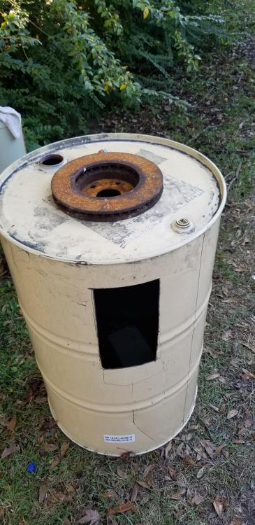

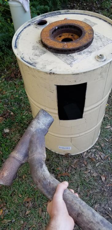

  2. UPDATE; I bought an angle grinder from HF and cut out these holes. The brake rotor fits nicely, though my only problem is I'm not sure how I'm going to fit the exhaust pipe for my air to the brake rotor... I don't have a welder and cant afford one. Any ideas?
  3. Thanks for the information everyone! I appreciate it! Arkie, Thank you! And thanks for the ideas. I was thinking of doing the same thing with the small door at the bottom. If not, I may just cut and deburr a rectangular opening so I can fit in my piping for the air supply. Daswulf, Thanks for the warm welcome! And thanks for the dimensions. It should give me a better idea on exactly what I am going to need. My tools are a bit sparse right now, so I'm going to have to find out if my dinky little B&D drill can even drill through the drum lol. Glenn, As always you're a wealth of knowledge, thank you!

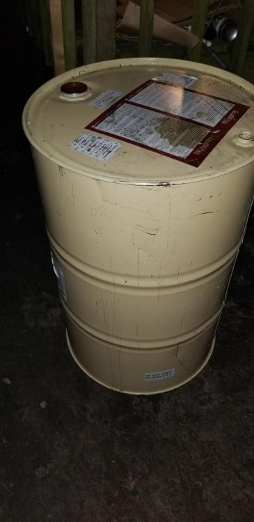

  4. Good evening everyone! Not sure if y'all remember me, but I just got back from my deployment about a month ago, and I'm starting my adventure into blacksmithing finally after two years of researching! That being said, I wanted to show you guys what I found! I got this baby for free, gonna make a 55 drum forge out of it. Just need the brake drum. (I plan on going to the scrapyard this weekend to look if y'all have any tips for me!) The barrel was previously used for poly spray foam, which means if I'm correct I shouldn't have to worry about blowing the darn thing up when I go to chop away with an angle grinder. (I read the labels and didn't see anything about flammable). If you guys have any advice, tips, or tricks feel free to let me know! Just wanted to share this with ya. Semper Fidelis
