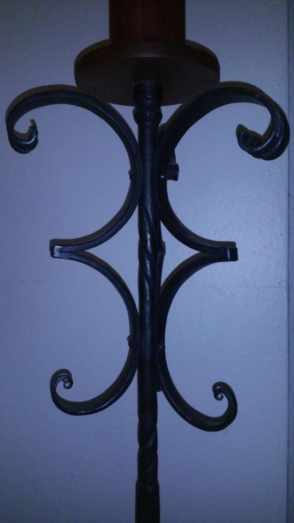

Aushin Posted May 3, 2018 Share Posted May 3, 2018 Hello there! I'm a Swedish apprentice blacksmith. I'm currently making a project about blacksmithing twists. I'm trying to gather knowledge about twists but i find it difficult to find history of it. So it would be appreciated if i could get some help. (not sure if I'm in the right thread). Here is some of the Twists I've done. Quote Link to comment Share on other sites More sharing options...
ausfire Posted May 3, 2018 Share Posted May 3, 2018 Some interesting twists there. I've posted this pic before somewhere, but here are a few of my twists. Nothing that hasn't been done before, of course. It would be cool to invent an original twist. Quote Link to comment Share on other sites More sharing options...
Glenn Posted May 3, 2018 Share Posted May 3, 2018 This is where modeling clay becomes your friend. You can play with all sorts of twist designs quickly to see which you like. You do not have to only use solid material, you can get some interesting patterns with angle iron, angle iron plus round and or square stock, and twisting pre-twisted elements together. Let your imagination run wild with clay, then take it to the forge and make them in metal. Quote Link to comment Share on other sites More sharing options...

Joel OF Posted July 8, 2018 Share Posted July 8, 2018 I was experimenting the other day and at one stage landed on this, it was pretty simple to produce: 2 full twists, hammer the twists flat, 2 full twists again in the same direction. I'm not usually a fan of twists but I thought this one was kinda interesting. Quote Link to comment Share on other sites More sharing options...

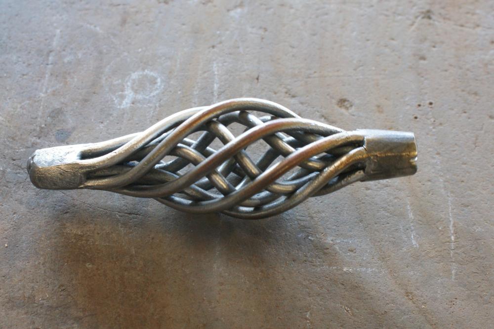

John B Posted August 5, 2018 Share Posted August 5, 2018 Managed to have a bit of a play today, and ended up with this Question is, which one is the reverse twist? Quote Link to comment Share on other sites More sharing options...
anvil Posted August 6, 2018 Share Posted August 6, 2018 On 8/5/2018 at 2:17 PM, John B said: Question is, which one is the reverse twist? Excellent! Depends on if you are a left handed smith, or right handed. I would give the inside ones a full twist clockwise, and leave the outside ones straight to start out.. Then open up a half twist counter clockwise. That should leave two half twists(180*) each in opposite directions. Quote Link to comment Share on other sites More sharing options...
John B Posted August 7, 2018 Share Posted August 7, 2018 12 hours ago, anvil said: Excellent! Depends on if you are a left handed smith, or right handed. I would give the inside ones a full twist clockwise, and leave the outside ones straight to start out.. Then open up a half twist counter clockwise. That should leave two half twists(180*) each in opposite directions. That would work, but not appear the same as the one pictured, less of a helix which then feels different when held if used as a handle. Give it a try, and let's see the results for comparison. Quote Link to comment Share on other sites More sharing options...
