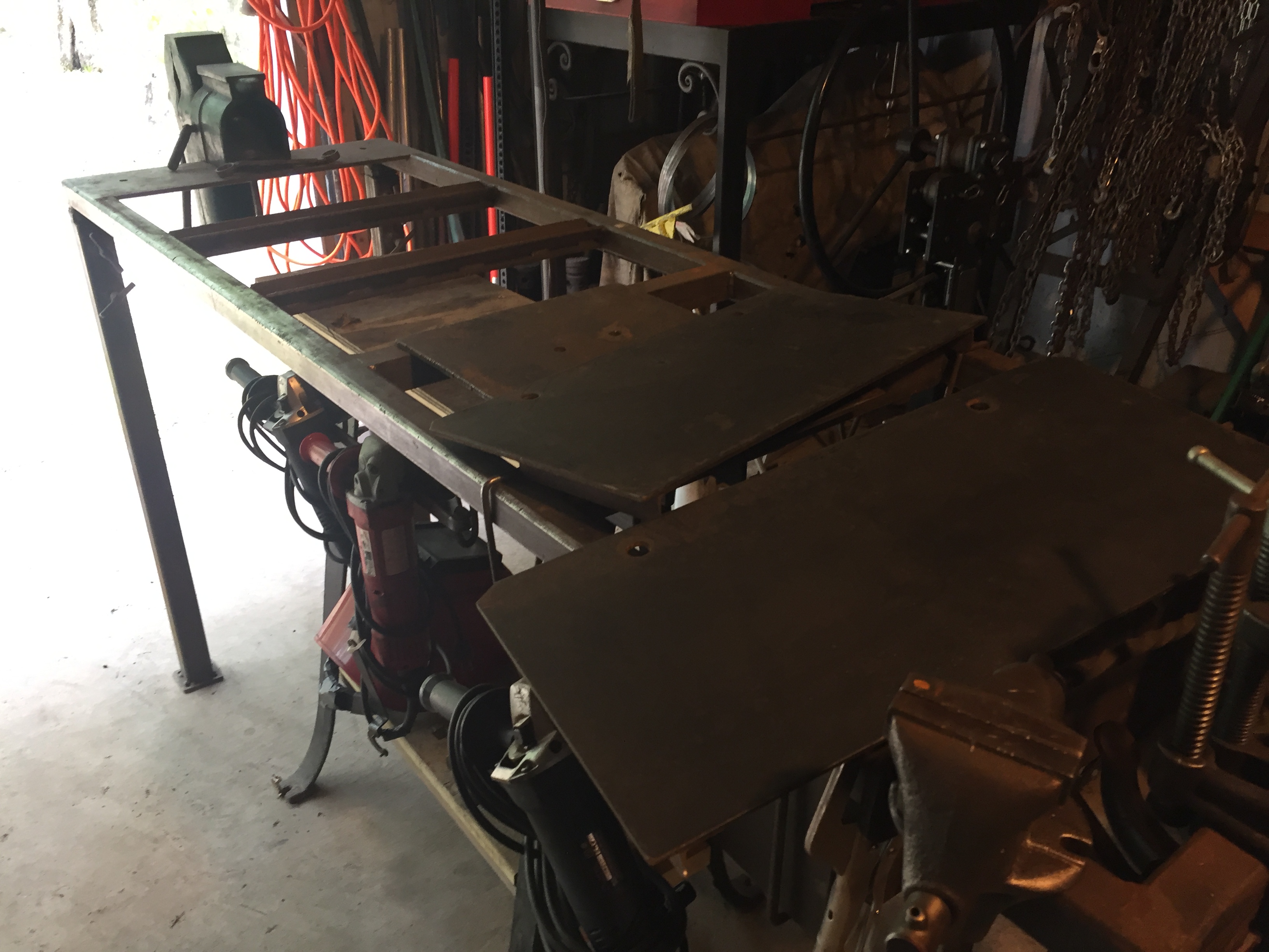

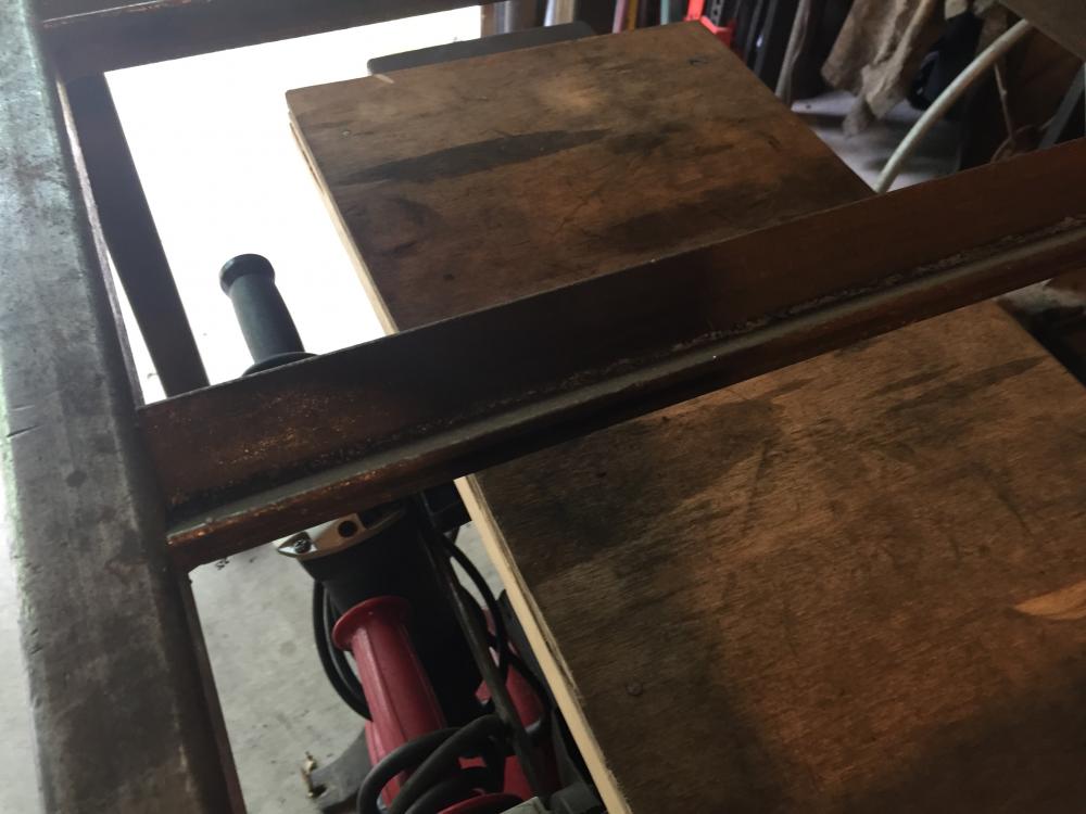

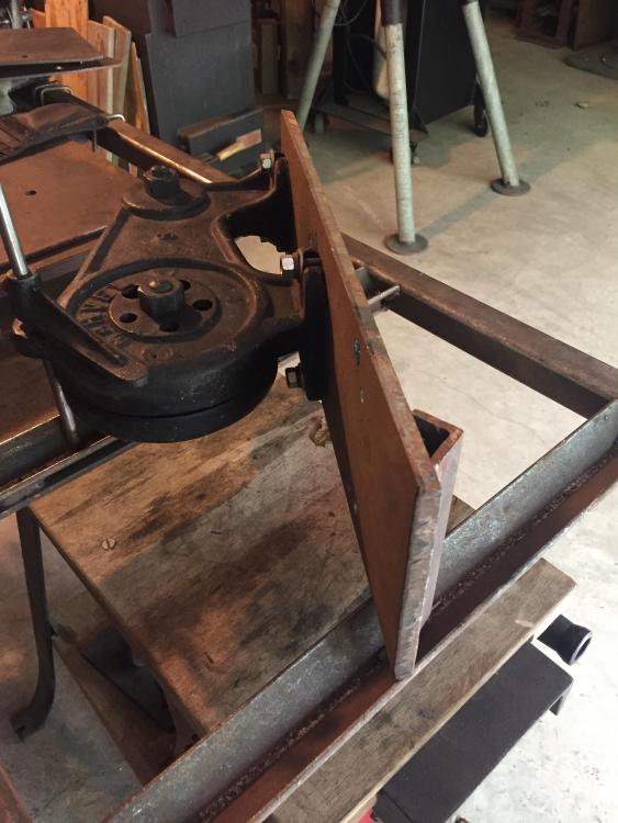

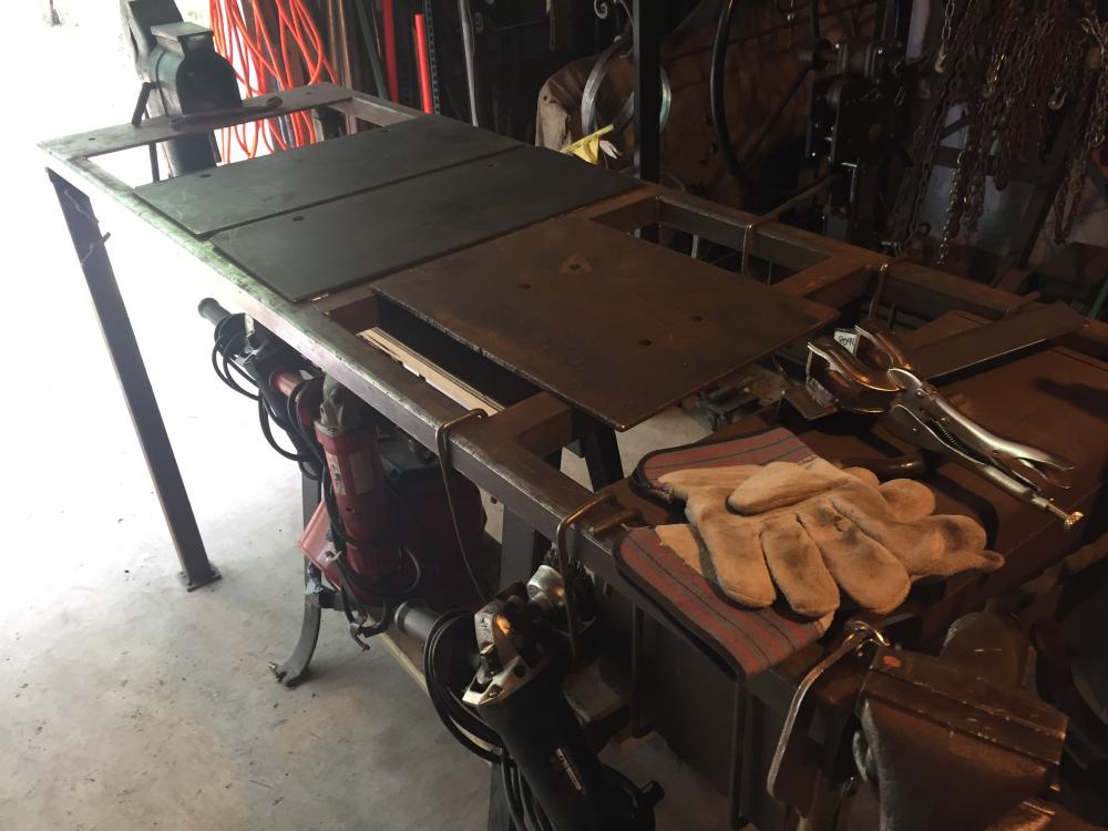

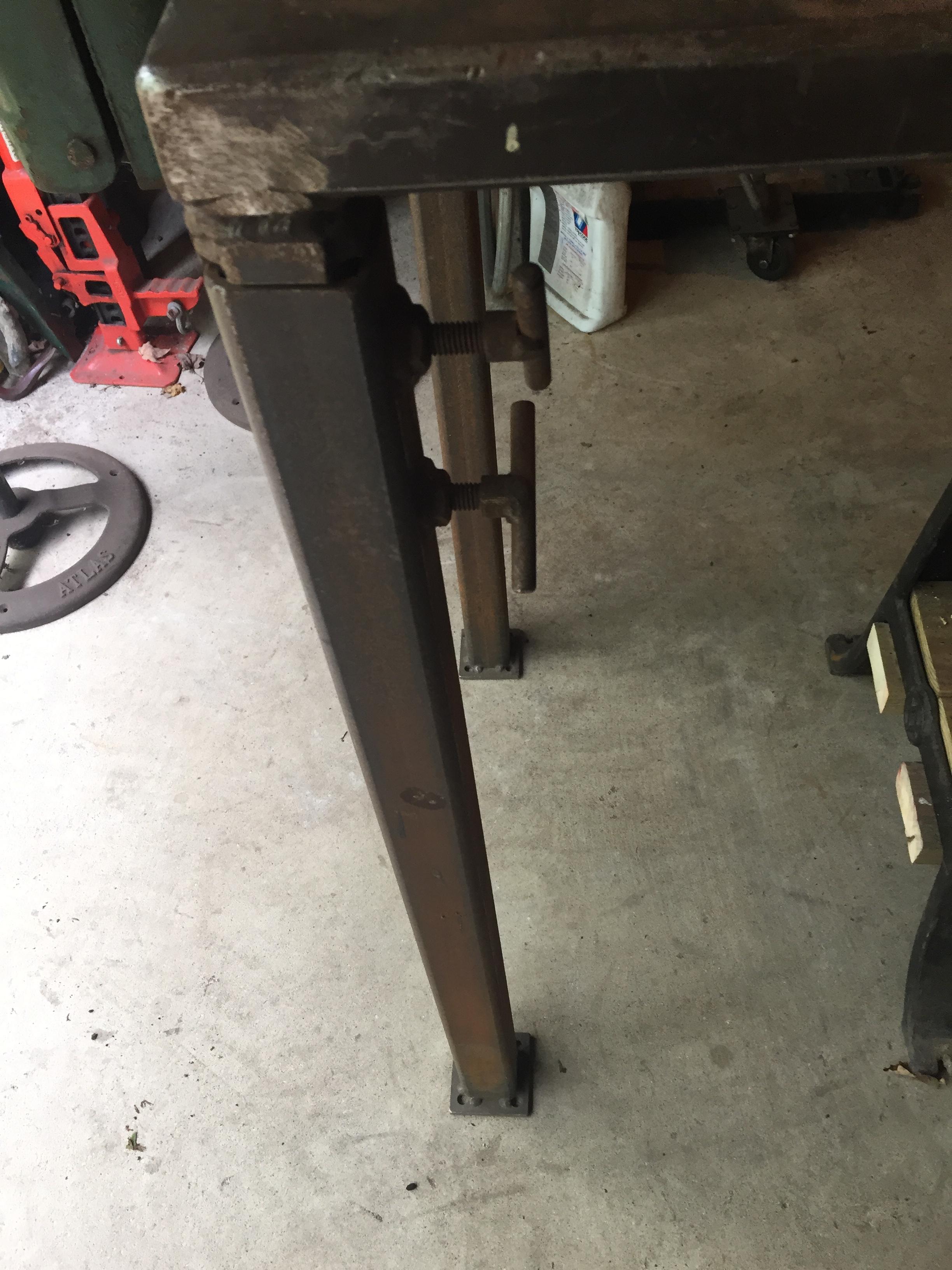

Jim Coke Posted May 19, 2017 Share Posted May 19, 2017 Greetings Scrambler, I designed my welding tables years ago with a unique leg leveling system. I used about 10 inches of square tube welded to the top section ( short legs) . The outer legs, square tube with square floor plates I put pinch bolts with handles so I could adjust for uneven surfaces from the top. They have served me well for years., I will try to add a picture later today.. Forge on and make beautiful things Jim Quote Link to comment Share on other sites More sharing options...
Jim Coke Posted May 19, 2017 Share Posted May 19, 2017 Greetings Scrambler, The pictures show my leg design. A few other things... Angels welded in the center with flats on the bottom for clamping fixtures and other tools . The removable top plates also have mating angles on the bottom. I have many devices that mate and clamp into the angles for holding and cutting. I made 2 complete benches which clamp together for bigger projects ( railings and big flat stock) I hope this helps.. Good luck on your build. Forge on and make beautiful things Jim Quote Link to comment Share on other sites More sharing options...
WayneCoeArtistBlacksmith Posted May 20, 2017 Share Posted May 20, 2017 And with a Cole Vise on the end of the table. Thanks Jim for all the information that you have given me about this unique vise and drill system. I have two set up on two of my tables and I use them daily. I haven't gotten much use out of the drill but am glad that I have a complete setup. Between you and Fred at Quad State I have learned a lot over the years. I miss you, be sure and tell Fred that I miss him too, along with all the other friends that I made up there. Let me know how I can help you Thank you, Wayne Quote Link to comment Share on other sites More sharing options...

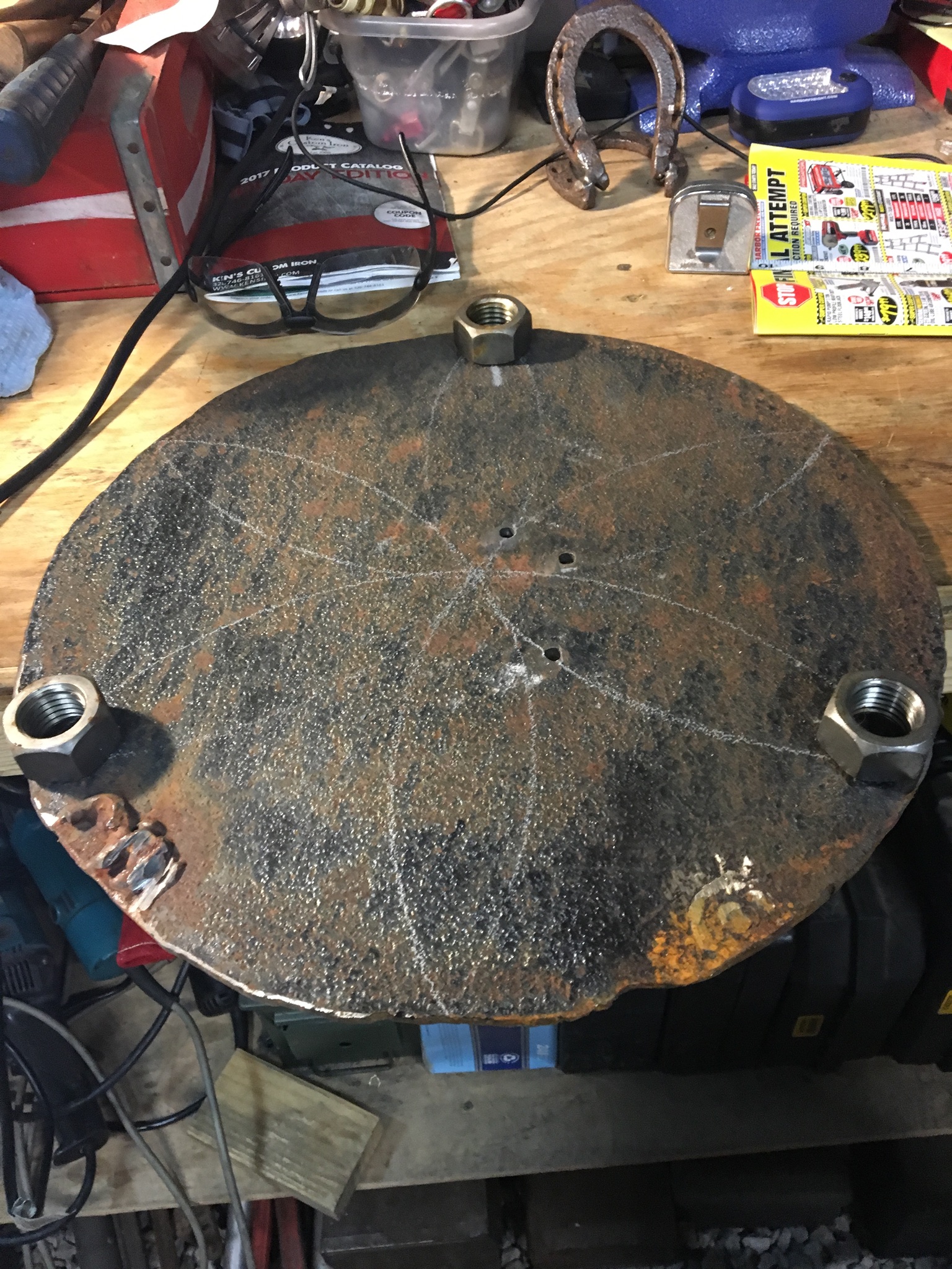

TimberBull Posted March 1, 2018 Share Posted March 1, 2018 I cleaned the material and clamped the nuts to the top with vise grips. Tacked and then welded all around the base of the nuts. I then screwed the bolts in and heated with a torch until I could pull them into the angle I wanted. Very sturdy and heavy forge table. Quote Link to comment Share on other sites More sharing options...
