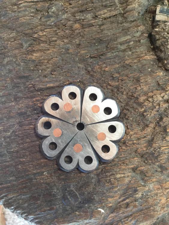

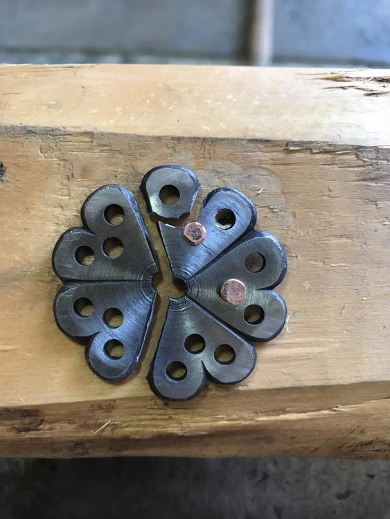

Ranchmanben Posted December 7, 2017 Share Posted December 7, 2017 Those look great! Did you build everything yourself? I started on a set of spurs to give to the lady for Christmas and all was going well until I forgot to temper one of the rowels after I hardened it. Look like I’ll get them done just in time for Valentine’s Day. Here’s the desired result, although not finished and the other one Quote Link to comment Share on other sites More sharing options...
Pancho07 Posted December 7, 2017 Author Share Posted December 7, 2017 Thanks George. 42 minutes ago, Ranchmanben said: Those look great! Did you build everything yourself? I started on a set of spurs to give to the lady for Christmas and all was going well until I forgot to temper one of the rowels after I hardened it. Look like I’ll get them done just in time for Valentine’s Day. Here’s the desired result, although not finished and the other one Kinda sorta not really. I bought all of the pieces from a water jet company. I made the rowels but figured for the first couple sets I could cheat alittle bit. I did bend the bands in the forge. Just used 10 gauge mild for the rowels, if they wear out too soon we’ll try something different. Quote Link to comment Share on other sites More sharing options...
