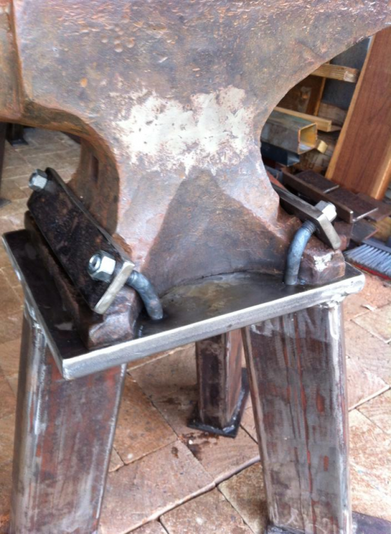

I bolted down my anvil with 5/8 bolts just in case.
Stand is 5"x2.5"x1/4" RHS welded at 12 degree angle filled with sand and oil. Base plate is 1" Bolts are 5/8" x 4", plate for the bolts is 2"x1/2"
The anvil sounds as if it was made of concrete. No vibration whatsoever. I do keep a brush nearby though :P
My anvils aren't held fast, they're in a flange up angle iron frame, the hammer and tong racks are about all that wedge them in place. They're reasonably quiet for a Soderfors and a Trenton and vibrate some. I WISH the scale vibrated off! If I forget and use my ungloved hammer hand to brush it off I get reminded how much black hot scale smarts when it sticks to your skin like a steak in a dry skillet.

I have also read this passage and gave it some thought and experiment. I tried it and found no real migration of scale. Only thing I did not try was heavy striking, and I think that is were this would actually have some benefit. English pattern anvils are pretty much tuning forks, and the harder you hit them the more they vibrate.I think anvils have it pretty easy compared to the old days . Now days we use a 2 pound hammer on a 300 pound anvil etc. I suspect this is why the scale did not migrate much when I tried it. My "test" was with 300 and 500 pound forged steel anvils but only with 4 pound or lighter hammer. On a related note, I use a blacker in my shop. The anvil is cast and has no ring, just a dull thud. I have found if I have the power turned up much and its not tightly clamped at the base, it will jump if forging in the center, and rock if using the hardy tools. Makes the scales move around for sure, although its concerning to see a 500 pound anvil bouncing off its base!
I think it's a good illustration of a writer passing on "knowledge" about something they know nothing about.  I've worked on a lot of light anvils that had plenty of vibration in them.... and never saw that the vibration kept the scale from building up on the face.
As noisy as a wrought iron anvil is, I want mine bedded in silicone caulk to deaden the sound.  No way I'm working on one that's ringing like a church bell!

I read some place that they also angled the anvils away from them slightly so the scale would slide off.  Never seen an old picture that showed an angled anvil.  I'd rather have the face of the anvil as level as can be and the anvil secured down tightly.  Like Marc1  said, I'd rather have my hearing than than hope that vibration takes off the scale.  I wear weight lifter gloves that are leather but have the fingers exposed so it's really easy to swipe off the scale with the covered palm of my hand.

I too have a Blacker anvil I use as my main shop anvil and thought I wouldn't need to fasten it in place and it pretty much was so until I was doing some heavy sledging on it and saw it was creeping on the stand.  So I used a handful of wire fence staples to "corral" it. Used it last week helping a new smith work on a bearded hatchet from a large ball peen.  Used the horn to support and create a smooth top curve while we fullered the "bottom" with various sized rounds to create the profile he wanted.
