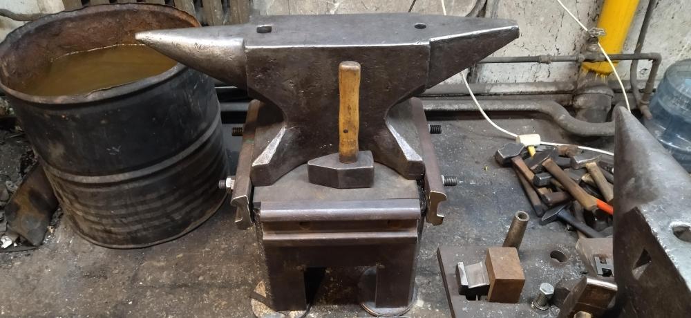

2" plate for the base and the legs are filled with compact oil soaked sand/gravel to reduce ringing.  Anvil is a 150KG Kohlswa.
Nice, I think I need that side tray.
  • 2 months later...
Well, that's a heft chunk o' steel.
Oh MY! That's one heck of a solid stand Voldemar. What are the steel shapes you are using for the rim around the edges? Some kind of rail I've never seen or imagined?

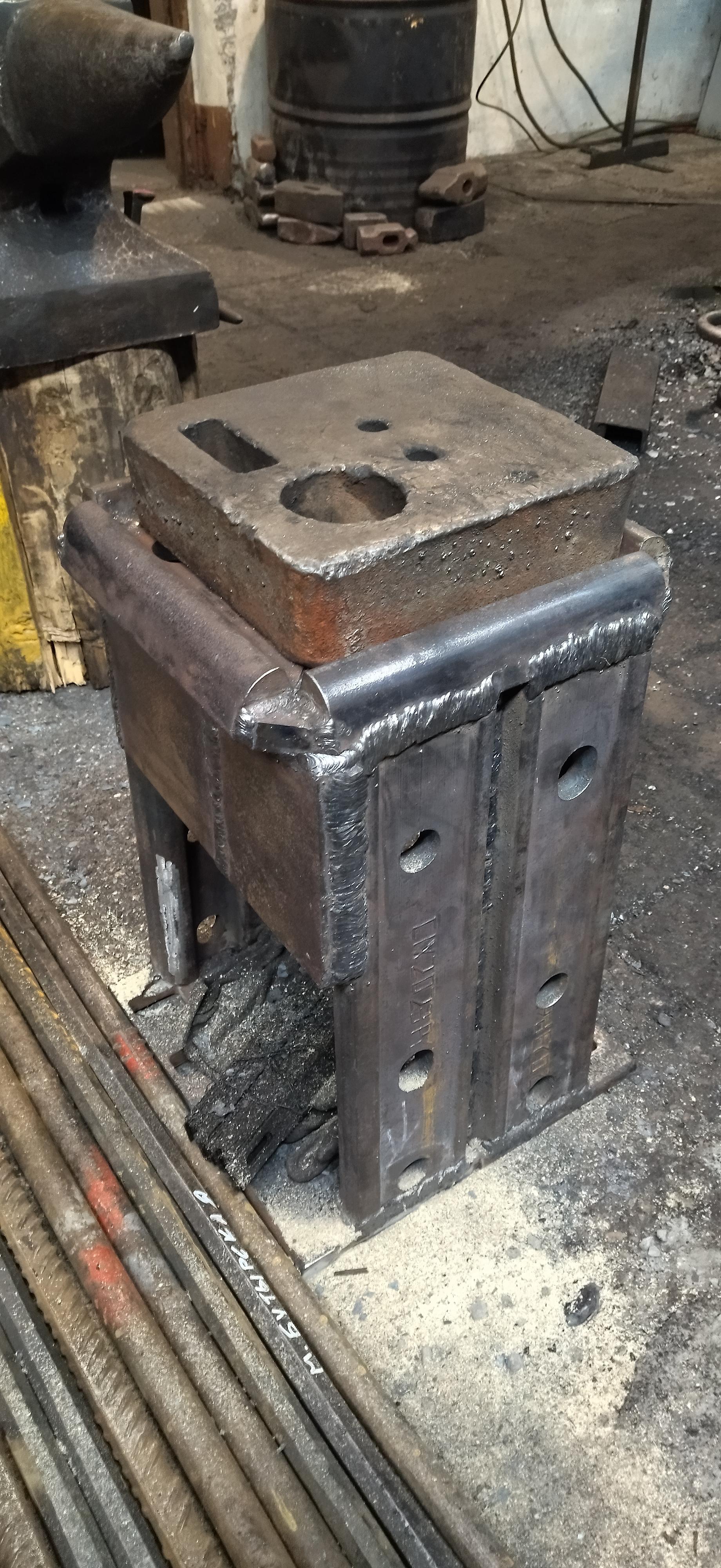

This is a railway part that holds the rails together.
I used the same parts to make a stand for the block.
Yours look different than ours, this side of the planet. Ours are pretty good steel, the low end of medium carbon, made to be tough and not work harden they make good top tools.
Here in the United States, we call that a "fish plate" (sometimes "fishplate" or "fish-plate"). "To fish" was originally a nautical term for repairing a mast by lashing boards (called "fishes") around the outside of the broken section.
Is there a preferred method of cutting fish plate?  American style fish plate for clarification.  I ask preferred method because I understand rr track is easier cut from the bottom to the work hardened top.
When possible I cut it in my horizontal vertical band saw using a carbide bi metal blade. The oxy propane cutting torch works nicely as well. I doubt oxy acet would cause problems.
A plasma cutter works pretty well too.
