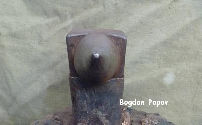

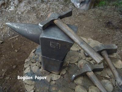

VaughnT Posted January 24, 2017 Share Posted January 24, 2017 I would dearly love to have some of those! I've been looking for just such a thing to make into a traveling anvil. Personally, I would have stood the hammer on end like a Mjolnir and used the big face much like a Popov anvil you see here at the 23:09 mark - https://www.youtube.com/watch?v=kyLjZ8N9_dc&t=36s The face is domed, but it's like a squished ball with a flat spot in the middle. Very practical design and it has the look that's just perfect for doing demos where folks expect you to be doing it the "old fashioned way". Quote Link to comment Share on other sites More sharing options...
