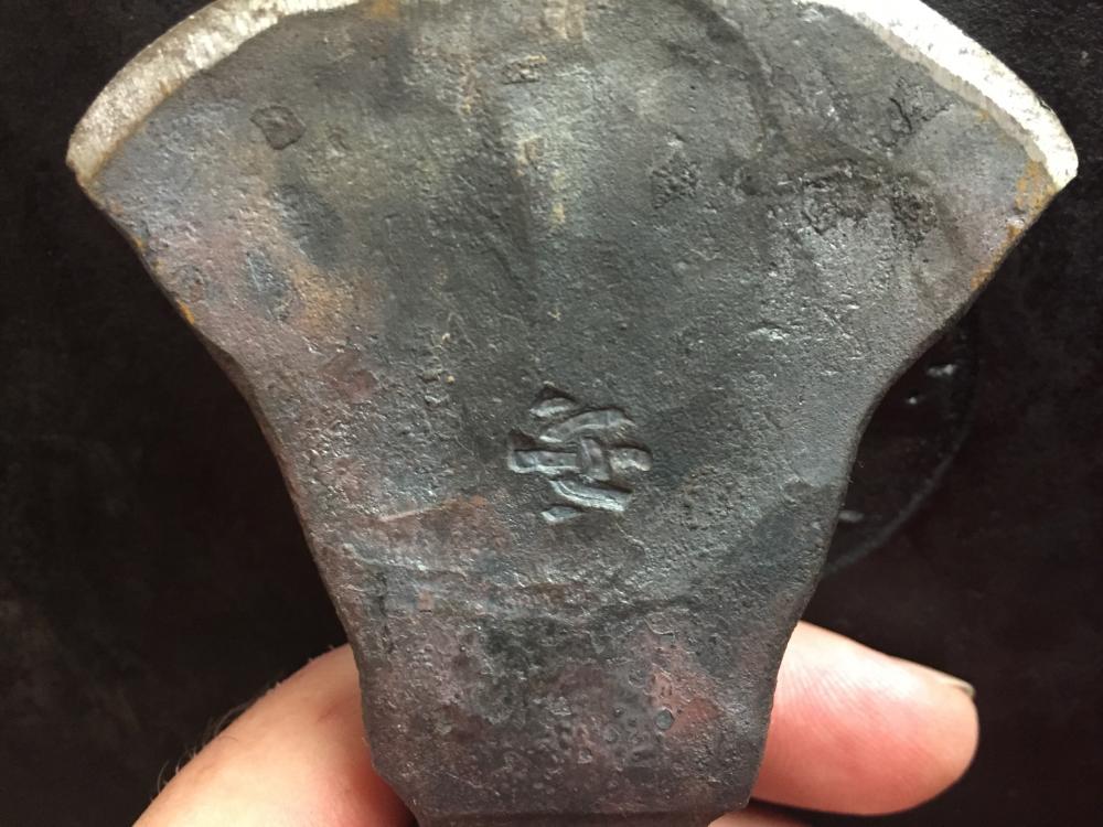

Mark Ling Posted December 17, 2016 Share Posted December 17, 2016 The most used tool would be my 3.5lb rounding hammer that Matt Marti and I made, its the same one in my profile pic . Its the hammer that I use the most, my second most used hammer would be my 4lb harbor freight hammer that I converted to a very aggressive rounding hammer for the heavier work.The coal rake is the second most used tool, though one that I could go without for a while if I had to, as I tend to use whatever is in my hand to manage the fire, whether that's tongs, a punch, a piece of steel, etc. The third most most used tool would be the Brazeal style hot cut hardy that Matt Marti and I also made. in an average 10 hour day of forging it gets used at least 20 times. Speaking of forging tools with Matt Marti, tomorrow I'll be going over to Cleburne, Tx (a little more than 2 hours away) and will hang out with him, and we'll forge a 3.5 straight peen hammer. Matt basically just forges rounding hammers, and the tools to make hammers, so this is a walk in the park, though I'll be the one striking with the 12lb sledge. We will also make some other tools. The first tool that's on my list other than the hammer, is a hammer eye punch, and then after that we will do a top fuller, bottom fuller, and basically just whatever we can do in my limited time there. Should be a lot of fun, and will help out with my evolution of tool making! Wish me luck! Littleblacksmith Quote Link to comment Share on other sites More sharing options...
Mark Ling Posted December 17, 2016 Share Posted December 17, 2016 heres a picture of the hammer and hot cut- Quote Link to comment Share on other sites More sharing options...
