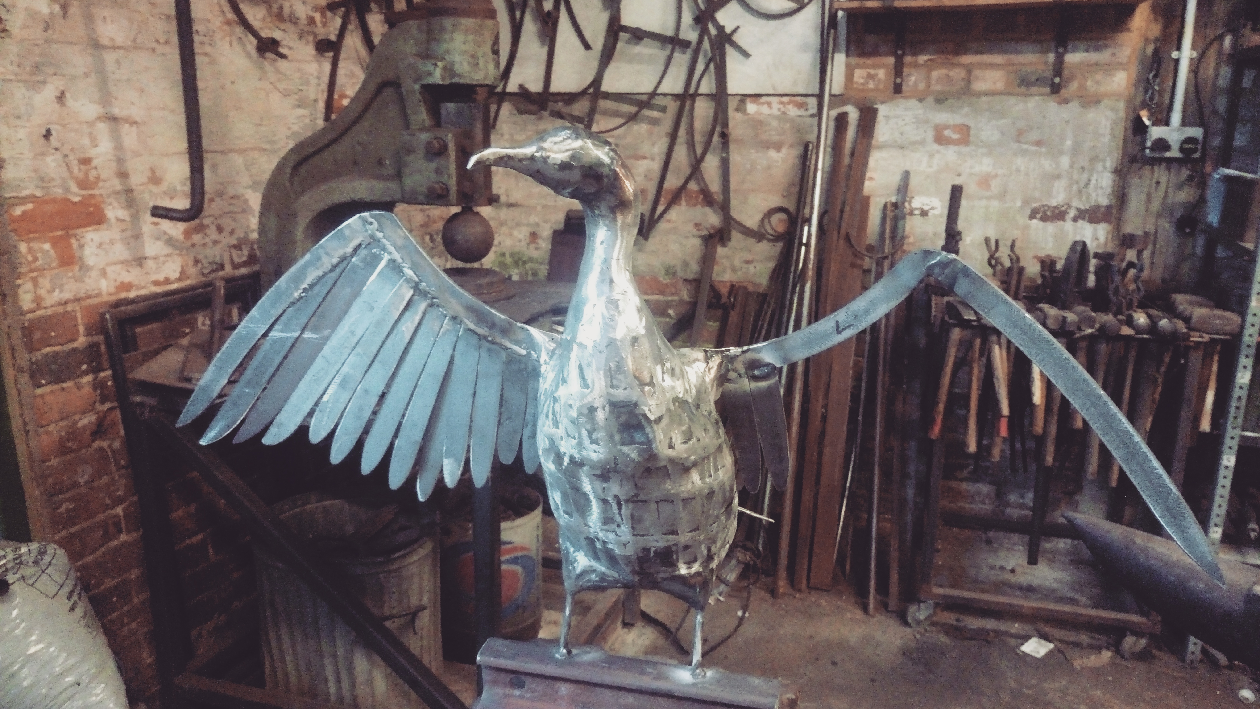

Joel OF Posted July 30, 2016 Share Posted July 30, 2016 I've 99% finished my 2nd sculpture commission, a spread wing cormorant. I drew up the outline shape with my client so I knew they'd be happy with the proportions & posture. (In the pic of the drawings is a sample piece I whipped up for them). It's head was always going to be turned but I'm not that good at drawing. They've seen it now & are very happy. They just want it to rust so no weatherproofing. The small section of light gauge railway it's on will be welded to a verical post of light gauge railway so it can be stood up in their garden. Quote Link to comment Share on other sites More sharing options...
Frosty Posted July 30, 2016 Share Posted July 30, 2016 Looking pretty good Joel, what do the customers think? Frosty The Lucky. Quote Link to comment Share on other sites More sharing options...
Joel OF Posted July 30, 2016 Author Share Posted July 30, 2016 She loves it. It's a wedding anniversary present to her husband - the Iron year. When drawing it up we joked that the front on view looked a bit like the Wallace and Gromit penguin & she was worried it could look a bit 3 Reich eagle like...but all those fears have completely gone now she's seen it. Quote Link to comment Share on other sites More sharing options...
Daswulf Posted July 30, 2016 Share Posted July 30, 2016 Awesome work Joel. Are the toes on the feet just weld beads? If so that worked out great. Quote Link to comment Share on other sites More sharing options...
Alan Evans Posted July 30, 2016 Share Posted July 30, 2016 Good fun. I trust you happened to notice how visually powerful and effective your armature is. You should definitely log that away for the future. Alan Quote Link to comment Share on other sites More sharing options...
Joel OF Posted July 30, 2016 Author Share Posted July 30, 2016 Cheers. No the feet were rods of 8mm (5/16th?) round bar which got kinda lost so I ran some weld beads over the top & it worked out well. A fluke I'm happy to take. Especially as it's all stick welded as i haven't yet got my MIG up and running so the whole job was a pain in the genitals. 2 hours ago, Alan Evans said: Good fun. I trust you happened to notice how visually powerful and effective your armature is. You should definitely log that away for the future. Alan By armature do you mean my sample piece? She wanted so keep that but I said no because I keep all my sample pieces for my "stock room" so that I can snare future clients by saying "it'll look like this..." I have been known to tactfully leave nice sample pieces positioned around the workshop so when clients come to collect commissions they spot them and their idea juices get flowing again... Quote Link to comment Share on other sites More sharing options...

zadvorney Posted October 6, 2016 Share Posted October 6, 2016 Super nice Joel. I like how it looks like its steel in the wings, the body transitions into life-like and the head and feet are life-like. Good stuff. Quote Link to comment Share on other sites More sharing options...
ausfire Posted October 9, 2016 Share Posted October 9, 2016 Spectacular! You have the proportions spot on for a cormorant hanging out to dry! Nice how you have lapped the feathers. I wondered why you didn't forge an eye, but on admiring the finished sculpture, I really don't think it needs eyes. The focus of attention is on the pose, and you have captured that so well. Quote Link to comment Share on other sites More sharing options...

Joel OF Posted October 19, 2016 Author Share Posted October 19, 2016 Thanks folks. On 09/10/2016 at 9:56 PM, ausfire said: I wondered why you didn't forge an eye Well funnily enough the plan had always been to make eyes, but the client came round just before that stage and said she didn't think it needed any. I had planned to drill into it's head and recess some small ball bearings which I'd then weld in and then drill countersunk dimples into for pupils. But all I ended up doing was lightly drilling small dimples into the head to suggest eyes (in the shiney pics), then I filled them back up with weld and ground back flush for the client as I showed her those pics and she preferred without eyes. Quote Link to comment Share on other sites More sharing options...
