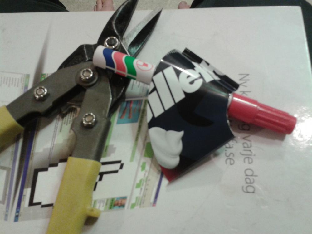

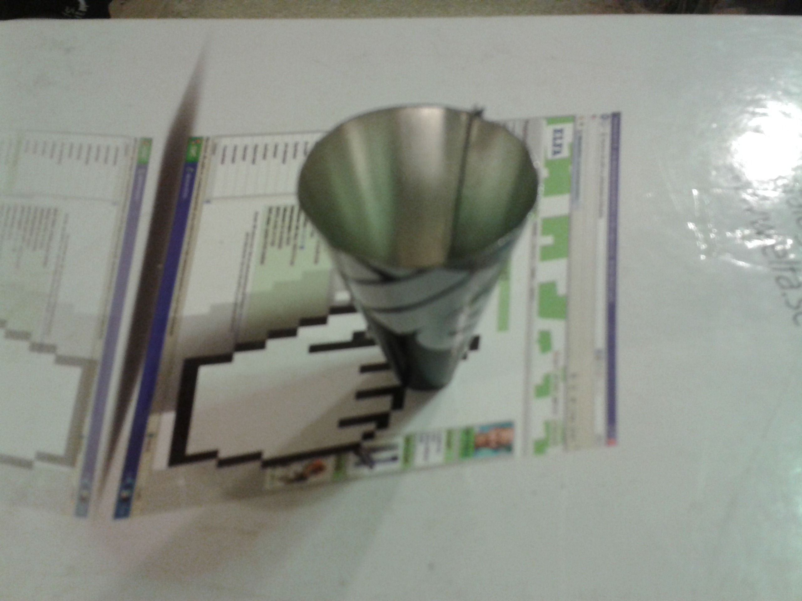

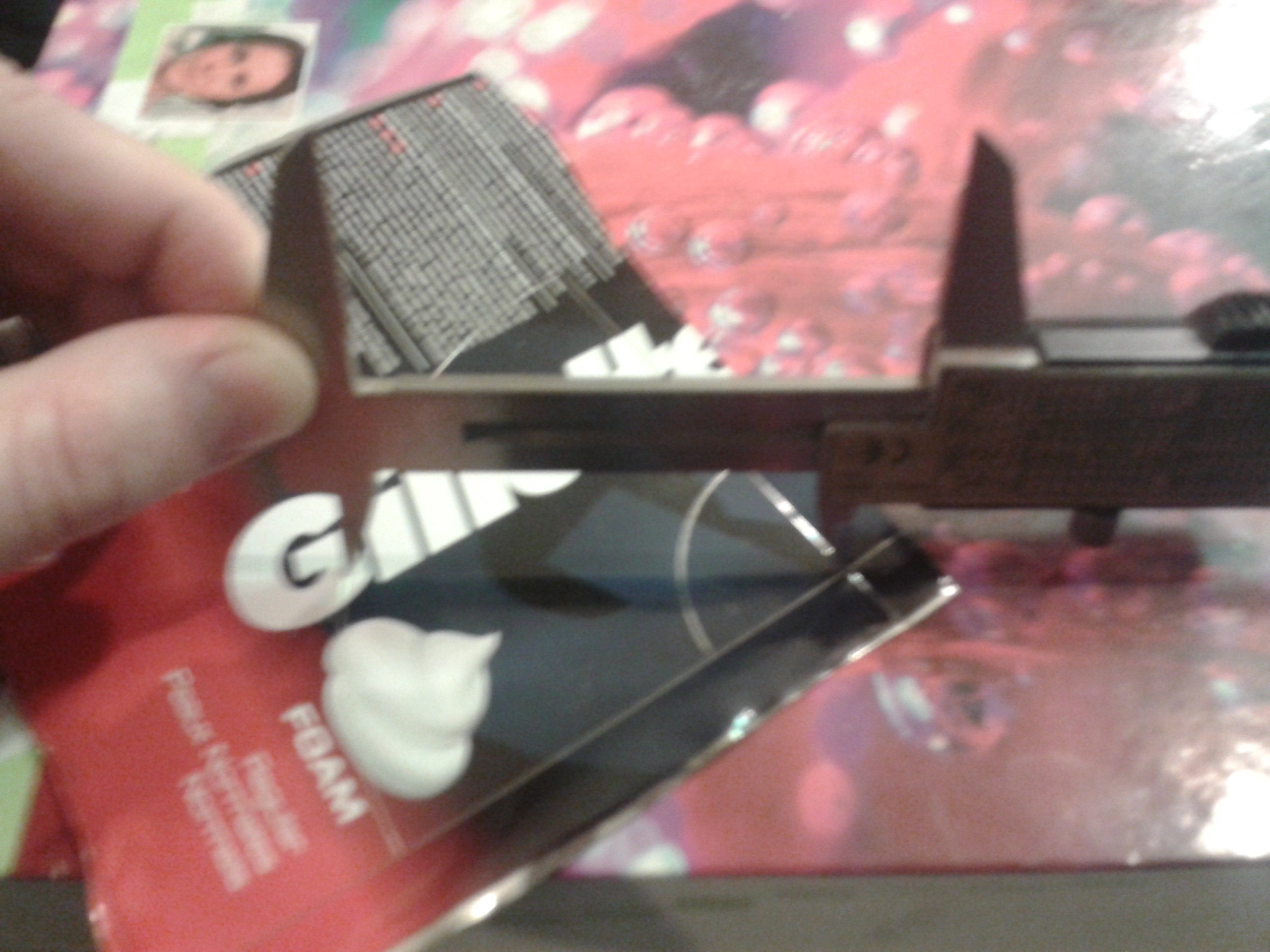

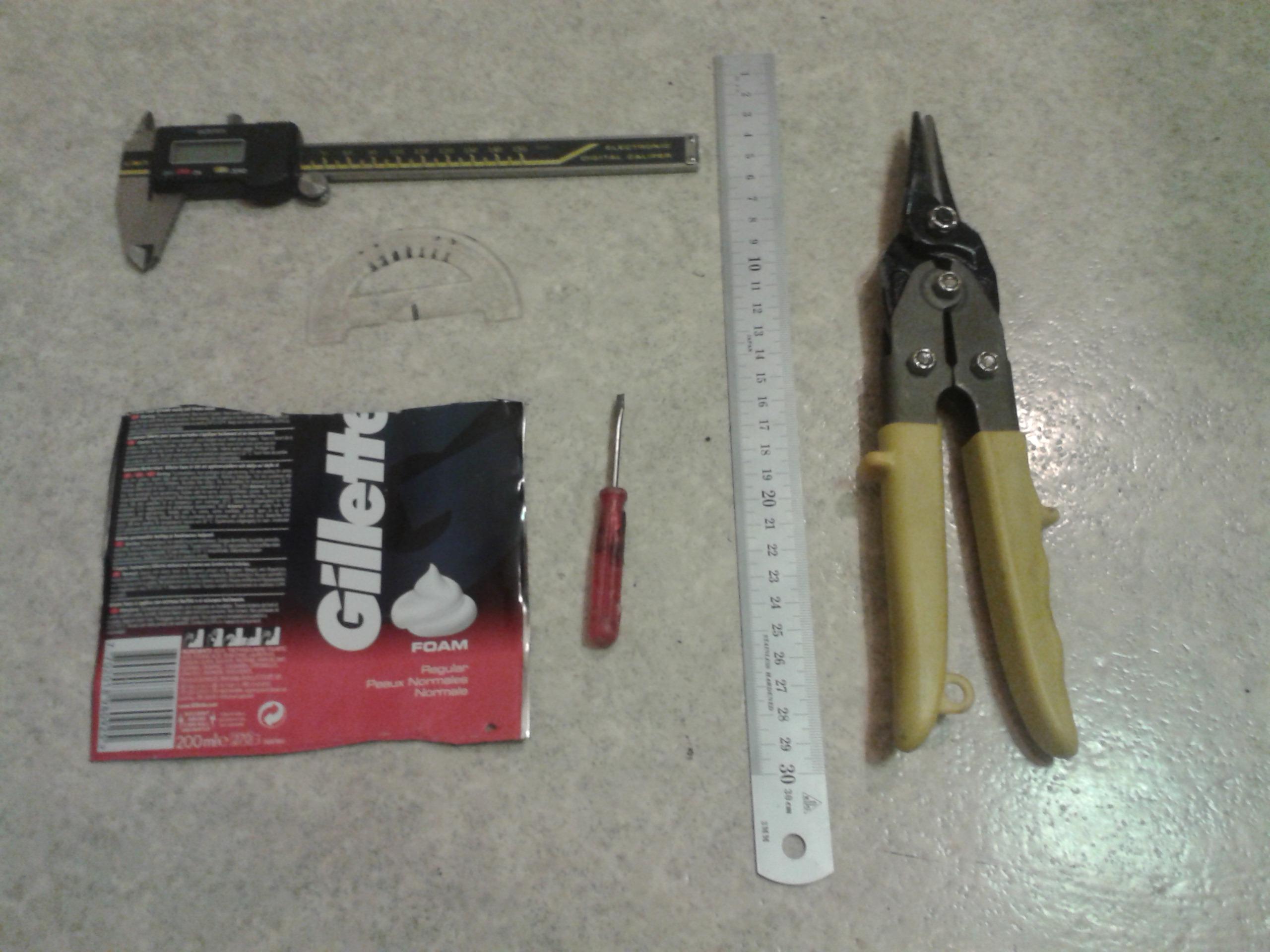

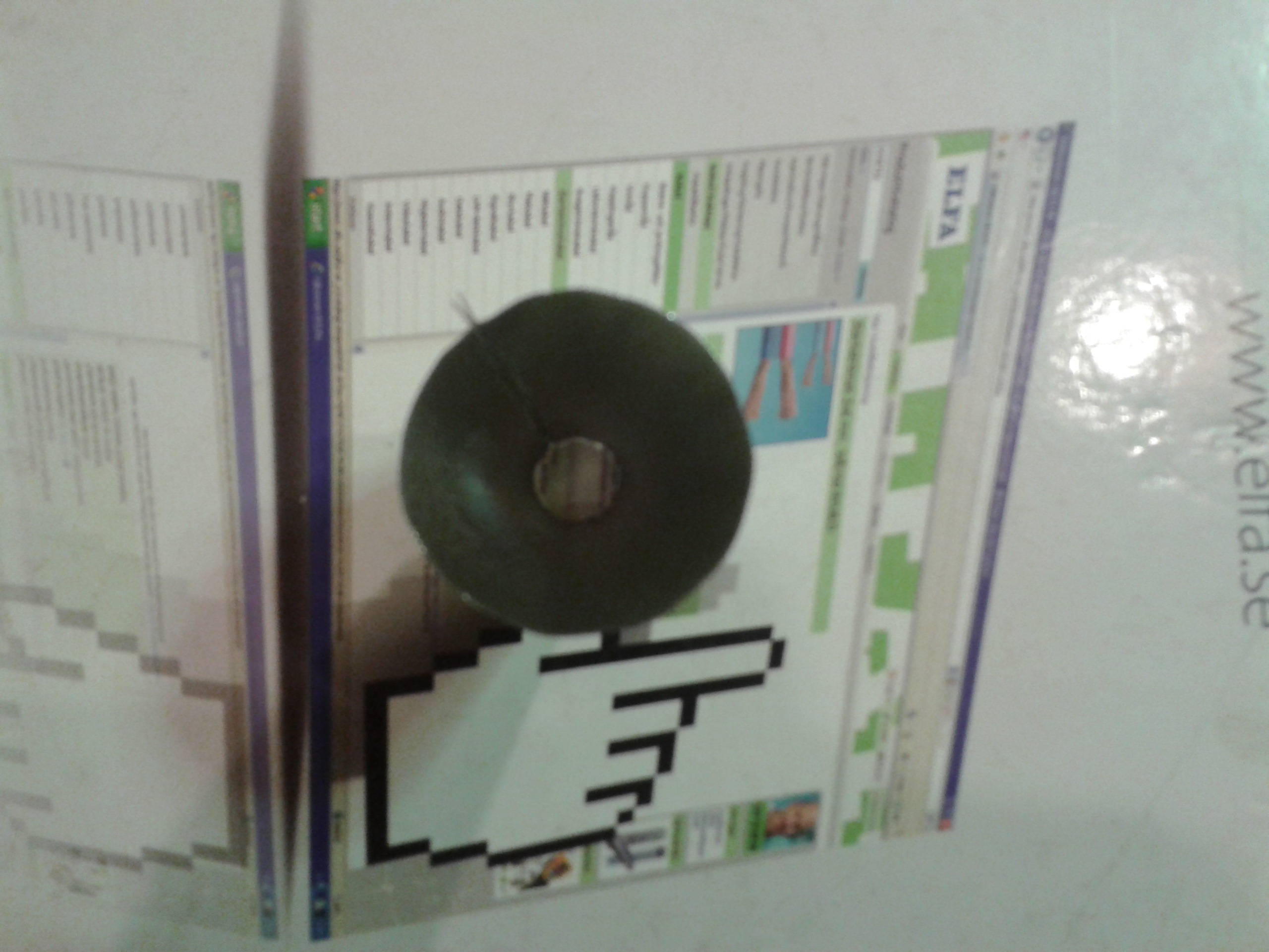

G-son Posted December 15, 2017 Share Posted December 15, 2017 Allright, here we go, a basic tutorial about making a cone from sheet metal. First, we need to know the dimensions. I have selected to make a small cone, 13mm (just over ½") small end diameter, 39mm large end diameter, and 52mm length. 1:3 small to large diameter, and 1:4 small end diameter to length ratio.(Do keep in mind, it is the inside dimensions you want correct in the end, if you use thicker material you need to compensate by adjusting the diameter you use for calculating. Hade I used 1mm thick sheet metal it would end up 12mm inside diameter and 14mm outside diameter in the small end, for example - i'd have to add 1mm to the diameters to get the right end result.) I simply googled "cone template calculator" and found http://craig-russell.co.uk/demos/cone_calculator/ In the first picture you can see how I have filled in the three measurments, and inside the red circle the calculator shows that the template should have an angle of 87.31 degrees, small radius 26,8mm and large radius 80,4mm. If you're smart you will make a reusable template of paper, stiff cardboard or something like that, and then transfer the outline to metal. In this guide, I'll just scribe the lines straight on the metal. Picture two shows the tools and material I'll use, the metal was cut out of an empty shaving foam can just because I had one available. About 0,15mm thick. Picture three shows the two straight lines scribed at as close to 87,31 degrees angle as I can - or rather, as close to 87 degrees as I can with the junk I've got available here. Picture four shows the two radius lines scribed using calipers. (If you are making a paper template, there are obviously better tools for drawing circles - but I don't know what they're called in english, and if you have them I probably don't need to tell you how to use them anyway.) In picture five the cone has been cut out. If you look closely, I have left about 4mm outside the two straight lines. In picture six I bend the excess into flanges that can be soldered/brazed to each other once the cone is completed. With thicker metal I would not make any flanges, instead I would cut the metal along the lines. Thicker metal can be welded/soldered/brazed edge to edge once the cone is completed, very thin metal can not - at least not with common DIY equipment. In picture seven the cone is carefully bent little by little around a permanent marker. Any sturdy round object with suitable diameter will work - the marker is too thick for the final stages, but worked excellent to begin with. If you use thicker metal you will probably want to use a rubber mallet or something similar to carefully "massage" the metal around a piece of round bar or tubing. Go slow, it is very easy to make sharp bends instead of a continuous round shape. It's better to make 20 passes end to end rolling it a little tighter each time, than to try to get it completely round in the first pass. In the last pictures you see the finished demonstration cone, ready for silver soldering the flanges - that I won't be doing now, burnt paint smells awful indoors. I just folded a small piece of scrap metal to hold the flanges steady together in the pictures. There you go, a very basic tutorial about how to make your own sheet metal cones, I hope it all makes sense. Sorry about the picture quality, but I think the idea is clear enough. There are many diffrent ways to do the metal work, use whatever suits you and your tools best. Once you have the template, the rest is just a matter of cutting and bending metal - and thanks to nerds there are plenty of easy ways to make the template. If you don't want to draw it yourself you can use the software available at https://www.conelayout.com/ to print it ready to use. Sorry, the pictures ended up in the wrong order and I'm not allowed to edit it. The last picture should have been first, and the first two last... Oh well. They're there at least. Quote Link to comment Share on other sites More sharing options...
