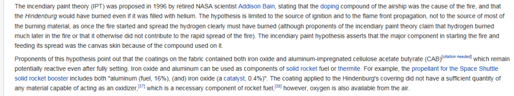

Very interesting information. That is actually one of the hypothesis regarding the Hindenburg disaster.
The theory has been going around for a couple decades but it's not born out be the evidence. The movie footage doesn't show anything in the spectra of a thermite reaction. The iron oxide and aluminum powder weren't mixed in a way nor in ratios to make thermite. Lastly the laquer the metal powders were mixed with couldn't have gotten hot enough to ignite thermite if it were present.
The Mythbusters went to pretty extreme measures, electric arc IIRC, to get a "thermite" reaction and it was very short lived. Pieces of the Hindenburg's skin is still laying on the field and they couldn't get a thermite reaction from it either.
