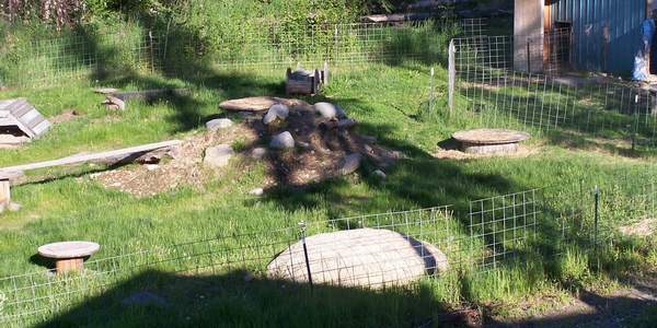

Certainly you may call me Jerry, thank you for asking. Yeah, you just never know when you'll stumble across an erratic. Slamming into it with the rented D6 made no visible impact on it, I don't think it jiggled a smidge, no visible effect at all. It's still sitting happy as the day the glacier dropped it where it came to rest. Deb dubbed it "goat rock" even though there is a buttress on a Mtn. peak too our east with that moniker.
I learned my lesson though, don't argue with BIG rock unless sufficient explosives are involved and go along with what Deb wants to name things. I have better pics of the thing but no idea where.
