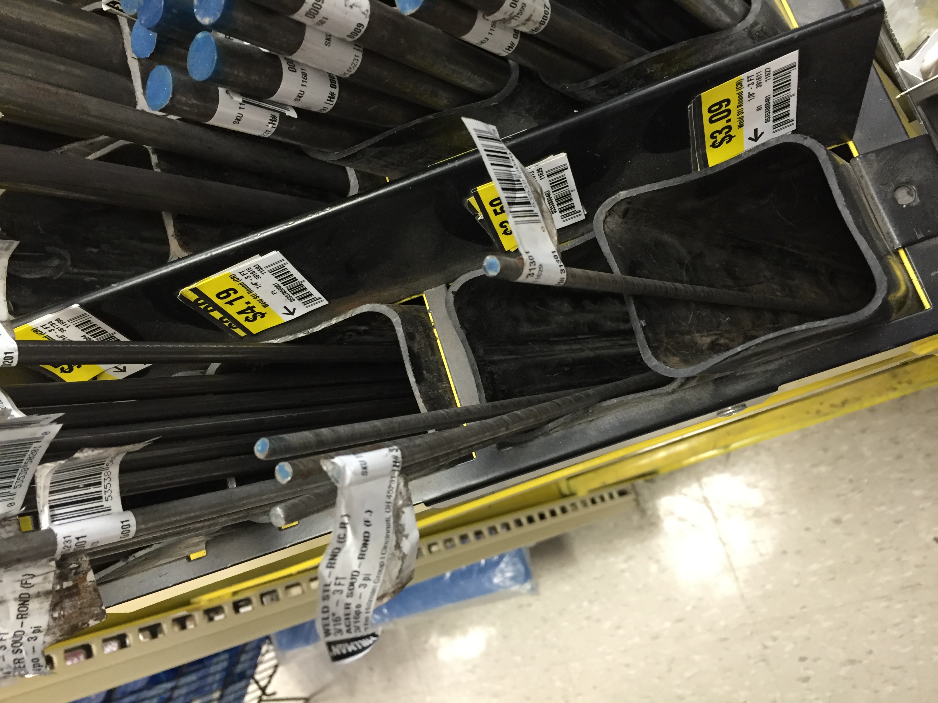

  1. I contacted the store the Sunday I was in emerg. They removed the metal later in the week after I had re contacted them again and they took it seriously. My shop is 12x30 and well ventilated. I have done the exact process many times and had just done it 2 weeks prior with same torches setup and exact same conditions but I used 1/4" round from my normal supplier without any issues. The only variant was the metal this time. I dont keep any cleaners in my bs shop all cleaners are at the house garage 100 or so feet away so there is no way for me to have contaminated it. I know about galvanized metal and fumes. The product was labeled weldsafe and says so right on it so I wasn't expecting to get poisoned from it. Not sure if it's readable but you can see they rack I got it from and in the other image the light brighter metal beside the snipe is it prior to me using it. What concerns me is how light it looks, normally the metal I use is blue grey.
  2. 2.5 Weeks ago I had an incident in my shop that I wasn't expecting. It was a Friday night and I was out and I had picked up some 3/16 "Weldable" round bar. I normally get all my metal from a metal supply place in town but because i didn't get there in time i picked some up at this other store for small project i was going to do for a client. (On, Canada) I got home around 8pm and started to work with metal, It was small stock so i just used the torches to heat up, I did the first rough pretty quick then moved onto the second one. at about 8:30 i began to feel super dizzy, slower than normal and i noticed that my breath was short and now coughing. I shut down for the night and turned the fan off and closed the window which i had opened. By 10ish i was eating freezes i had in the fridge one after another because my throat burned and the coughing was intense by this time. I stupidly went to bed instead of the hospital because i thought maybe i just got some dust in my airways. Saturday i was in bed and Sunday morning i went to emerg as it was so bad it hurt t breath and swallow. At emerg my xrays showed inflammation and poison control got called as they believed i may had inhaled phosgene gas created from the heat of the torch and a possible cleaning chem that was on the metal. Pumped with steroids and puffers i was sent home because i had made it alive past the 12hr danger window. I don't keep any cleaners or paints in my metal shop and believe that possibly someone at the store was cleaning the rack and overshot onto the metal. Ammonia or chlorine based cleaner. 2.5 weeks later and i am finally moving around and feeling a bit better. It was the worst nauseousness i have ever had in my life and it lasted the full 2 and a half weeks every min of the day. After doing some research and learning how lethal this scenario was and how lucky i was to have only inhaled enough to make me severely sick and not dead. 500ppm can kill a man instantly so learn from my lesson and be safe guys. I have a question maybe some of you can help solve 1) We are trying to find out if this was a metal issue or a topcoat chemical. I have attached a photo and you can really see the redness in the metal as well as what looks like silver and black and orange on the new snipe hinges dots here and there on the 2 snipe hinges i was making. Obviously the old one is the original i was re creating. I have made these before and not had the metal ever go red like that before nor had ever seen that happen. Does anyone know what would make the metal go red? I was to eliminate anything else as the culprit before taking legal action. I know you guys work lots with metal so i am trying to pick your brains. 2) What is a good way to clean my equipment to make sure its not contaminated too?
