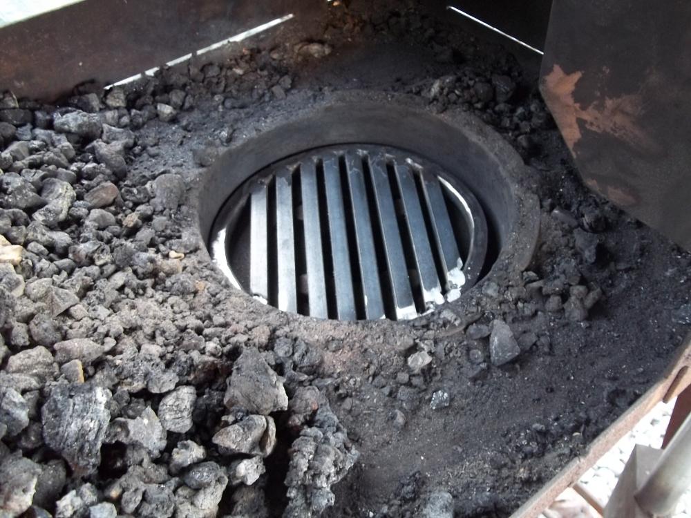

Curtis87 Posted November 8, 2015 Author Share Posted November 8, 2015 So I got this old brake from the scrapyard for $3. As is, the pot is 2 1/2" deep , roughly 7 inches in diameter and the centre hole is 2 1/2" in diameter. I bought some furnace cement to build it into a cone shape, but what I need to know is if I should make it a bit deeper. Also I need some advice on working with the large centre hole. The real trick here is that I don't own a welder. So I'm trying to affix a smaller pipe into that hole somehow. As usual, I appreciate any and all advice and constructive criticism, thanks in advance. Curtis Quote Link to comment Share on other sites More sharing options...
jacob's hammer Posted November 8, 2015 Share Posted November 8, 2015 they make flanges for 2" pipe that fit hole on fairly well. i put bolts with big washers in flange to 'clamp' drum to the flange. Quote Link to comment Share on other sites More sharing options...
arkie Posted November 8, 2015 Share Posted November 8, 2015 As Jacob mentioned, you don't need to weld the flange. Here is a pic of my early brake drum arrangement. The drum had 5 holes, the floor flange underneath had 4 holes. I had 2" black pipe coming up for the air supply which was threaded into the floor flange under the drum. I used one pair of holes in the drum and flange and drilled three additional holes in the drum to match the flange holes. In the photo you can see the original drum holes. The flange underneath covers the original drum holes. Bolted the flange to the drum...works fine. Nice thing is that the drum is removable/replacable in case it ever cracks or breaks, and if a replacement is a different diameter, then the table hole can be modified. BTW, the welded rods over the hole didn't last a month. I made a 1/2" steel grate to replace them and just plopped it over the large hole. Quote Link to comment Share on other sites More sharing options...
Curtis87 Posted November 8, 2015 Author Share Posted November 8, 2015 I'm back to square one, everything is cleaned out of the large brake drum and I was lucky that the smaller one fit right in there with out any more grinding. Right now the depth from my little table to the bottom of the pot is 4 3/4". Is that deep enough/ too deep for coal? Also, would it be better to do a side best set up here? Quote Link to comment Share on other sites More sharing options...
ThomasPowers Posted November 9, 2015 Share Posted November 9, 2015 A little sheet metal fence could make that much deeper with little effort or cost. As it's rigged for a bottom blast why go to the effort to convert it to a side blast? Quote Link to comment Share on other sites More sharing options...

Curtis87 Posted November 13, 2015 Author Share Posted November 13, 2015 On November 8, 2015 at 12:21:14 AM, arkie said: As Jacob mentioned, you don't need to weld the flange. Here is a pic of my early brake drum arrangement. The drum had 5 holes, the floor flange underneath had 4 holes. I had 2" black pipe coming up for the air supply which was threaded into the floor flange under the drum. I used one pair of holes in the drum and flange and drilled three additional holes in the drum to match the flange holes. In the photo you can see the original drum holes. The flange underneath covers the original drum holes. Bolted the flange to the drum...works fine. Nice thing is that the drum is removable/replacable in case it ever cracks or breaks, and if a replacement is a different diameter, then the table hole can be modified. BTW, the welded rods over the hole didn't last a month. I made a 1/2" steel grate to replace them and just plopped it over the large hole. Do you have any pictures of the 1/2" grate you used? That is my next step before I can cement everything. Quote Link to comment Share on other sites More sharing options...
arkie Posted November 13, 2015 Share Posted November 13, 2015 Here is the welded grate. Don't weld it to the drum, the weight will keep it in place. Quote Link to comment Share on other sites More sharing options...
Curtis87 Posted November 13, 2015 Author Share Posted November 13, 2015 Pretty clever, I think I'll try it out. At least, this way, I can apply my cement beforehand. Once that's done, all that's left is to make some kind of chimney. Quote Link to comment Share on other sites More sharing options...
