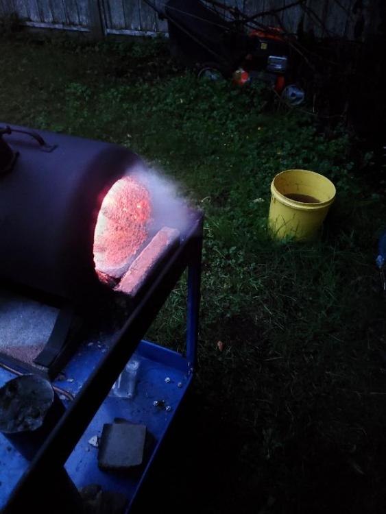

  2. So after running it this evening I discovered that I rushed by taking them earlier in the day(even though it was dark-ish), way more detail in the dark. Video: https://youtu.be/A1ufvkVw070 after startup exhaust after start After heat up Exhaust after heat up

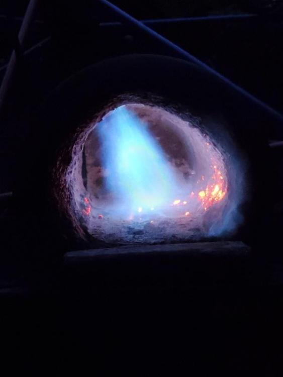

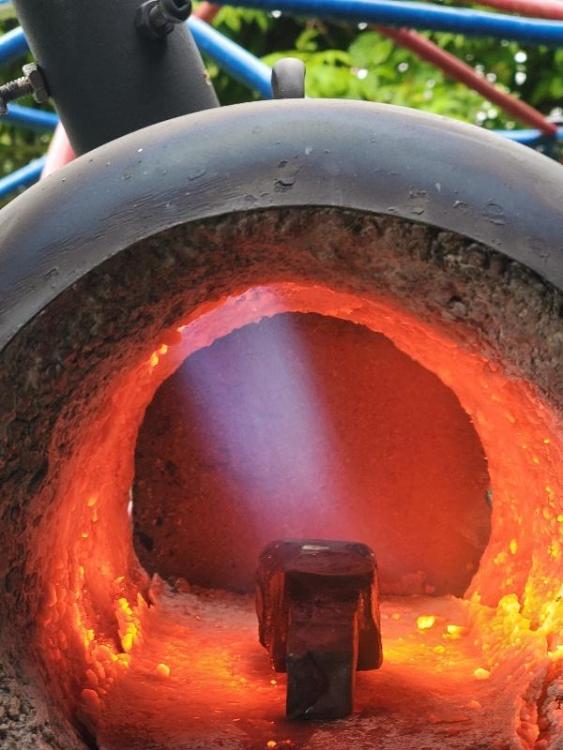

  3. Hi Frosty, Thank you so much for your reply, it was a big help. I moved the burner outlet as recommended, it's about 1/2"-ish into the blanket. I don't know if it was due to that adjustment or if it was because today was relatively breeze free at my place for a change but it started up with only a small sputter that lasted 3-4 seconds then no issues after that. I took a short video of the flame just after flashup https://youtu.be/pwdgGqOQlo4 . Also, here are some pictures of my setup(1st pic), flame on startup(2nd & 3rd), flame after heat up(4th & 5th), and as best a picture that I can get at present of the dragon's breath(6th):
