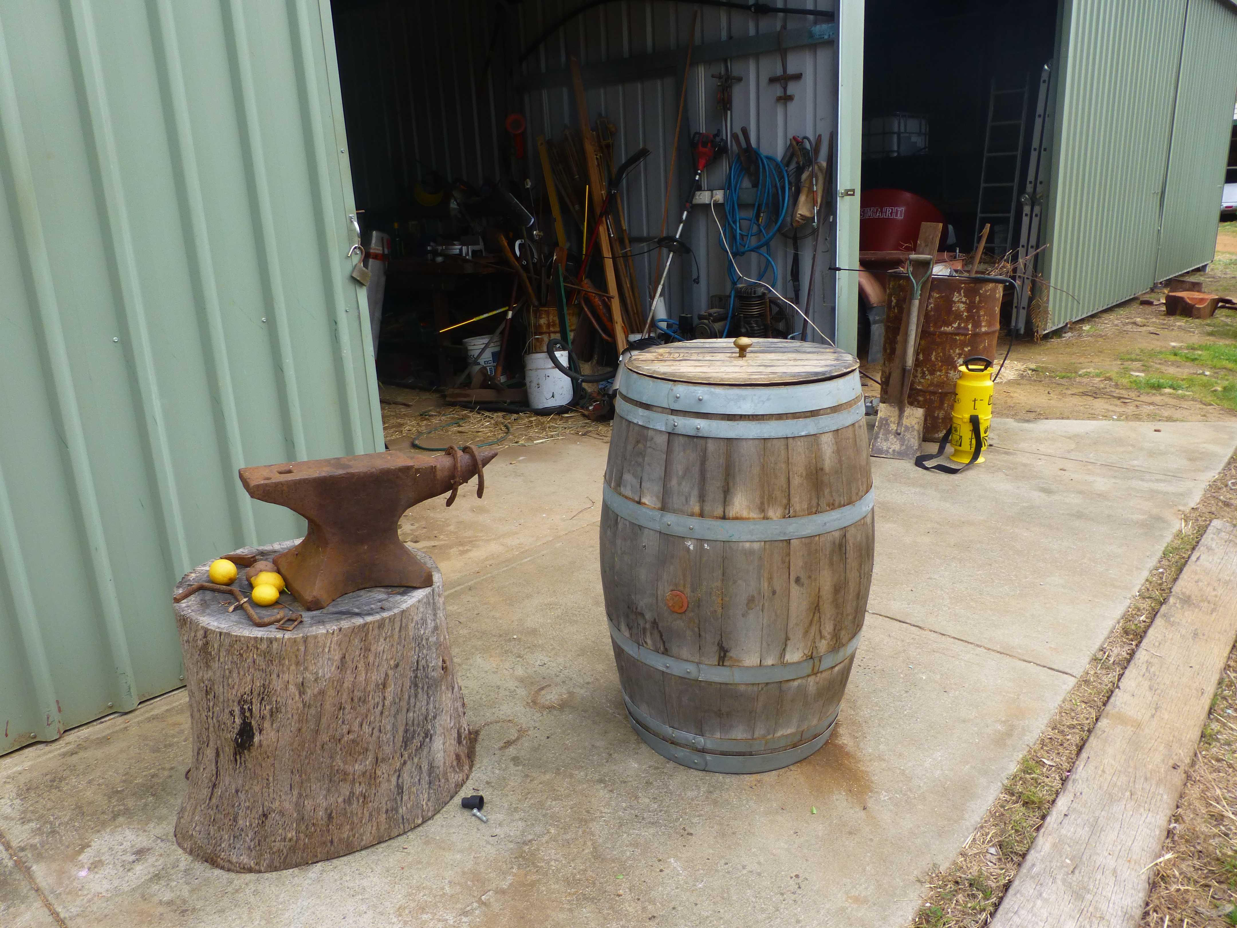

Heelerau Posted September 27, 2015 Share Posted September 27, 2015 Gents, finally got around to sorting out a proper quenching drum. I knocked the head our of an old 55 gal wine oak wine barrel, used the timbers from the head to make a lid. The barrel has nice galvanised hoops so won't rust in a hurry. It took up nicely and does not even seep. The good thing about a barrel is it won't rust and will probably see me out. We had the same thing in the blacksmith shop on the sheep station that I grew up on. Cheers Heelerau Quote Link to comment Share on other sites More sharing options...

Frosty Posted September 27, 2015 Share Posted September 27, 2015 It's almost too pretty for a blacksmith shop, don't let the wife see it! One feature I really like about it is it's height, it's high enough it's far less likely hot high Carbon pieces will fall into it accidentaly. Of course the lid doesn't hurt.Nice piece of kit.Frosty The Lucky. Quote Link to comment Share on other sites More sharing options...
Bob S Posted September 27, 2015 Share Posted September 27, 2015 looks like a long reach to the bottom if you have to fish something out... Quote Link to comment Share on other sites More sharing options...
Alan Evans Posted September 27, 2015 Share Posted September 27, 2015 A mesh tray with a couple of uprights or a hoop over handle will lift any small things out that get dropped in...Alan Quote Link to comment Share on other sites More sharing options...
DSW Posted September 27, 2015 Share Posted September 27, 2015 It might pay to put some sort of bung/valve in the side near the bottom so it can be drained easily. I've done this on several quench barrels the schools have used to cool coupons. Over time you'll get a build up of scale, slag, grit and pieces of metal in the bottom that needs to be cleaned out periodically. at 8 lbs to the gallon, that's a lot of weight to try and tip over to dump, not to mention many times those barrels aren't all that stable once you take the head off. I've seen plenty collapse when people tried to dump them out. Quote Link to comment Share on other sites More sharing options...
Heelerau Posted September 27, 2015 Author Share Posted September 27, 2015 Gentlemen, thanks for the interest and advice, the mesh is a good idea, and I can knock the bung out in the mid section to drain enough out to shift it to clean it out on occasion. It was one of the War Offices barrels, from out stoop, I did mollify her by saying I can always drain it and tip it up if we need it for a party. We can get them pretty cheap, for about $50 from a local place. Cheers Heelerau Quote Link to comment Share on other sites More sharing options...
SmoothBore Posted September 27, 2015 Share Posted September 27, 2015 looks like a long reach to the bottom if you have to fish something out...Magnet on a stick ..... . Quote Link to comment Share on other sites More sharing options...
Frosty Posted September 27, 2015 Share Posted September 27, 2015 I made an expanded metal screen on long handles for my old 15gl. quench barrel. Then I forgot to empty it one winter and freezing split the bottom.Frosty The Lucky. Quote Link to comment Share on other sites More sharing options...
Alan Evans Posted September 27, 2015 Share Posted September 27, 2015 Magnet on a stick ..... .Do you have one for copper and stainless? Alan Quote Link to comment Share on other sites More sharing options...
SmoothBore Posted September 27, 2015 Share Posted September 27, 2015 Do you have one for copper and stainless? AlanDo you quench a lot of Copper & Stainless ? . Quote Link to comment Share on other sites More sharing options...
Alan Evans Posted September 27, 2015 Share Posted September 27, 2015 Do you quench a lot of Copper & Stainless ? .Yes of course, don't you?….With 316 stainless especially if wanting to drill or machine afterward. Copper I also quench to maximise softness when annealing and then sometimes to get the colours for patination.All metals I chuck in the tub when they get too hot to hold, usually I manage to hold on to the coldest end and cool my forearm as well. Sometimes I let go!Alan Quote Link to comment Share on other sites More sharing options...
