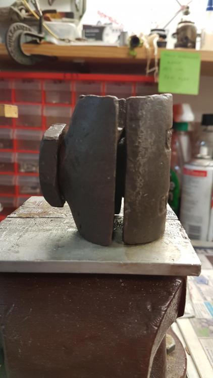

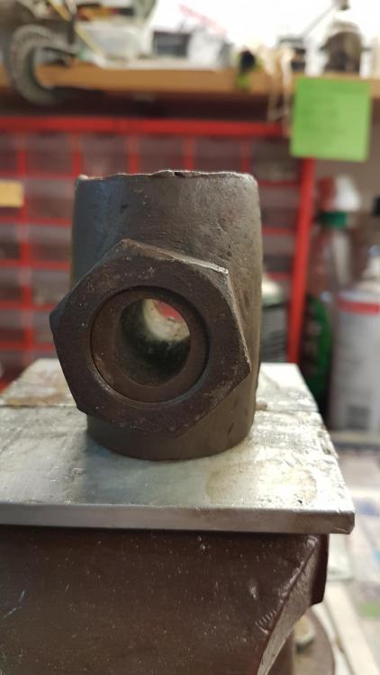

ausfire Posted June 13, 2014 Share Posted June 13, 2014 This is a strange looking mallet I picked up at a swap meet. For $5 it seemed like a good buy and I have tested it on the bending of a ram's head and it works just fine.I use a lead hammer for the same job, but it's getting very battered and I was glad to come across this one. No-one on the stall knew what it was and I'm not sure it is intended for blacksmith use. However, it works well. The hide is very tightly wound and is held firm by the large nut.Do you figure it is a homemade piece or what? It is marked with GREG STEEL, or that's what it looks like. Anyone seen anything similar? Link to comment Share on other sites More sharing options...

Judson Yaggy Posted June 13, 2014 Share Posted June 13, 2014 I was first introduced to these for driving timber framing chisels, they don't damage wooden handles and ferrules as badly as a steel hammer. Also good for straightening twists or anything else you don't want marred. Mine's made by the Garland Co. of Saco, Maine, USA, parts and interchangeable heads are still available. Link to comment Share on other sites More sharing options...

Stash Posted June 13, 2014 Share Posted June 13, 2014 I have the Garland make, also. There was a choice of sizes available at my local mason supply store. Before I put on the forging side of the shop I used it for wet-set flagstone work. Sort of a pre- deadblow hammer. Old rubber mallets have a tendency to whack me in the forehead, the rawhide didn't. I have a rubber deadblow for stonework now. If you note, the bottom of the head is a big threaded nut, holding the 2 sides together. That's how you can switch out the rawhide when used up, or you can pop in lead, brass, wood. Replacements are still around. Link to comment Share on other sites More sharing options...

Mark F Posted October 30, 2019 Share Posted October 30, 2019 I picked up a Greg Steel mallet last Sunday. It had a handle, in not particularly good nick, that I have removed to clean up the head. It's a brand that I have not heard of before and this type of mallet is not very common in Australia which is why I grabbed this one. I see that the original posters photos are not available which is a pity as I would have like to see another example. If you're still around ausfire any chance of reposting some pics??? Link to comment Share on other sites More sharing options...
ausfire Posted November 2, 2019 Author Share Posted November 2, 2019 Mark, thanks for your PM alerting me to your response to this old thread. Yes, I am still around, and I did manage to dig out a couple of pics of the Greg Steel hide hammer from the file. I don't use it anymore, as it was difficult to find replacement hide parts, and the cost of a new one on line was quite reasonable, so I bought one. They are a handy thing and I use mine daily for bending heads on rams and bulls without marking the metal. How are things in Perth? I'm just watching the WBBL cricket on TV with the Perth Scorchers doing it tough against the Melbourne Stars. Anyway, here are the pics I found: Link to comment Share on other sites More sharing options...
Mark F Posted November 2, 2019 Share Posted November 2, 2019 (edited) Thanks for the pics ausfire. Mine measures 1.5" across the head openings. There is a guy selling pairs of Thor 1.5" hide replacement heads on ebay for $23.80 with free postage so I've ordered a couple of them. Hopefully they will fit o.k. Here is a link if you are interested. [Commercial link removed] Perth has had a return to winter over the last few days after being 36 degrees last Sunday! Strange stuff indeed. Just watching the end of the rugby with England being defeated which no one predicted. Edited November 2, 2019 by Mod34 Commercial link removed per TOS Link to comment Share on other sites More sharing options...

JHCC Posted November 2, 2019 Share Posted November 2, 2019 Welcome to IFI, Mark F! If you haven't yet, please READ THIS FIRST!!! In the US, these are made by a company called Garland in Saco, Maine. Here's mine, a #2: I got this from my favorite industrial surplus place in a box with some files, wire brushes, screwdrivers. $10 for the lot. Replacement heads are about $20/pair, but I haven't had the need to get any yet. 1 hour ago, DuEulear said: If you ever want rawhide for cheap just buy a rawhide dog chew and soak it so you can un tie it. Then you can unroll it flatten it out and use it for well.... rawhide Excellent tip. I just saw some enormous dog chews in the store yesterday and was vaguely thinking that might be a possibility. Link to comment Share on other sites More sharing options...
