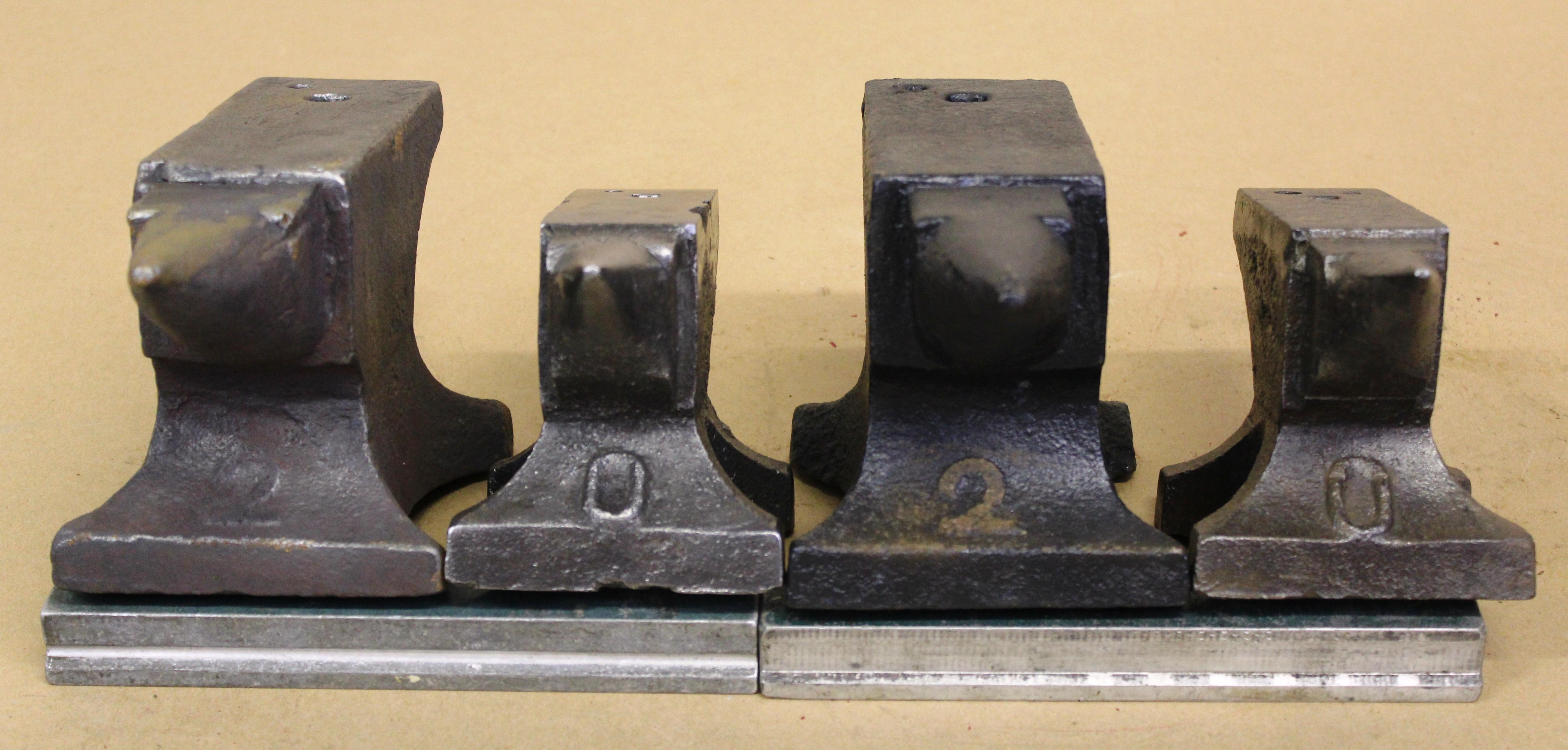

njanvilman Posted January 1, 2020 Author Share Posted January 1, 2020 Happy 2020 to everyone out there in Anvil Land. A few old Fish to mark the new year from the Fisher & Norris Factory Museum. Quote Link to comment Share on other sites More sharing options...

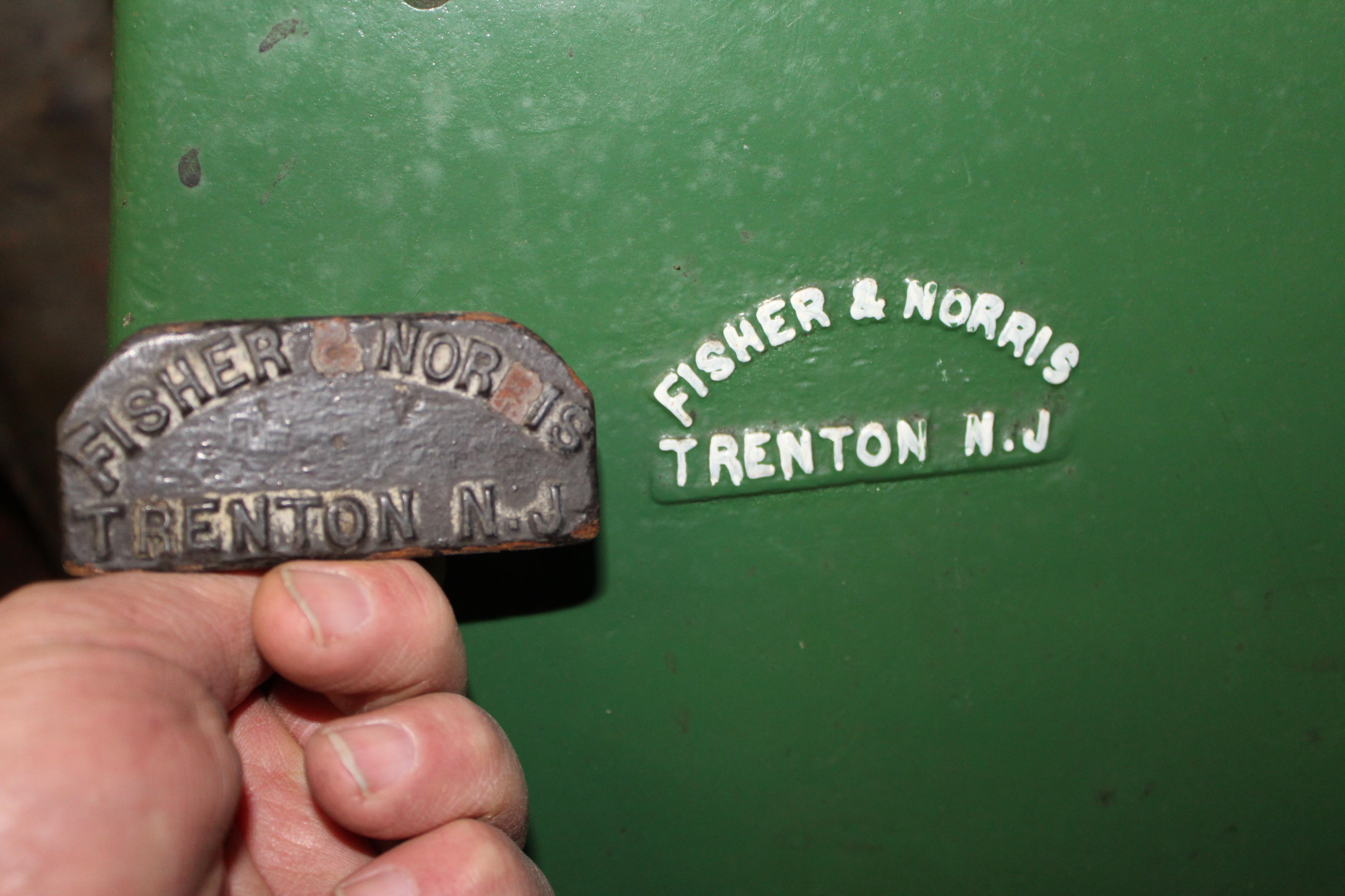

njanvilman Posted January 10, 2020 Author Share Posted January 10, 2020 I put this stamp away for safekeeping about 10 years ago, then forgot where. I just found it. Just in time to get into the book. Missing a few letters, but mostly there. This was used to imprint the molding sand to get the name onto Fisher anvil stands. Quote Link to comment Share on other sites More sharing options...
