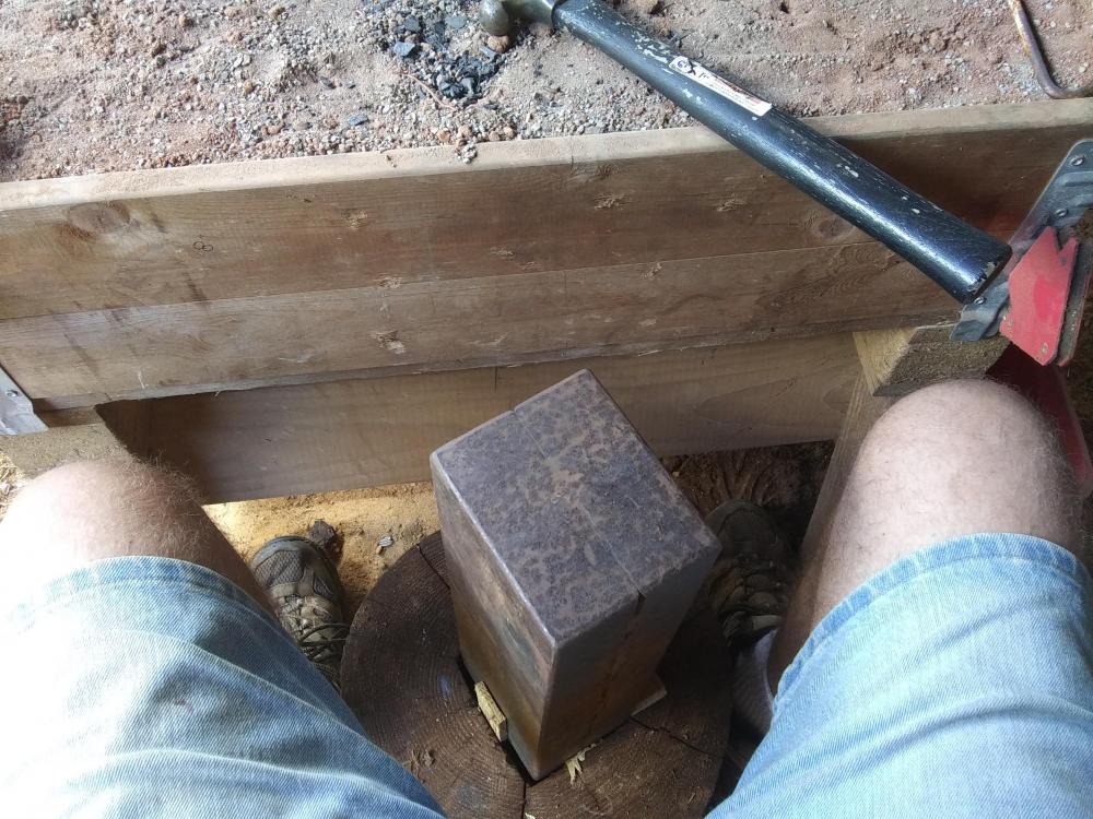

I am in a wheelchair and just starting out with designing my forge and anvil and this is very tough, I am limited to my family garage rn and have an area I use for gun cleaning for my business but I am trying to figure out how to do all this blacksmithing without burning the house down and doing all my work within arms reach. If I have to go from one side of the garage to the other while carrying something hot in my hand it is difficult to do that, not burn my legs and move at the same time
Even able bodied Smiths would be fools to carry hot stock across the shop. First consider a post anvil that will put the work at about lap high and just to the outside of your dominant side leg, this puts the striking serface close to the same position able bodied smiths work with. So with your off hand across your body holding tongs and stock or handled tooling and hammer.
place the forge in front of you, normally we want the forge at the same hight as the anvil so one doesn’t lift stock between the two and the anvil/hearth can support long stock. With tongs you can reach the fire with your knees against the hearth.
place your vice belly button high and to the off side so you can pivot to the off side wile the stock heats.
a welders blanket or a cut down cotton pad with leather top layer in your lap with a welders apron protecting your chest and as primary protection of your lap and legs should get you doing most hand forging.
As to slacktubs, they are not used much with modern steel except in heat treating, and as heat treating can involve oil or water one must make provisions, my first thought would be to place both under the hearth but maybe under the vice with lids is best.
Obviously one would remove the arm rest on the dominant side on those heavy grey and crome  hospital chairs.
Obviously I am not setting in a wheel chair, but it'll give you an idea. One can go 6-8” lower to get into the normal knuckle high position but that puts the anvil just forward of your knee. Still not a bad position if the forge is small. Tho a gasser will suck do to draggons breath roasting your legs

I would stick with soft coal as a fuel, a lot less heat and fire fleas radiated at you, I assumed total paralysis and lack of sensation in ones legs in my over abundance of leg protection, hot scale would be bad enough but dropping a small work piece in ones lap at temp is a real danger.
Apart from following Charles's recommendation for lap protection, we do not recommend following his example for forge-ready footwear.
