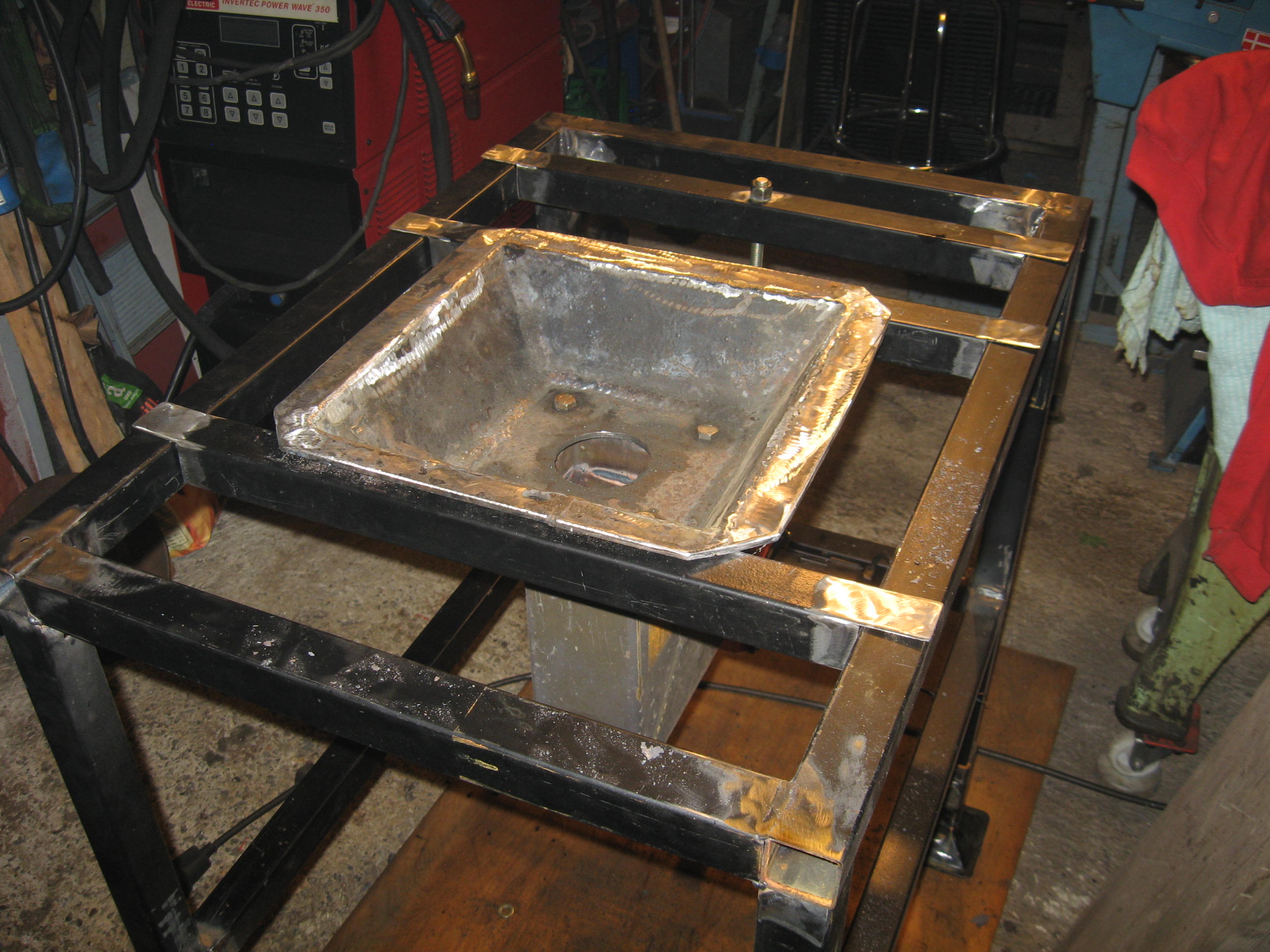

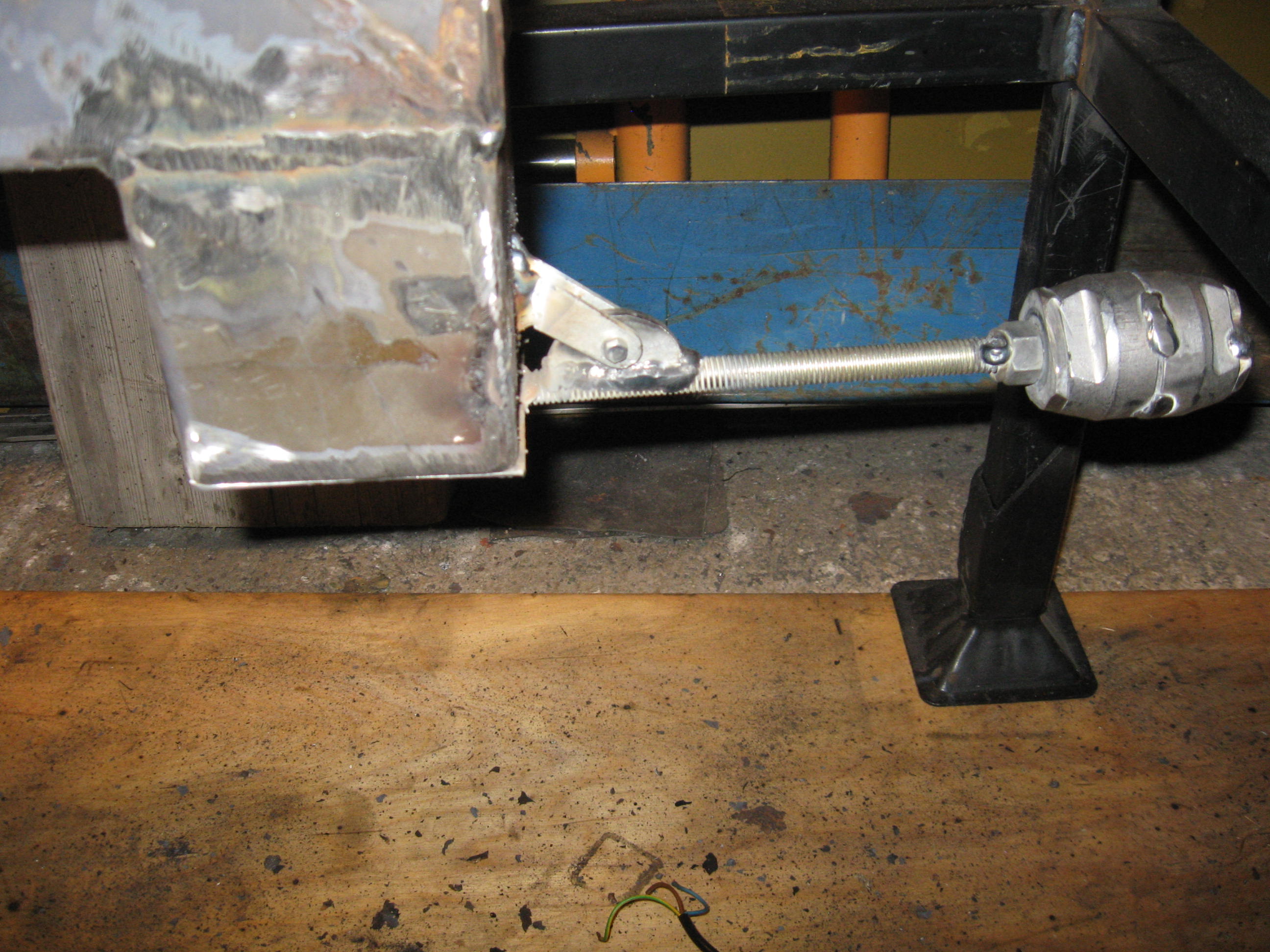

Zeroclick Posted September 18, 2017 Share Posted September 18, 2017 This is my forge have been running it for nearly a year and had no problems with it. I have added a dimmer switch to help with airflow control and works perfectly. Thanks, Luke Quote Link to comment Share on other sites More sharing options...
Morten Posted September 27, 2017 Share Posted September 27, 2017 Building a forge Quote Link to comment Share on other sites More sharing options...
Frosty Posted September 27, 2017 Share Posted September 27, 2017 Please can you clarify? There is too much air getting to your steel. This is a problem with this type forge unless you have wood heaped several times deeper than you do. Frosty The Lucky. Quote Link to comment Share on other sites More sharing options...

Jonnytait Posted October 3, 2017 Share Posted October 3, 2017 Finished building my solid fuel forge afew weeks ago, thought I would show a photo of it. Using coke, works just fine so far Forgot to say, the original fire pot I built for the forge was a little shallow, you can see it down to the left of the forge. Welded up a deeper one which works better Quote Link to comment Share on other sites More sharing options...
Kevin Olson Posted October 4, 2017 Share Posted October 4, 2017 Whats that outcroping in the center rear of the forge. I love the block walls in your shop. What kind of building is it. Garage, warehouse etc. Quote Link to comment Share on other sites More sharing options...

Jonnytait Posted October 5, 2017 Share Posted October 5, 2017 On 10/4/2017 at 1:51 PM, Kevin Olson said: Whats that outcroping in the center rear of the forge. I love the block walls in your shop. What kind of building is it. Garage, warehouse etc. Thanks, if you look below the forge you can see that blocks stick out of the wall at that point, from the ground up to the hatch, so I had to build that stainless heat shield at the back of the forge around them. Im not really sure why the wall is designed like that , its not like that on the opposide side of the building. Must be something to do with the hatch. The man that built the shed put the hatch there as he used that part of the shed for storing peat. He would back a truck up to the hatch when the shed was getting full and start filling it from there instead. More recently my sister used it as a stable for her horse as you can see by the stable door, up until a few years ago. Now I use it as my shop Quote Link to comment Share on other sites More sharing options...

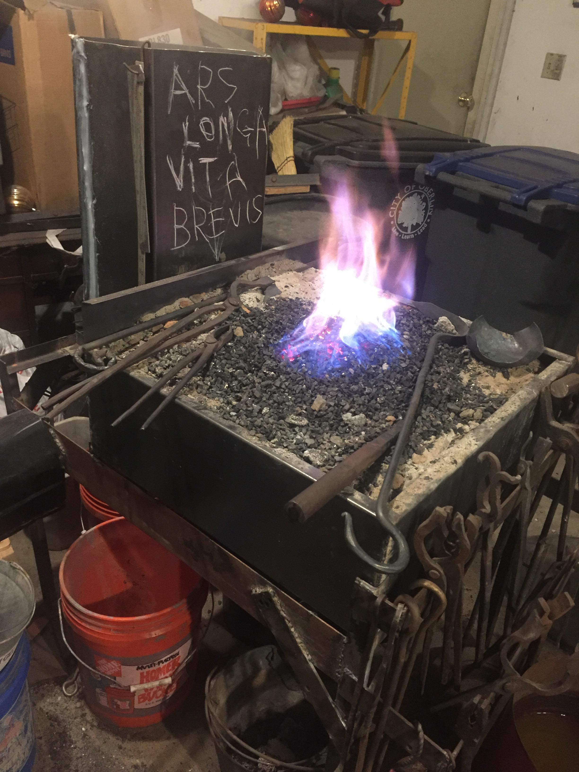

lyuv Posted October 6, 2017 Share Posted October 6, 2017 Well, this is mine. Side blast. Made of loosely piled fire bricks, so I can change and improve the design. The table has fire bricks top, so in effect, it's also part of the forge. The rear of the "trough" (covered by 2 bricks) is the coal reservoir. Must say I"m not pleased with side blast. Bottom would have been better. I might change the arangement when I get off by butt and fabricate a propper horizonal-to-vertical tuyere and grate. Quote Link to comment Share on other sites More sharing options...
Charles R. Stevens Posted October 6, 2017 Share Posted October 6, 2017 It's not the side blast, it's the design. If you realy need a long fire ad another tuyere, other wise for general forging, either push the bricks in to form a 4" deap, 4" wide and 8" long trench with either one or two 4-6" walls to pile the fuel against. Not. Slag from coal will stick like glue to brick, classically a large box (8" deep or so) was built and filled with ash and clinker, a bowl was then dug out each morning with the aid of a sprinkle of water and a fire built with yeastedays breeze. Bottom blasts are not as easy to reconfigure and the slag blocks the air supply insted if pooling below it, and they are not as easy to switch from coal to charcoal and back. So looking at your set up, add another brick to each end and 6 bricked to each side and tighten up your set up. Pile the coal 8" above the tuyere. The other option is to form a 8" square, 6" deep, tuyer even with the top of the first layer of brick, this will keep the slag and most of the heat away from the brick (melt hard fire brick in my box of dirt) now mound coal up about 4" above that. So from bottom of fire bowl you are a full 12" top of the fuel, the hot spot being 6" from the bottom of the bowl. Adjust the air to get the hotspot at the rifpght spot, to little, to low, to much, to high. You should have a 6" working hot spot now. Quote Link to comment Share on other sites More sharing options...
ThomasPowers Posted October 6, 2017 Share Posted October 6, 2017 Yes that design is off it looks like the air is coming in too high to form an effective hotspot. Sort of like saying you don't like your car because you are pouring the gasoline on the roof and it's not running.... Quote Link to comment Share on other sites More sharing options...
