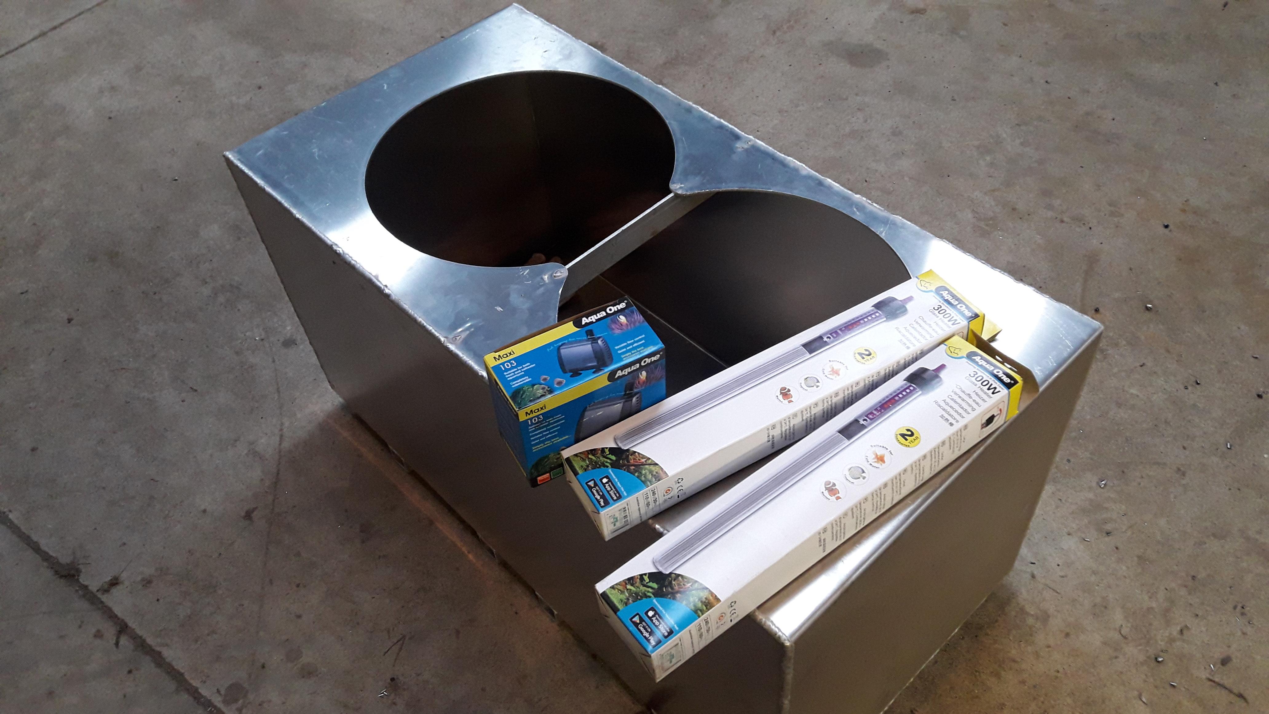

Has anyone tried this as a solution to bottles freezing That is a Aluminum box with the bottles sitting in it and filled with an antifreeze solution to stop corrosion with around 3-500 watt fish tank heaters and a submersible pump to circulate the water. The temp of the heaters cannot be set higher than 20 deg centigrade and even in the unlikely event of thermostat failure the low wattage could not over heat the bottles
Not that I know of, I've tried 1,500 watt magnetic engine heaters stuck directly to the tank and two (3,000w worth) on one tank only prolonged useful time. Putting the tank in about 15gl. of water in the slack tub kept it going all day.
I don't think your idea has enough output to work but I'm wrong often enough I won't be too surprised.
Yes that maybe the case Frosty but I can just add more heaters if the need arises, I was thinking this way to keep the wattage to the mininmum from a saftey point of veiw so not to have a possible bottle venting in the shop and the water was to give more effective heat transfer i was thinking of maybe a water depth of 300mm or so

Well I am getting well along with my bottle warmers for my two 45Kg cyl, There are two 300 watt heaters with a circulating pump all for heating fish tanks and submursable. The tank will be filled close to the top with antifreeze added mainly to stop corrosion but also the unlikely event of cold enough frosts (It has happened with other things in the shop) to freeze the water and damaging something. I was going to put it on wheels but i think I will leave it as is and shift it with the forklift when the need arrives
Impressive! I've noticed that my tanks seem to run a lot longer when the ambient temperature is in the 40's degC than when it's in the teens degC.
How cold does it get in your part of New Zealand? Maybe a better question is how much propane do you draw?

It has been a bit cold I measured -12 cent the other morning but it gets up to about 8 to maybe 12 deg cent in the afty my burner have two .9mm jets and maybe Im impaitent but run the presure about 15 to 20 psi and when i was doing the conrods I had it up to 30 psi That was really cranking out some heat. Our Lpg is mostly butane with some propane I believe and in the winter there is a bit more propane added. Even with both bottles paired after an hour or so the pressure drops to a point where I cant get the req pressure and there is a coating of ice on the outside of the bottles, Butane has a higher boiling point than propane
Yeah, butane has a much warmer freezing temp than propane and running all 4 burners I don't draw near the gas you do.
Living in cold country myself, I'll be interested to know how it works for you.
