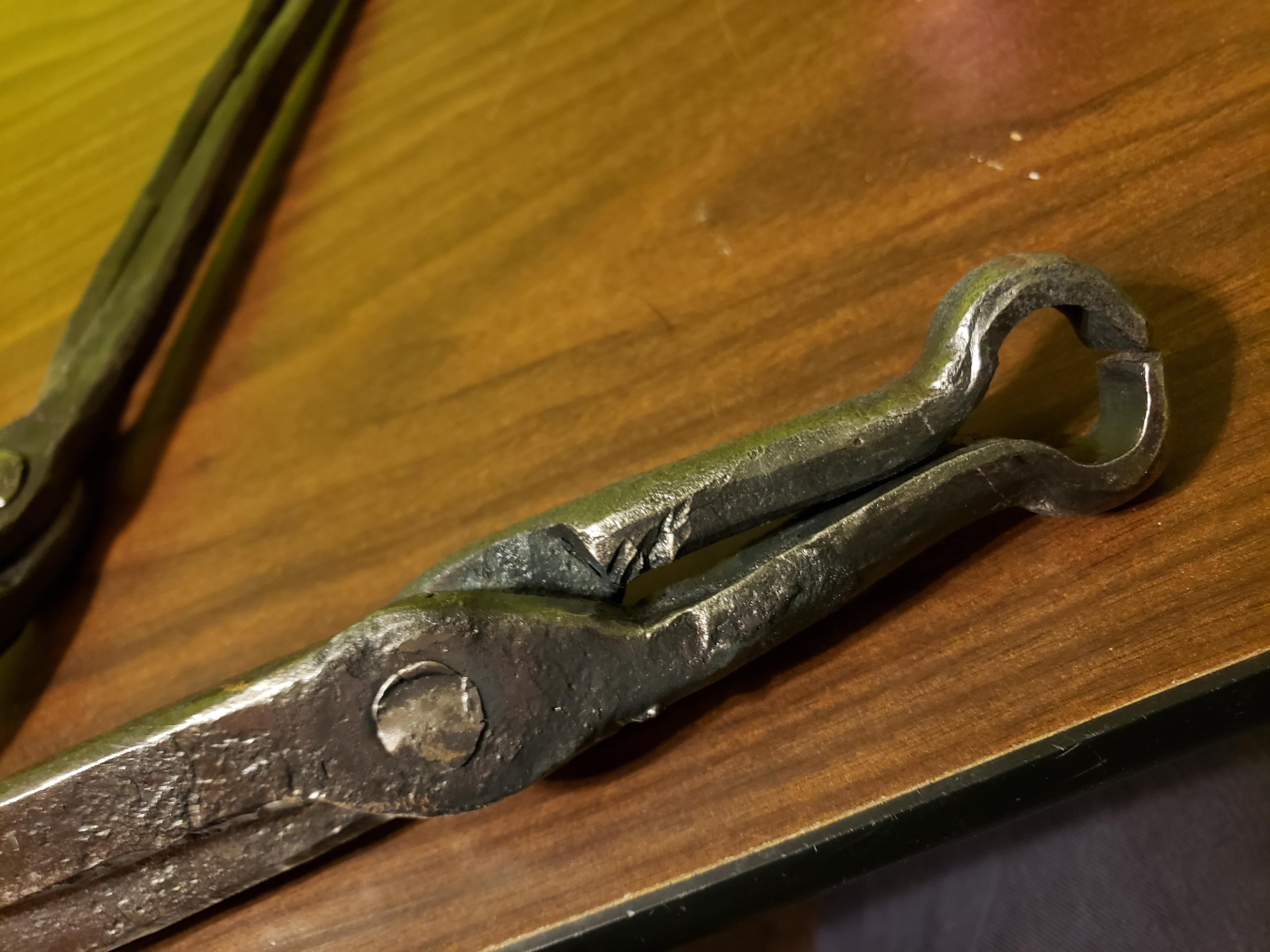

jason0012 Posted November 29, 2019 Share Posted November 29, 2019 The reality of the rebar availability is online the website says they have it but the folks at the store of course get that glazed over look when you ask about it. I have some of the higher grades rebar from a construction company. I ran a few pairs of tongs and have to admit I am disappointed. The texture is kind of a pain, but it just is not up to being the weight I want. These pick up tongs work fine, but, aside from thier being extra fugly, weigh about twice what they should. This stuff just doesn't have the spring to it that I am looking for. Oh well, back on the trail for tong stock. If all else fails maybe some of the quarries will have old sucker rod. ( I havent seen it, doesnt mean it isnt there) Quote Link to comment Share on other sites More sharing options...
anvil Posted November 30, 2019 Share Posted November 30, 2019 looks like you have a few cold shuts in those tongs. Using rebar of any kind for tongs means that when they get hot, you must quench them. then they break. Thus I use mild steel for all my tongs. no reforging, no no cold shuts, no breaking when quenched. Quote Link to comment Share on other sites More sharing options...
