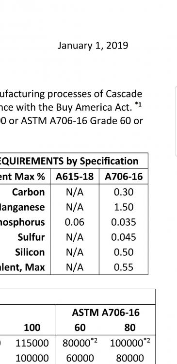

Buzzkill Posted September 12, 2018 Share Posted September 12, 2018 The risks of using rebar for making tongs, knives, etc. have been listed quite a few times on the site, including within this thread. The short version is that rebar in the US is the hot dog of steel. You never know what you'll get. One portion may be mild steel and a few inches away it may have enough carbon to harden. This makes it both difficult to work and unpredictable in behavior in use. Quenching mild steel tongs in a slack tub when they get hot doesn't hurt anything. Quenching medium or high carbon steel that's glowing can result in brittle pieces which can fail in use and cause you to have to try to dodge glowing flying steel. You're better off using known steel for the tools you are trusting to firmly hold incandescent steel in place while you repeatedly beat it with a hammer. Sure, scars are cool and all, but most of us have a large enough collection without adding more. Link to comment Share on other sites More sharing options...

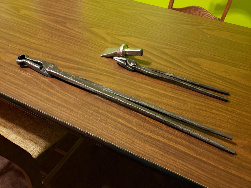

Irondragon Forge ClayWorks Posted July 4, 2019 Share Posted July 4, 2019 Welcome... have you read this yet? READ THIS FIRST It will help you get the best out of the forum. If we knew where in the world you are located we could direct you to suppliers, hence the suggestion to edit your profile to show location. For dimensions it depends upon what you want to use them for. I have tongs that are made from 1/4 inch stock 8 inches long all the way up to 1 inch stock 4 feet long. Link to comment Share on other sites More sharing options...
