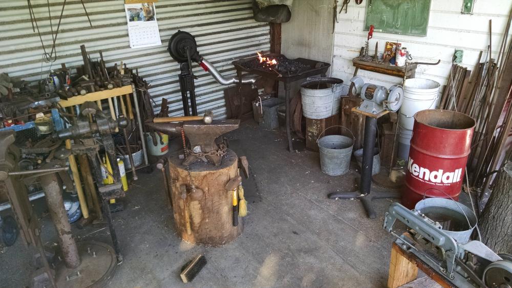

Michael Posted January 22, 2016 Share Posted January 22, 2016 I'd replied to this about 5 yesrs ago. Pic ssems lost but here's my corner of the patio setup. 104 # PW, pair of vises on stand, tool table, Tiger blower, forge table, grinder/wirewheel and power hacksaw. Not seen are a homemade swage block and the freon tank propane forge. Quote Link to comment Share on other sites More sharing options...

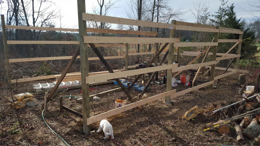

homeshow Posted February 24, 2016 Share Posted February 24, 2016 Building will be 20x48. Smithy will be 1/2 that 20x24. Quote Link to comment Share on other sites More sharing options...
Frosty Posted February 24, 2016 Share Posted February 24, 2016 That's going to be a nice space. I'm thinking it's going to get pretty wet when it rains, clay floor and under a slope. Unless the pic is misleading, easy to be, it looks like the ground slopes down right to the shop wall. Water flows down hill you might want to put a drain trench around it. Is the pup keeping you guys in line? Frosty The Lucky. Quote Link to comment Share on other sites More sharing options...
Forging Carver Posted February 25, 2016 Share Posted February 25, 2016 On January 22, 2016 at 11:59 AM, Michael said: I'd replied to this about 5 yesrs ago. Pic ssems lost but here's my corner of the patio setup. 104 # PW, pair of vises on stand, tool table, Tiger blower, forge table, grinder/wirewheel and power hacksaw. Not seen are a homemade swage block and the freon tank propane forge. Do you think that you can show me a picture of that homemade swage block and freon forge. Homemade swage block sounds interesting, and I am building a freon forge. Pictures would be a great help! Also, I like your set up. It is a nice sized work area. Thanks Quote Link to comment Share on other sites More sharing options...
homeshow Posted February 25, 2016 Share Posted February 25, 2016 Work in progress. Need dirt work concrete etc. Quote Link to comment Share on other sites More sharing options...

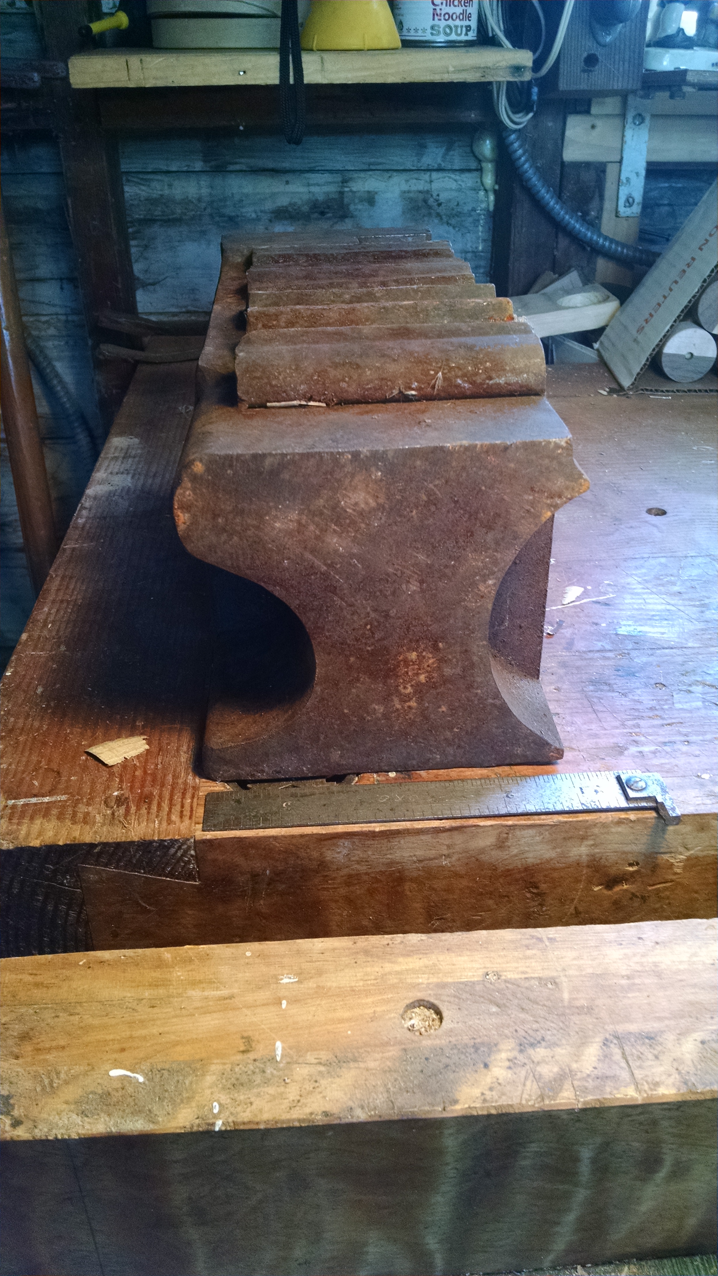

Michael Posted February 27, 2016 Share Posted February 27, 2016 On 2/25/2016 at 6:12 PM, Forging Carver said: Do you think that you can show me a picture of that homemade swage block and freon forge. Homemade swage block sounds interesting, and I am building a freon forge. Pictures would be a great help! Also, I like your set up. It is a nice sized work area. Thanks Here's the swage block, though I didn't make it, Got it when a a friend was moving her shop, don't know if she made it either. I think it started as a section of RR track with a lot of welding and grinding, but I could be wrong, About a foot long and a little under 6 inches square. Not sure of the weight. I find the bowls and curves on the side facing the camera in the first pic the most useful. Freon tank gas forge, before I cut down the burner tube as per Frosty. 1 inch of kaowool, ITC 100 and kiln shelving for the floor and back door. I close up the front with firebricks. Very important to make the floor of the forge and the opening one fire brick high, so you can stack bricks in front to make a porch the work can rest on. I followed Ron Reil's instructions to the letter and the 3/4 burner worked great first time I fired it up. I've not had to mess with it since except to cut it shorter. I did all the bolting of the legs, handle, back door brackets and burner holder thru the narrow opening cut in the Freon tank, then once it was standing, measured with a firebrick and cut the front door opening. The kiln shelf floor rests on the ends of the bolts holding the legs on, the whole space under the shelf filled with kaowool. Quote Link to comment Share on other sites More sharing options...
Forging Carver Posted February 28, 2016 Share Posted February 28, 2016 Cool stuff! Thanks Quote Link to comment Share on other sites More sharing options...
