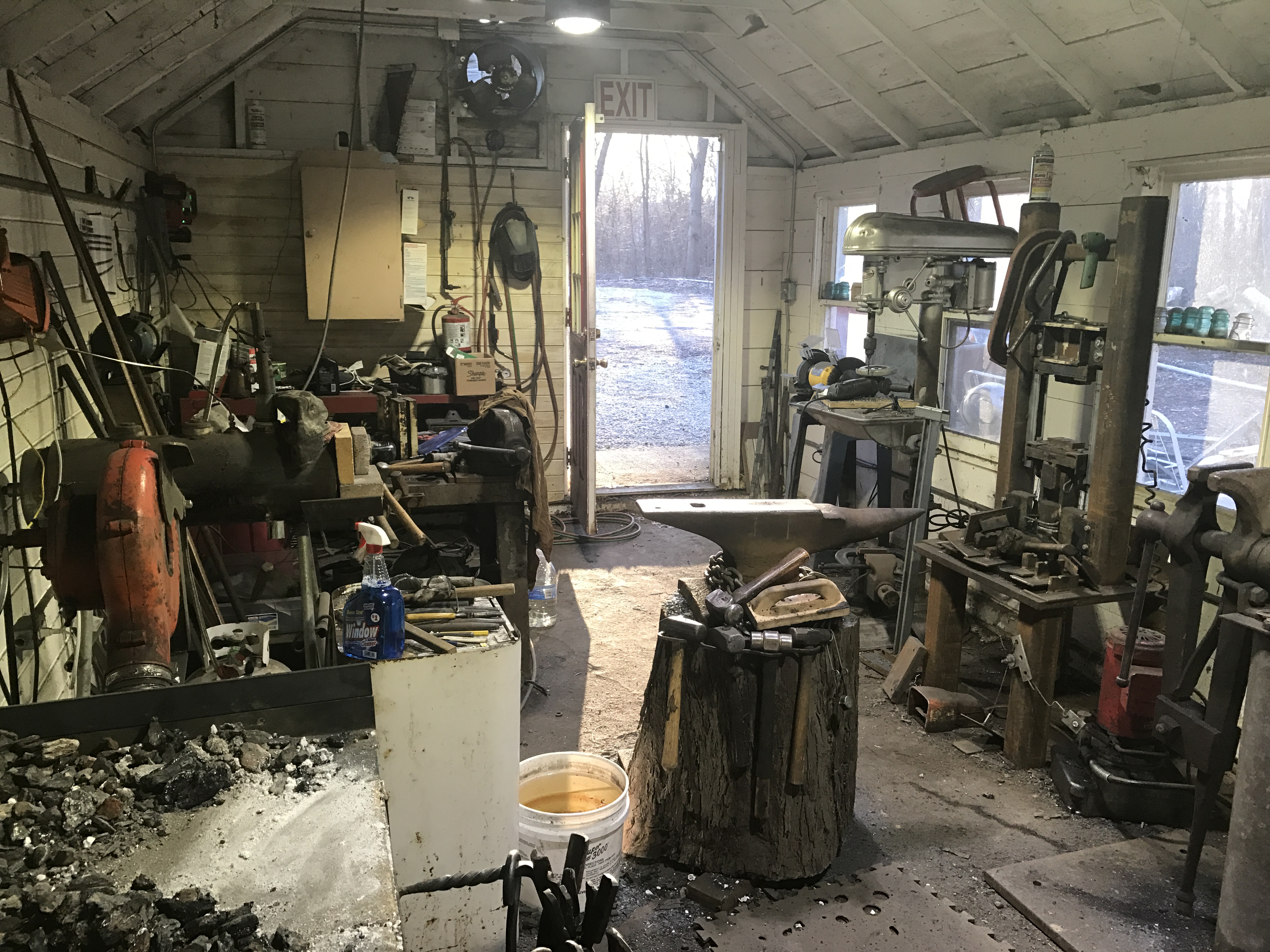

Scoot Posted March 1, 2017 Share Posted March 1, 2017 This is it for now. Scoot Quote Link to comment Share on other sites More sharing options...
JHCC Posted March 1, 2017 Share Posted March 1, 2017 58 minutes ago, Scoot said: This is it for now. Scoot Careful with flying sparks around those leaves! (Don't ask me how I know this.) Quote Link to comment Share on other sites More sharing options...
Tubalcain2 Posted March 1, 2017 Share Posted March 1, 2017 I can second that. Quote Link to comment Share on other sites More sharing options...
JHCC Posted March 1, 2017 Share Posted March 1, 2017 14 minutes ago, Tubalcain2 said: I can second that. I won't ask. Quote Link to comment Share on other sites More sharing options...
Tubalcain2 Posted March 1, 2017 Share Posted March 1, 2017 7 minutes ago, JHCC said: I won't ask. Quote Link to comment Share on other sites More sharing options...

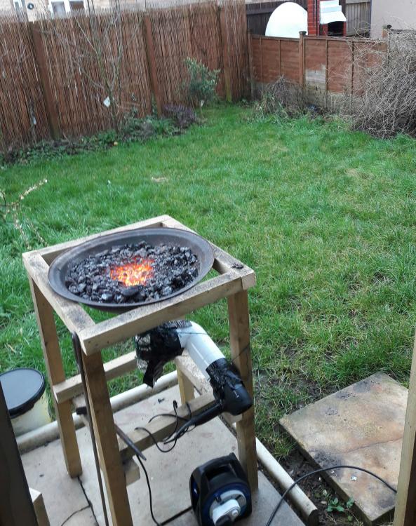

Zeroclick Posted March 4, 2017 Share Posted March 4, 2017 So this is my workshop at the moment it is an 8 x 4 shed and I work in one half with the garden tools at the other. I have to lift my forge out on to a small patio I built. It isn't ideal but it keeps everything safe and dry. Soon I should be moving house which has a garage that I will be using as my workshop it should be really good to get a lot more room. Quote Link to comment Share on other sites More sharing options...

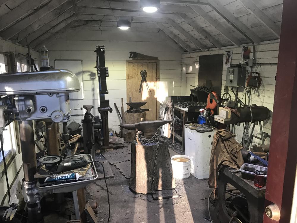

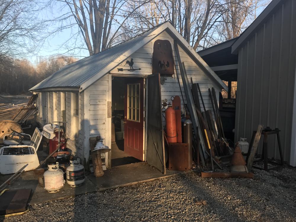

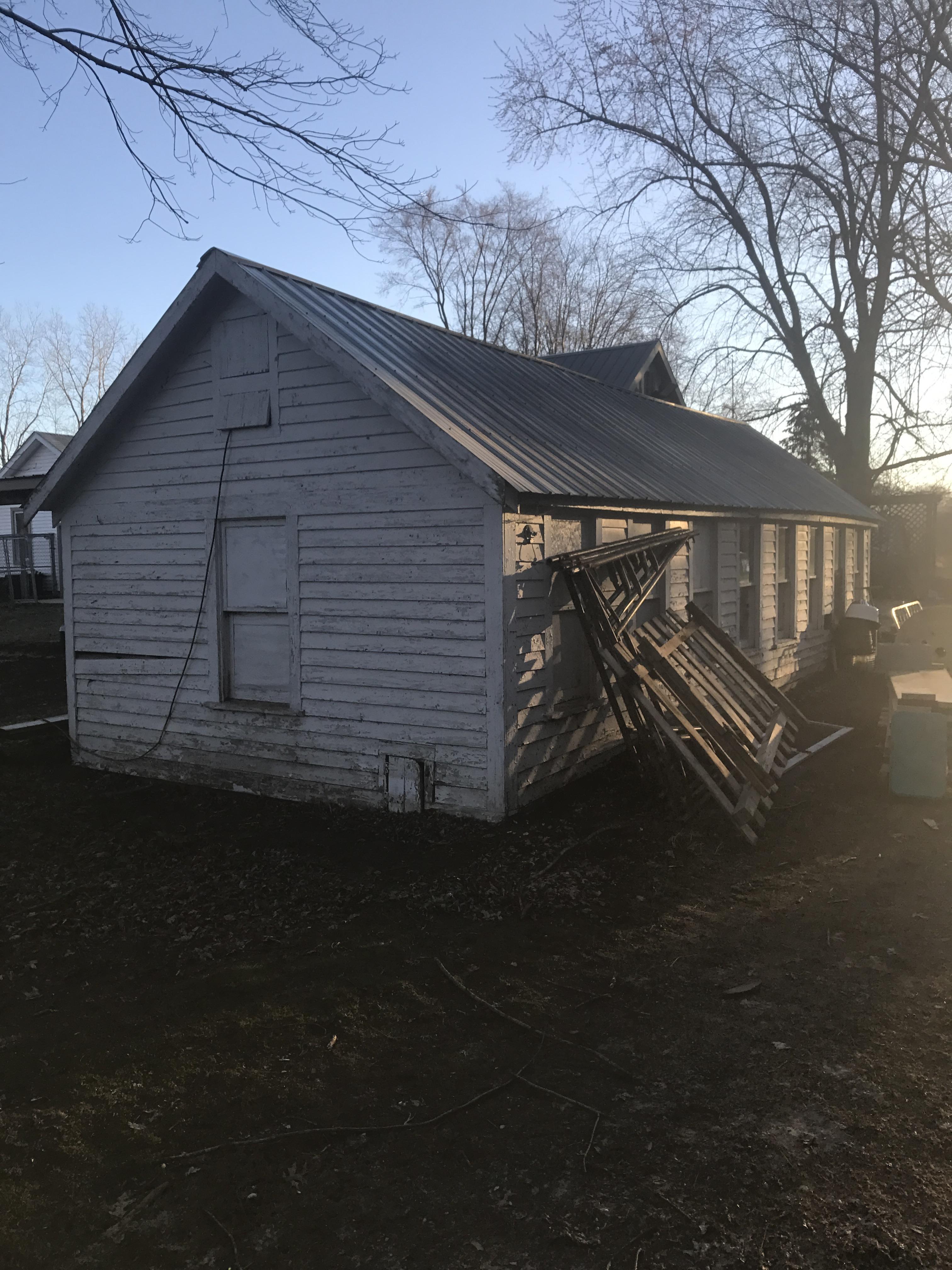

bubba682 Posted March 9, 2017 Share Posted March 9, 2017 My shop, well half anyway Quote Link to comment Share on other sites More sharing options...
