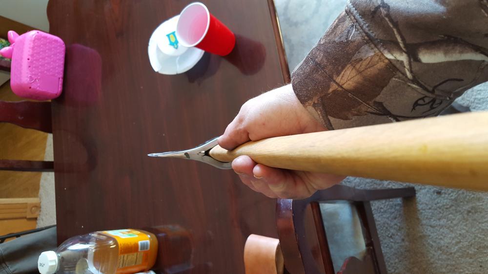

  5. Mild steel wrap around 5160 core. Tennessee hickory handle. Been using it for a few weeks. Love the geometry of it. Cuts and split beautifully.

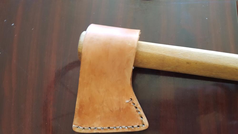

  8. My buddies nephew had a birthday. So I threw together a sheath for my current kindling splitter. His dad has been trying to wear it out. Mild steel wrap and a farrier's rasp bit. I'm thinking of making a few to take to craft show. Any pricing suggestions? image%3A1753
