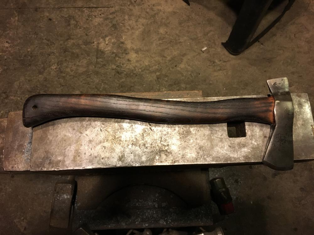

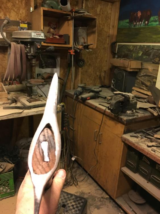

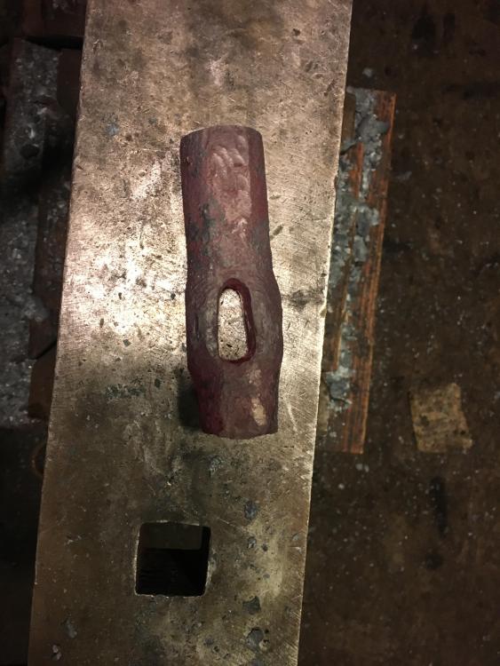

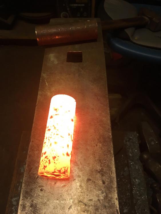

  1. Thanks! Yeah, I made the handle out of a hickory board. I shaped it and did the majority of it with my awful little belt sander, then hand sanded it to 400 grit and then took a propane torch and lightly charred it , once again lightly with the 400 grit getting any too charred spots and then a coat of dark wood stainer. It turned out better than I thought it would! I totally see what ya mean and I'll be putting it use in future handles for sure! Thanks! The Axel diameter is 1 1\2"

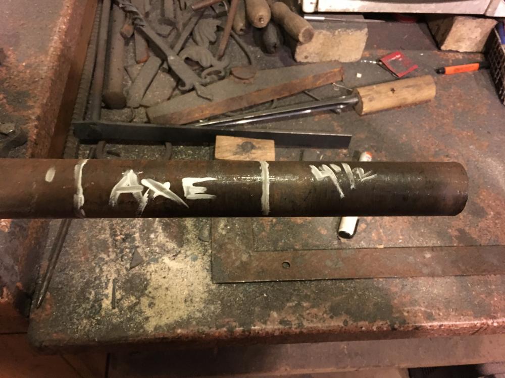

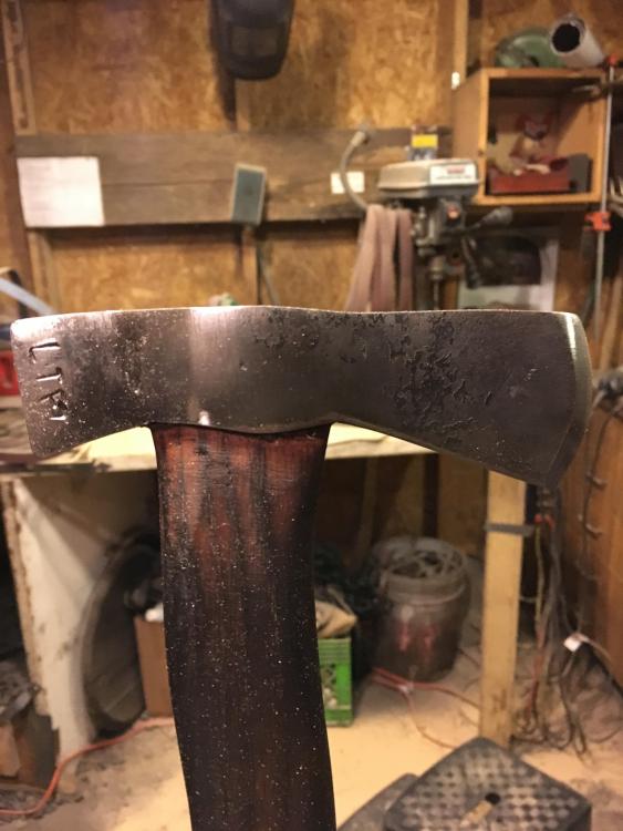

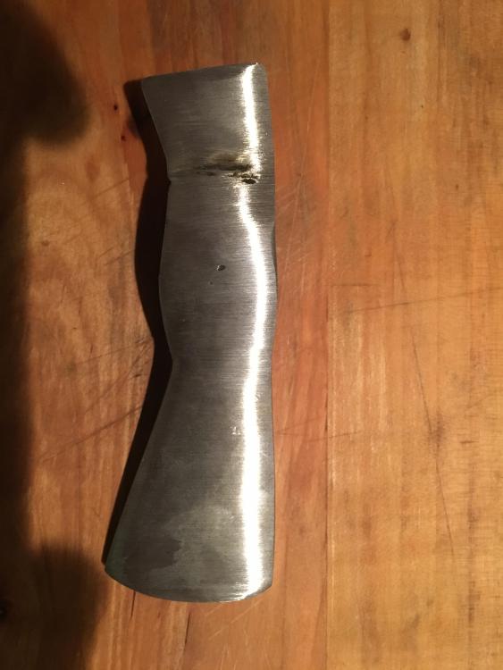

  2. Here's the newest one I just finished I have two more left to do handles for. I started with 4 1/2" of axel and went from there. Definitely going to make a few more out of the axel as it was relatively easy to work and took a nice heat treatment and stayed hard so there was no need to forge weld a higher carbon bit in. I quenched in 100degree motor oil at around 1500 degrees and tempered in the oven for two hours at 360. It's slightly modeled to be a smaller variation of the Kentucky or Ft. Meigs belt ax. The handle is hickory. Please let me know what ya think and any suggestions or criticism is welcome!

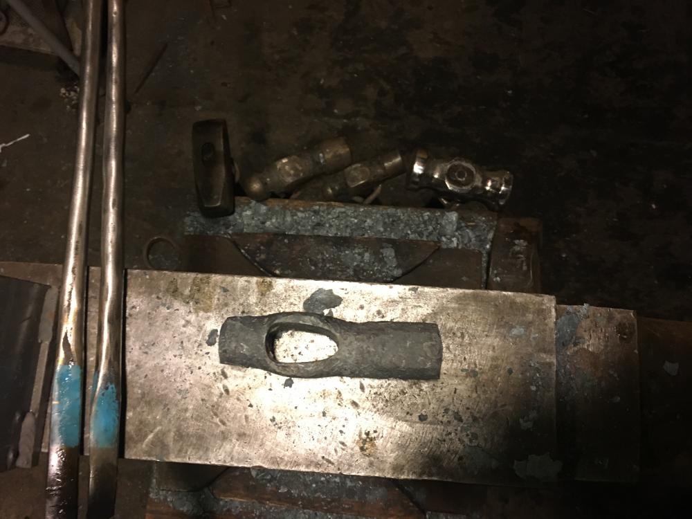

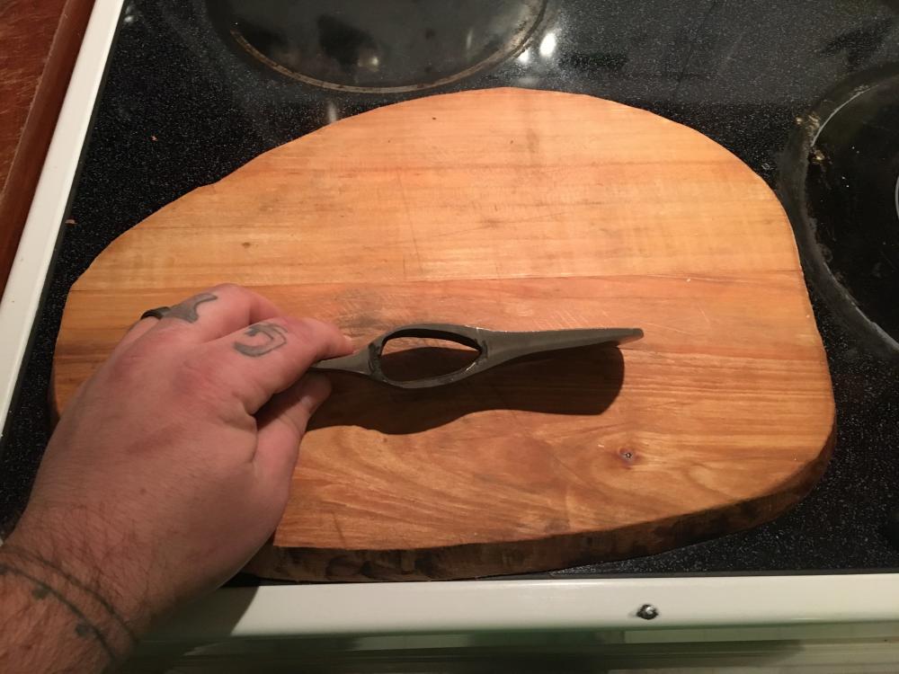

  10. Hey guys, today my neighbor brought me two of these and said they were in the garage when he moved in 10 years ago. Neither of us knew what they were my guess and was some kind of harrow or grader bit but it's totally a guess any help would be appreciated
