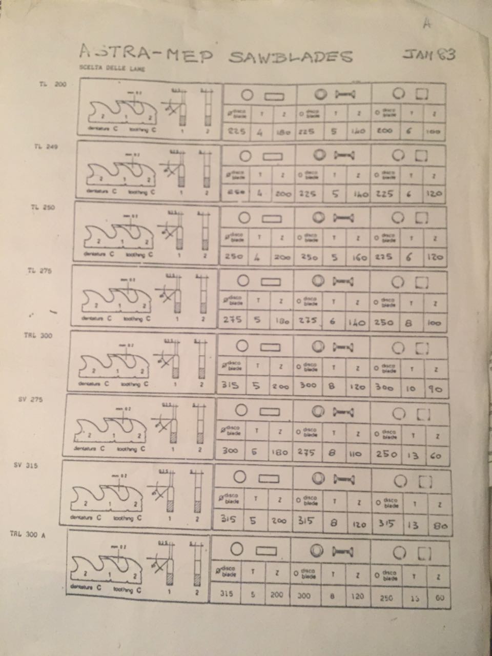

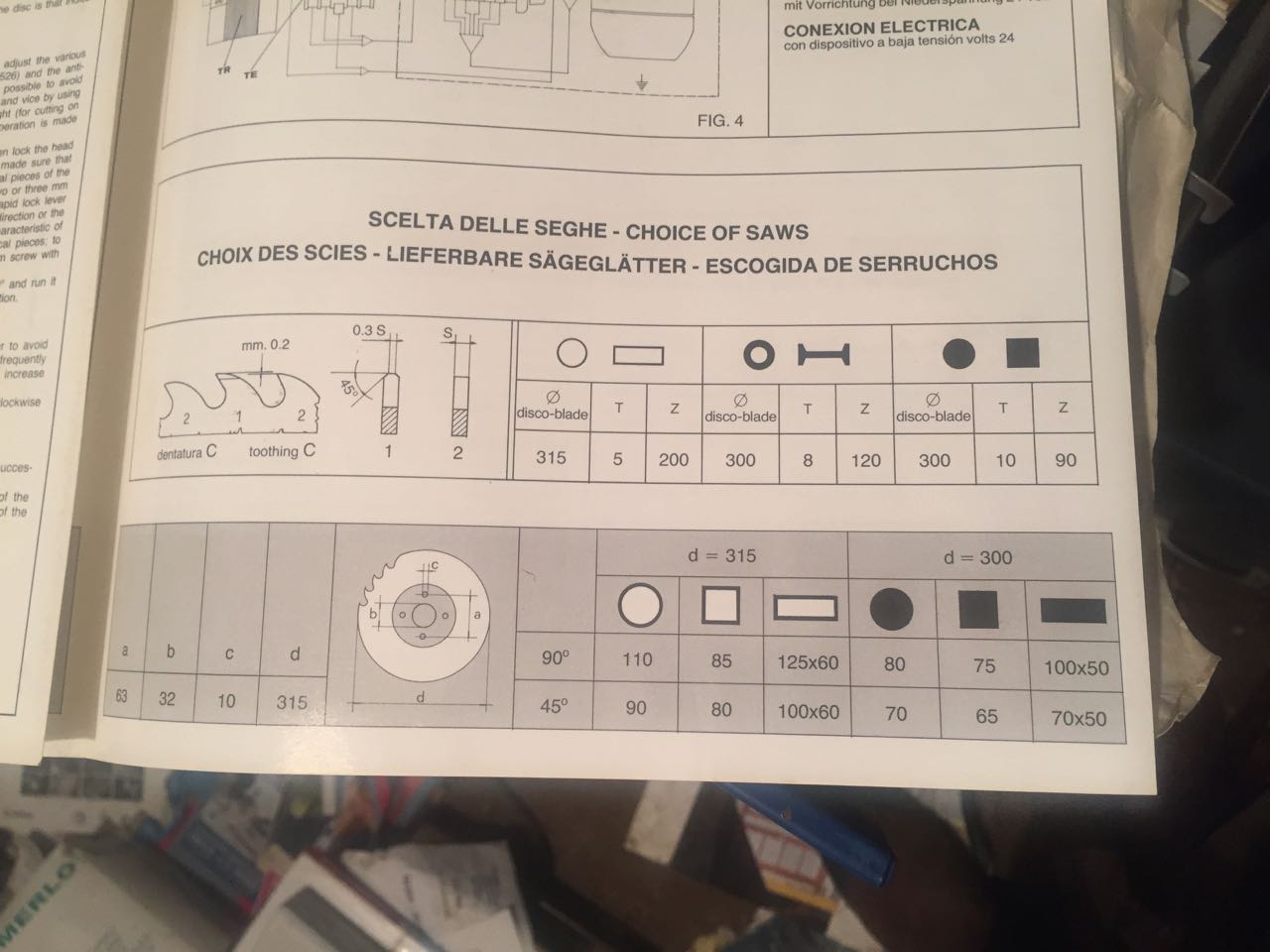

I found the handbook guidance as well...Talk about squirrels never throwing anything away! I was a bit shocked to see I had bought the saw around 1983 takes you back a bit to see a typewritten and photocopied user manual rather than word-processed and laser printed! The saw has two speeds, 30/60 rpm. I am usually on 60 rpm for the coarser blades in order to prevent snatching. The blade photo is one of my coarser toothed Ø300mm (Ø12") ones for solid bar, the teeth are around 10mm pitch (2.5TPI) after however many sharpenings they have had. I do have finer toothed blades for hollow section and lighter solid stuff. But if the blades don't crack, by the time you have got a 100 tooth Ø315mm (Ø125/8") 10mm pitch (2.5TPI) down to Ø250 with successive resharpenings they are down to less than 8mm pitch (3TPI) and good for anything over 25mm (1") solid. Having looked at my stock of blades and thinking about the size range of solid material I cut, I am often working with nearer to 2.5 teeth in contact rather than 3. But like any tool you take it gently when you need to...starting on a square bar with a fine pitch tooth blade you only have 1 tooth in contact for a while...even with Ø50mm (2") round bar there are only one or two teeth in contact initially. Alan

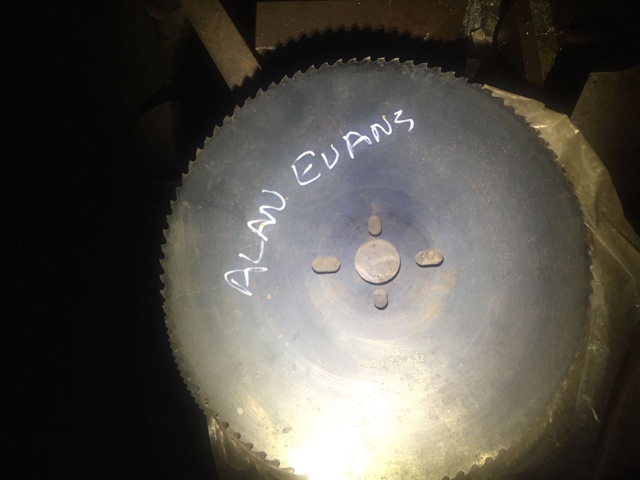

I use the three teeth contact rule for all saw blades. So for solid section the teeth a fairly spaced out...I cannot remember the numbers off the top of my head, but I seem to remember the Astra manual's TPI suggestion conformed to the rule. Interestingly I found that friends with Mec Brown cold saws ran theirs with much finer teeth then mine and seemed to get away with it. My main problem was with the suds/coolant I ended up using a highly specced one for Stainless Steel for everything...and sometimes helped it along with Rocol cutting fluid dribbled direct into the cut when actually in Stainless. It did help to reduce the pinning a bit. Alan
