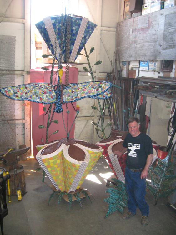

this is one piece of a larger art project I was involved in with an artist friend of mine here theres 2 dragon fly's in this project & this is one of 2 -- 3 LG flowers & 13 ' of vine work for both walls heres some of the parts i will try & find pic of installation -
