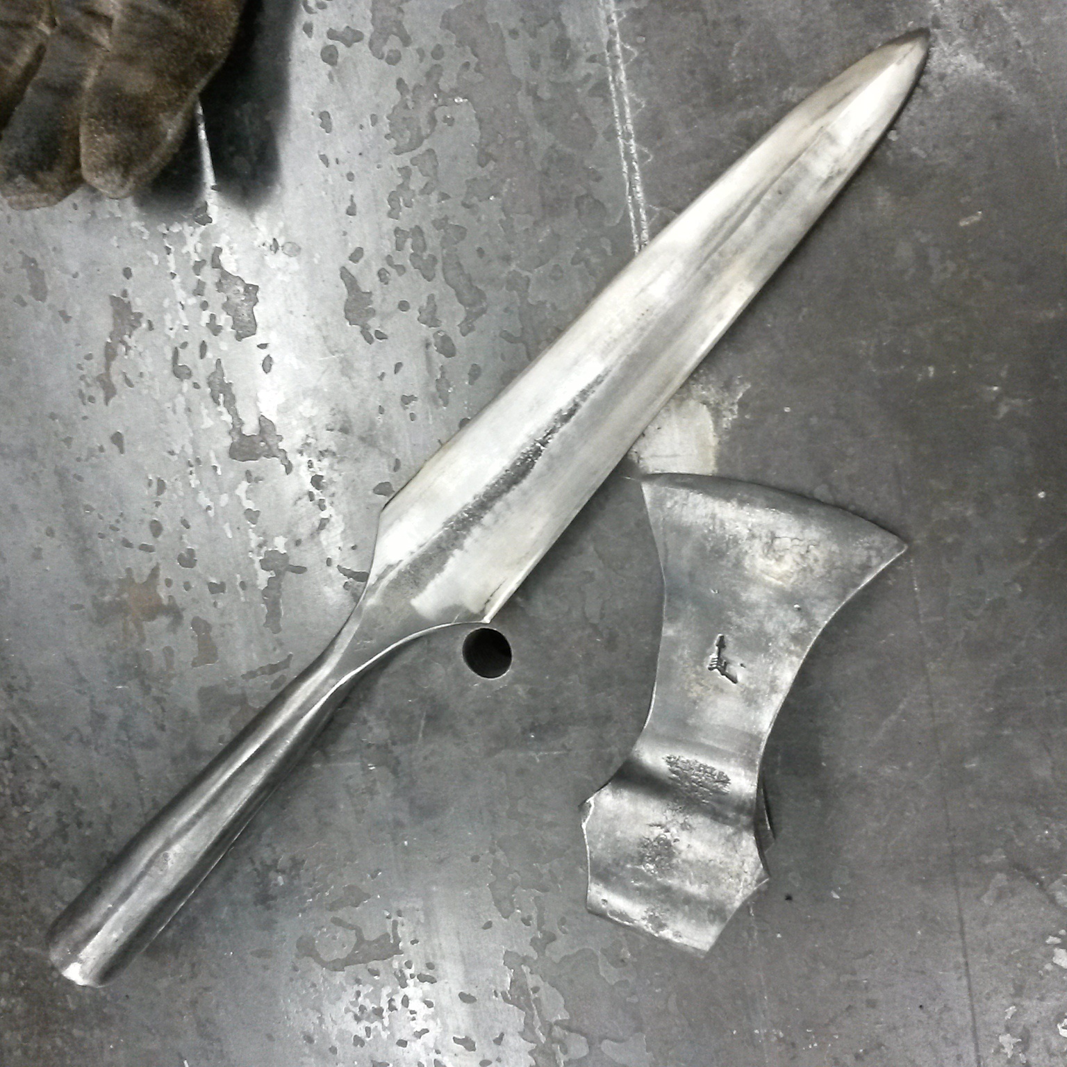

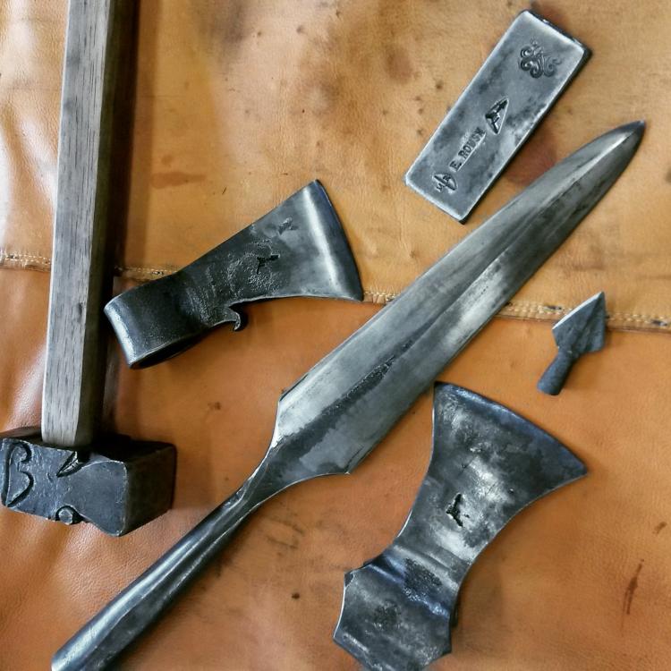

  9. Took a Viking Era Blacksmithing class taught by Mr. Elmer Roush a few weeks ago. Great class! We went over mammen pattern axes, spears, arrowheads, and some other pattern axes. I was able to forge a large spear (my favorite exercise from the class), a mammen pattern axe, a mess of arrowheads (none of which I was super proud of, need more practice with those), and I managed to squeak in a tomahawk on the last day for fun! Great class, great facilities at John C. Campbell Folk School, great FOOD, and a truly inspiring, down to earth, helpful instructor and assistant. I can't wait to go back and learn more from Elmer. I've never forged a spear before but I think I truly enjoyed forging the spear more than I do axes, tomahawks, knives, or whatever. What a fun process! The spear, hawk, and axe are all A36 with 1095 welded cutting edges and bits. The arrowheads are all mild. Thanks for looking! Moderators, I put this in historical based on the title, my apologies if it is improperly located!
