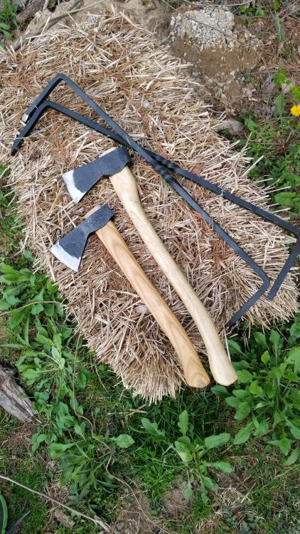

  5. Hey Folks! It's been quite some time since I've posted. Just thought I'd share a few goodies from recent orders. The snowy camp axe is mild with 5160 bit, the last of my axes with 5160. It is also a hand-carved ash handle. The camp axe i'm holding is with a 1084 bit, and the long scandi axe, it's smaller hudson bay-ish partner are 4140. The 4140 axes are punched and drifted... I'm not a fan of doing this solo so we're building a 25t C frame press from Batson's book. Pretty excited to have it finished and start punching, drifting, and forging axes! The hawks are mild and 1084. I love 1084... it sticks SO nicely to A36. Cheers!
  6. Good clean eye punch and drift. Clean 'er up on the grinder and show us how it looks on a handle. Great work!
