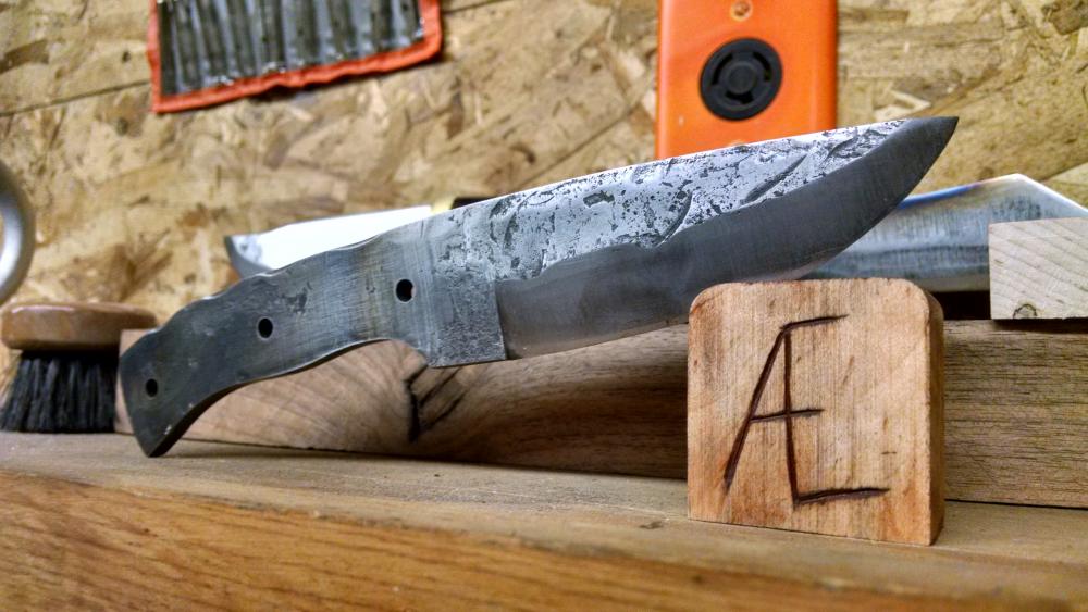

  3. Been hard at it fiddling around with the forge again... I think I'm on the right track here. I'm gonna need more leaf springs at this rate. 4 1/2" blade seax, carved walnut handle, full tang I finished up this morning. 3 1/2" drop point, leaving the forge marks in but took it to 1,000 grit to still shine. Casting the brass guard tomorrow, scales for the handle should be in early this week. 6" Bowie I started today. Only stock removal was cutting the tang out. Plan on leaving the forge marks in it except the edge. Getting a steel guard on this one I think. I sold my Jeep today, I'm debating whether I need to catch up on bills or go get one of those fancy store bought anvils with that money haha. I'm having way too much fun with this knife thing!

  12. Thanks JHCC! The hidden tang knife started it's life as a leaf spring from a 76 dodge pickup. Curious to see how it holds up!
