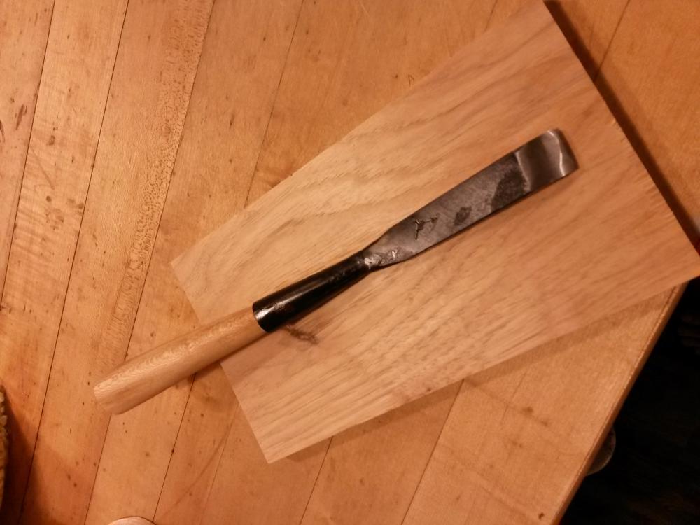

HI Mr. Boggs, loved your demo in the Anvils Ring, that was what inspired me to try! I started with half inch round stock, upset it to about 5/8 or 3/4 and flattened it on the edge of the anvil, much like a socket for bodkin/medieval arrowheads. Rolled and rounded it between the step and the anvil face with a ballpeen. I worked the neck where the solid stock meets the socket with a cross and ball peen to try to thin and smooth it out. Then drew the blade part out flat to my desired width, grabbed some 5160 and matched the width, drew it a bit longer. For the weld, I laid the body on top of the carbon steel, folded a lip over the end to secure it, then heated 'er up and welded it. Then I forge welded the socket closed, too. Ground, hardened in used motor oil, set my tempering oven to 425, stuck it in and came back an hour later. Mr. Boggs, when you fit the ring on the end of your handle of your chisel, do you hot fit it? Frosty, it shaves curls beautifully!
Here's my first wood chisel. I wanted to do a style like Gerald Boggs but I don't have the best equipment/skill to forge shoulders, so I decided to do a socket style. Mild steel socket and body, 5160 forgewelded onto the bottom for edge, and a sycamore handle. I have some trouble with forging sockets and not getting a slight gap or space where they'll meet the body, whether or not it's on a chisel or an arrowhead. I have trouble getting a completely wrapped, no gap socket. Any tips or suggestions? I chose sycamore because i've been told it makes good hammer handles and is nice and hard, so I thought I'd give it a whirl. Heat treat was quenched in warm, used motor oil and baked at 425F for an hour and a half. Thanks!

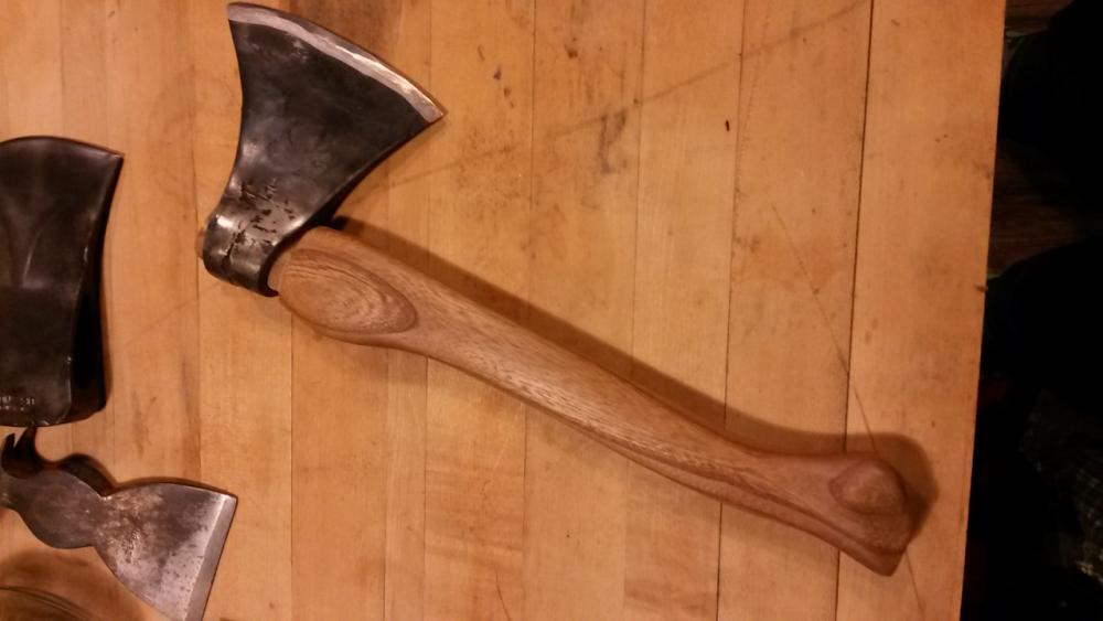

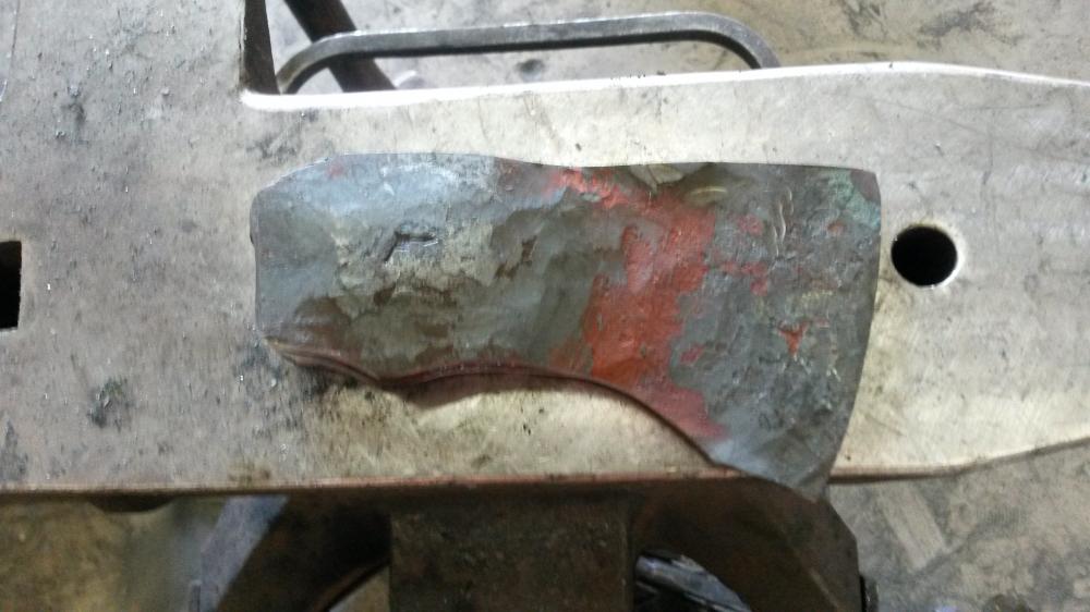

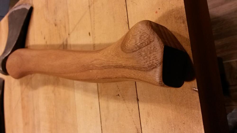

Around the holidays I was carving spoons and decided I wanted to forge a new carver. This was forged from wrought with 5160 for the bit. I don't like forging wrought, for you can see around the eye it split when I was compressing it. I know I wasn't working it hot enough, but phew! Wrought is some finnicky stuff. I had worked with it once before, but I think it'll be a while before I use it again. Hand carved elm handle. I sized the eye with a tomahawk drift, and though it's a round eye I was still able to wedge it and get a solid hang. Not my prettiest piece, but it's sharp and carves well. I was going to etch the head, but I got impatient and left the temper colors on. I cleaned it up with an air powered grinder/buffer with some 60 grit wheels. I may hand polish it and try to re-etch it without removing the handle. I had tried to etch it... but then I realized I hadn't cleaned off the temper colors and stuff. I was in a hurry the night of finishing, unfortunately.Thanks for looking! I sure did learn a lot on this one. Work wrought hotter, don't get in a hurry.

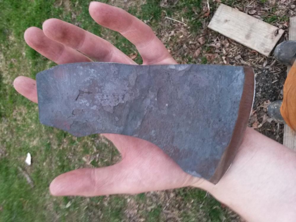

Hey folks! Just wanted to share my finished camp ax. I forged this back in March at Liam Hoffman's ax forging class. Just recently was able to finish it. Drifted eye 4140. We only broke one sledge that weekend! This is only my second or third handle, carved from ash. Gave it a bake for 1.5hrs @400. I didn't get quite the harden i would have liked, though. I didn't have any parks 50 to quench in, and it didn't like hardening in veggie oil or used motor oil. I recently was able to field test it this past weekend. It sure did like to throw some nice sized chips! But hey, that's what first time experiments are for, yeah? Thanks for looking!
