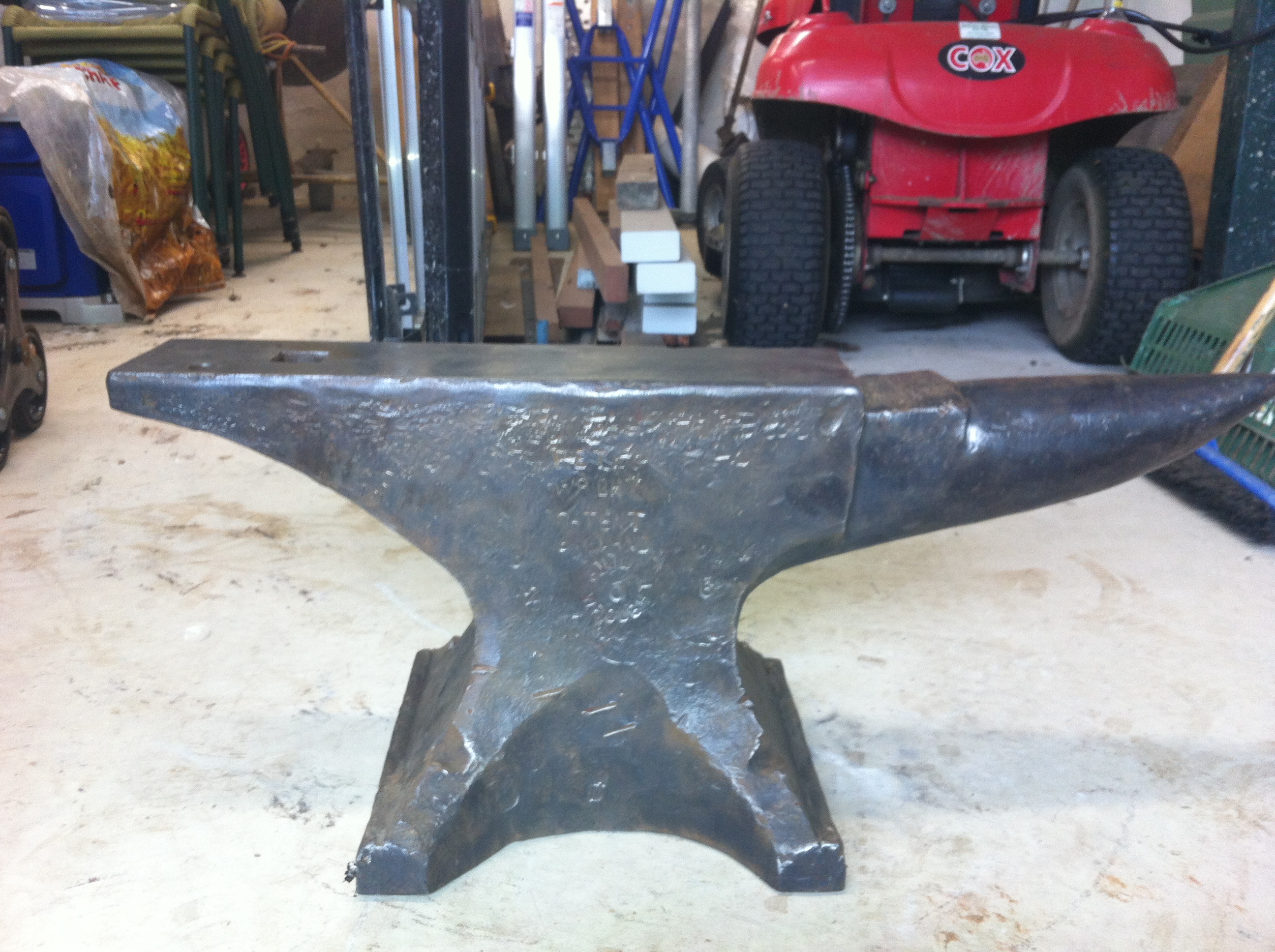

My recently found 208 pound Peter Wright. Bought on ebay of all places. Comes with a story. The seller lives in a very affluent suburb in a multi million dollar house, and does not seem to be a blacksmith. Checked the anvil out and asked him how he came by the anvil. The guy tells me that when he was 18 (he is now about 60) a friend of the family a very old person, came to him asking him to "get rid of this anvil for me". He put it in the family home garage, and covered it with a tarp and it layed there for 40 years. I didn't ask anything further. The price was right (for Australia that is) and the anvil is almost perfect but for a small chip.- Arm & Hammer Anvil
