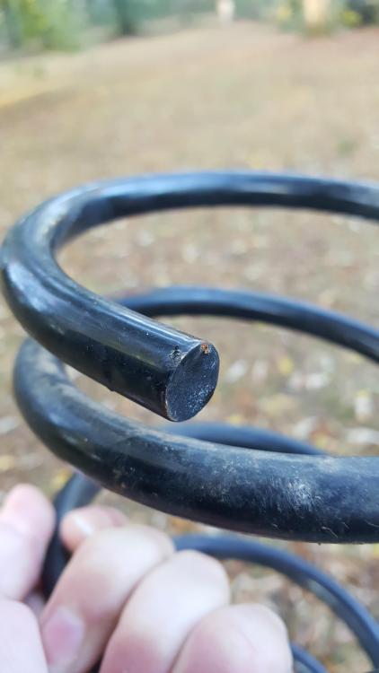

  4. Erring on the side of safety, I cut off a very small piece and burned it from a distance outside in the breeze. The coating bubbles and boils out before burning off, which leads me to believe it isn't paint. Not wanting to try burning it any further, I used a wire brush attachment? (not sure what that's actually called) for my angle grinder and it stripped right away. I'll pay more attention next time I pick some up and not grab the coated ones... It does seem like all of them would have some kind of anti-rust treatment though, right? Anyone familiar with car coil springs that knows of anything specific to avoid? As I mentioned earlier, I'm pretty new, and absolutely not at all a mechanic. I have a junkyard pulling some leaf springs for me this week, but they have a kajillion coil springs that cost basically nothing, a good source of metal if they work out.
  5. Good morning guys. I picked up a coil spring from a junkyard from some random car. I'm still pretty new, so I can't tell if it's "a good one" or not, but I'd like to make a couple punches from it. I should have maybe looked more closely, but it has some kind of either paint or enamel coating, and I thought before I stick it in fire I'd reach out and see if anyone has any thoughts. I figure it will just burn off and everything will be cool, but I'don't rather not die from fumes of some burning enamel coating just because I didn't ask. I'm including a pic.
