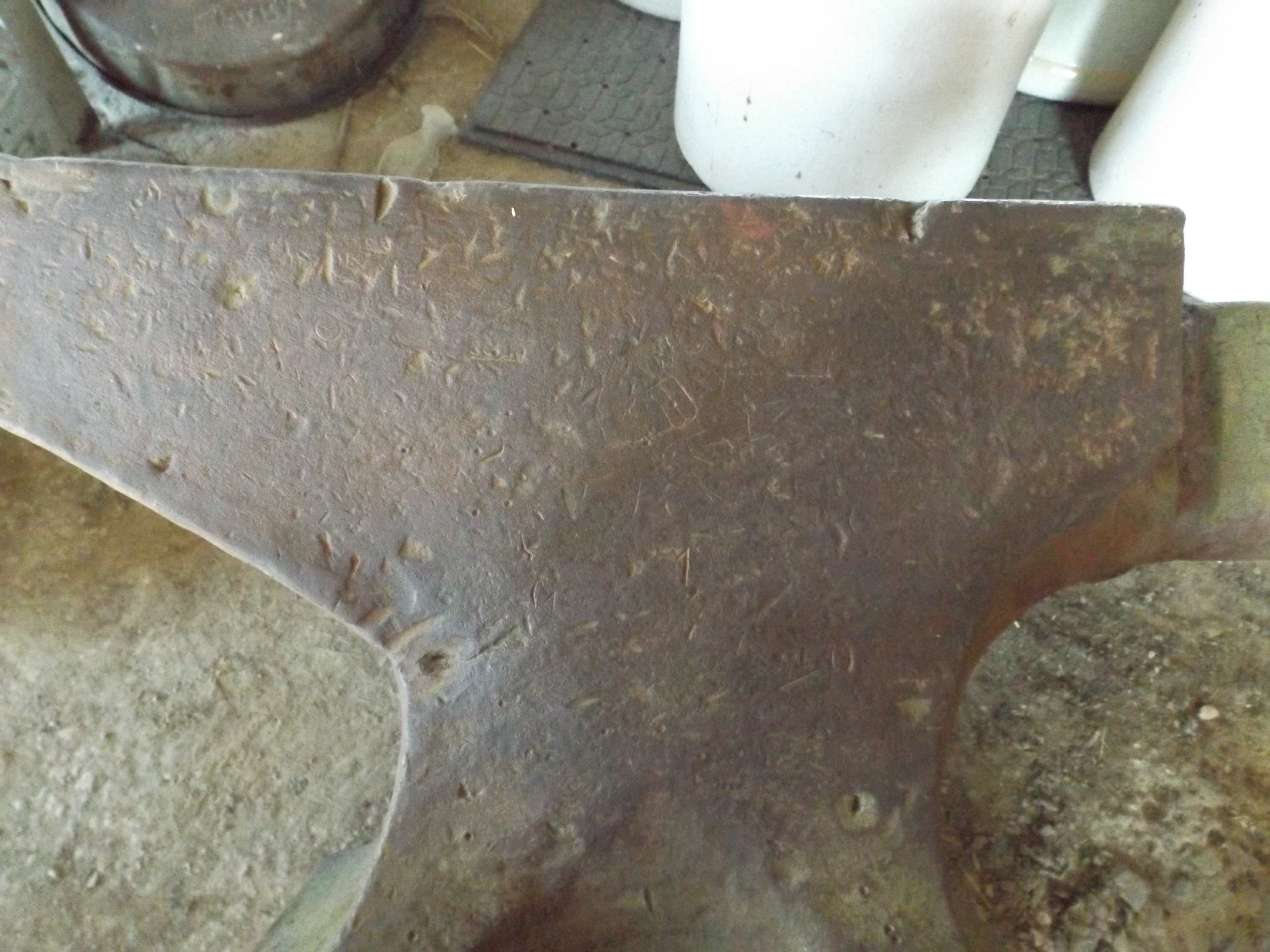

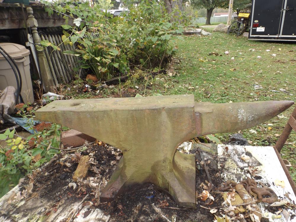

hello, I ran across this Arm & Hammer Anvil said to be 400 Lbs. I can't make out much in the photo.. its  38 3/4" long with a 25 3/8" X 6" face. It stands 15 1/2" tall and has a base that's 15" X 13" with the photos I have I was wondering what a fair market value would be for it ?? thanks for any responses .. JT
  • Replies 56
  • Views 12.1k
First get a true weight on it
Then test the face for softening in a fire---(this is like seeing if a used car's engine will run and so why I suggest it for all anvil buys, the ball bearing test is a good one!)
Hard to see in your pictures the state of the face: if the face is smooth, (not flat, smooth, though both is better), in your location I  would expect US$2-$3  a pound would be a working anvil price (hence a "true weight") above that I would consider it as an anvil collector price and expect it to sit out rusting for a long while.
What does the bottom look like?
According to your measurements, the anvil is at least 400 lb, maybe a bit more.  The condition of the face is key.  It is hard to tell it the edges are good or worn in the photo provided.  But know that A&H anvils are considered to be among the best made, and command top $$, if the condition is good.
My 433lb Arm and Hammer is 37in long 16in tall and 5 3/4 in wide. The one you are looking at may be a little heavier but A&H sort of weighed them after the fact and they weren't always to made a strict size. Matchless antiques is sort of setting the market price in your area and they are getting a premium for A&H anvils in good condition so $4/lb would be reasonable for a really big one.
well they are supposed to send me more photos today, here is another poor photo they sent yesterday. they said it was there fathers who is I think they said is 86 and he bought it when he was 20 from a rock quarry.. they said someone told them by looking at the photos and measurements it was 400 lbs.. and they tried to weight it on a scale that only went to 350 lbs. and it immediately maxed it out..  looks closer to 5 3/4" face.. not sure what the bottom looks like waiting on more photos.. they may be a bit high on their price.. they are talking $4.50 a Lb. @ 400 lbs. they may come down a bit , I don't know though..
If Its in nice condition that is a fair price. You don't run across anvils that big everyday and big A&H anvils are super rare. They are are beyond good.

thank you all for responding !! I will post more photos when I get them and ask the seller more questions.. as of now, its mine if I want it, I just need to find out a bit more to decide ..
well I must say they aren't  very good at supplying the photos I asked for.. although I am dealing with a lady..  I asked for photos of the face, but she didn't know what the face was and asked if they could either lay a yard stick or a level across the length of the anvil to see if it has any sway, but got the photo with the tape measure ...   she did admit to not knowing the first thing about anvils.. and she is sorry but anvils just aren't their thing !! but she has come down to $4.00 a lb. based on 400lbs. the last photo is to show the comparison in size to anvils in the 100+ size range..
Beautiful anvil.

It Looks to be in excellent condition, That is a fair price and if I were closer it would be mine!
$1600 for a nice 400+ pound A&H won't be around all that long I'm guessing....
Looks like a "1" character  in the middle of the side.  So guessing 410 to 419 pounds?
That's a fair price, If it still has good rebound and you have the cash I would get it, you don't trip over big arm and hammers everyday and they make a good Anvil
