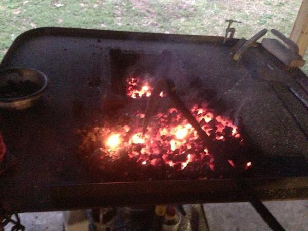

Towards the end of this post I have some pics on how I shut mine down. http://www.iforgeiron.com/topic/30981-first-time-using-coal-need-help/ I just try to get the coke off the top separated from the coal on the sides. Make sure the Coke is broke up enough so it goes out in minutes. Golf ball size max give or take. Spread thin, not in a mound... Yeah and don't stir up the bottom. Get used to dumping most of that next time you start the forge.

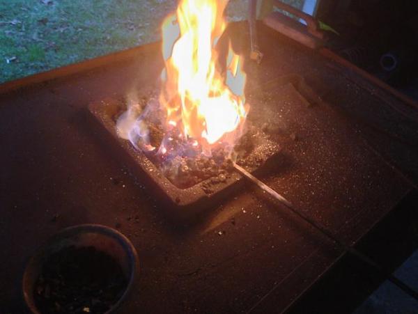

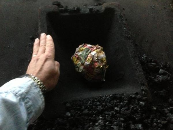

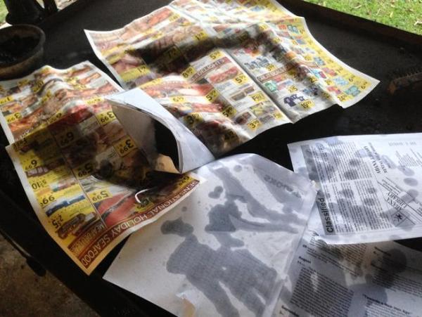

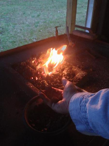

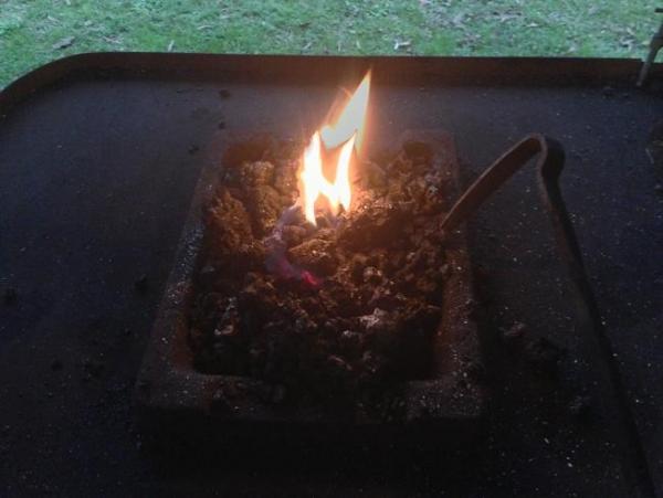

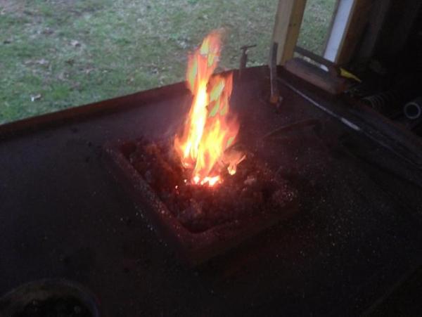

I live in Southern Lousiana. It is humid most all the time. I keep paper in my shop from junk mail. No shiny stuff. I find, especially in the heat of humid summer than even paper in my shop can burn poorly. So I cheat. It works and it uses, for the most part just extra stuff I have around. I have a wood shop so I band saw small left over pieces of wood into small pieces. Sometimes I split them small on the hardy. I also sift the dust out of my coal. Prolly don't need to but I do. So I have plenty coaol dust. So I take a humid junk mail envelope to start with. Add some wood bits. Pour in some coal dust. Lay out some humid paper on the forge. Douse all with a sprikling of charcoal starter fluid. Rap it tight and light it off. Turn the blower slow and start piling up the coke around the edges trying to keep a flame. Sprinkle some coal if needed and slowly let it all catch fire. I can get a decent fire in minutes. A mature fire takes longer but this never fails me. I only fail when I try to short cut the paper or mostly when I have some of that shiny paper. "Avoid the SHINY PAPER" I also use the coal dust to pour over a mature fire to make a cave. It's smoky and disrupts the fire but helps use up the dust and makes a good roof. I just do what I do. It don't make it right. But I don't feel bad about using the charcoal starter. There are many times in deep humid summer when there has been little rain that paper is a bit stubborn to light. I could baby it but why...? I go with the thinking that the blacksmith uses what he has on hand.

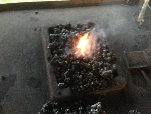

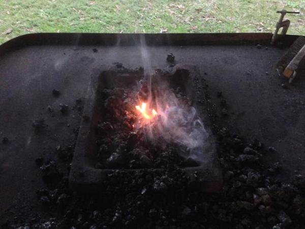

When all I have left is Coke from a previous burn I sometimes throw a bit of coal in about half into filling the firebox with coke. Somehow this either helps there to be some flames or maybe it just allows you to see some smoke that let's you know that you are making progress. Usually there is plenty of coal mixed in with the fused coal/coke chunks that this is not necessary. here is a pic that might help

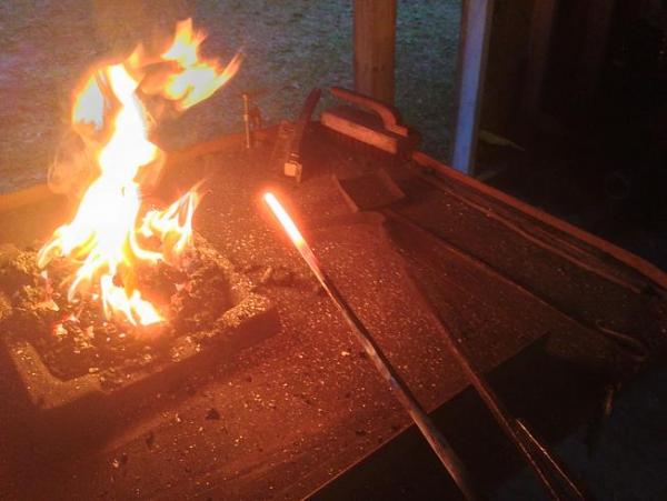

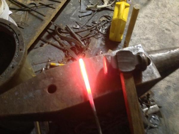

So the vid shows you pulling out what looks like a very nice heat. But the video does not show how to do this. This is typical of videos. No one really wants to watch a piece sit in the fire. I think part of the problem is that it's difficult to show the details of what you see in a good fire using video. The colors and details are hard to see in a video. And as I ponder my own question and think about the 4 or 5 different coal forges I have used there are a lot of variables with just the forge itself, air flow, fire pot size and shape, hand vs electric blower not to mention so many other variables already mentioned. I am not even sure it is truly possible to answer my question without considering all these variables. I guess I have been a little frustrated in my lack of knowledge and experience. After two years working this as a part time hobby I feel I am beginning to learn how to operate my own forge. My inability to do this in the past has cost me a lot of time heating and extra hammering. So any way we can help others get this quicker is a good thing. As others have said elsewhere you probably need to find someone that knows how to do it and how to teach it first hand and not in words. -

so i have heard we should bank a bunch of coal around the firepot. So that means semi large piles of coal piled up on the sides. This makes coke. And we should wet it so it doesn't burn away... Then the coke formed ... Which we rake into the fire and bank back up. This also provides a wall of insulation on the sides to keep the heat in. Well this works.. But I find this to be a lot of bother and waste and it makes it harder to see the fire. So I say that realizing I don't know what I am doing. Glenn mentioned the "fire ball". That is a new term but I think it really has some useful meaning. Glenn please xplain more! Well, I have been experimenting with not banking but rather just sprinkling enough green coal on top of a hot fire every heat. Or every other heat depending on how much metal you are heating. I can even sprinkle more where needed in order to keep a mature fire hot on top and high enough to put the metal into for quick heat both top and bottom. There is always enough flame to burn away the smoke. My forge "area" is cleaner meaning I don't have mounds of coal banked all around and I have morespace. The size of your coal makes a difference. I don't have coal on the sides of my forge fusing together into a brick. I don't have to poke and prod and disturb my firepot to use the banked coal as fuel by dragging and breaking it apart. Usually, for me this disrupts the whole fire and you have to wait for it to recover. Poking, prodding, and tweaking the fire pot which cools everything and can also make the coal stick to the metal and cool it is no longer necessary. I can see the "ball". I think??? I can control the ball better??? I can keep the ball white hot if needed, easier.. Glenn, tell us about the "ball" -
I ain't gonna mince words so here goes. IF YOU CAN'T MAXIMIZE THE HEAT WITHOUT BURNING... TOO MUCH... IN YOUR COAL FORGE THEN ALL THIS "ONE HEAT" TALK IS POINTLESS! in my humble opinion there is not near enough talk, pics and so forth about how to "manage" your coal forge in order to deliver those awesome heats that allow you to "Start out" with enough heat to really make things happen with the hammer and anvil. Now you can peck away at things at a mediocre safe heat but this makes life hard (and progress slow) when all you may need is a small tweak to how you "OPERATE YOUR FORGE" in order to really be able to move hot steel, at maximum temp, with minimal effort. Brian has said it doesn't take minutes to heat metal but rather seconds. Brian if I have quoted you wrong please correct me. But I am beginning to agree though understanding how to do this is not something I have seen on this forum. Doesn't mean it isn't here. As I experiment and go through LENGTHY trial and error I am learning... Slowly.... But even if it is in this forum I bet it is NOT in an easily digestible form for most of us. I recognize that it may not be easy to make this easily digestable. BUT. I challenge all of us to figure out how to make it at least more or less digestible... soonish. Now there are always many variables. This makes this subject hard to discuss. But we really IMHO need to breach this subject. I hope that this particular topic will become one of the threads that we send all new smiths too in order to learn about fire control and heat. In other words "HOW TO OPERATE YOUR FORGE"!!!! I have a few thoughts as a ~2 year amateur with some pics and comments. But it is late. Rest assured I will be bringing this up some more... Possibly often.
