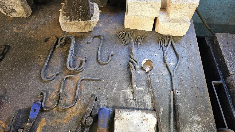

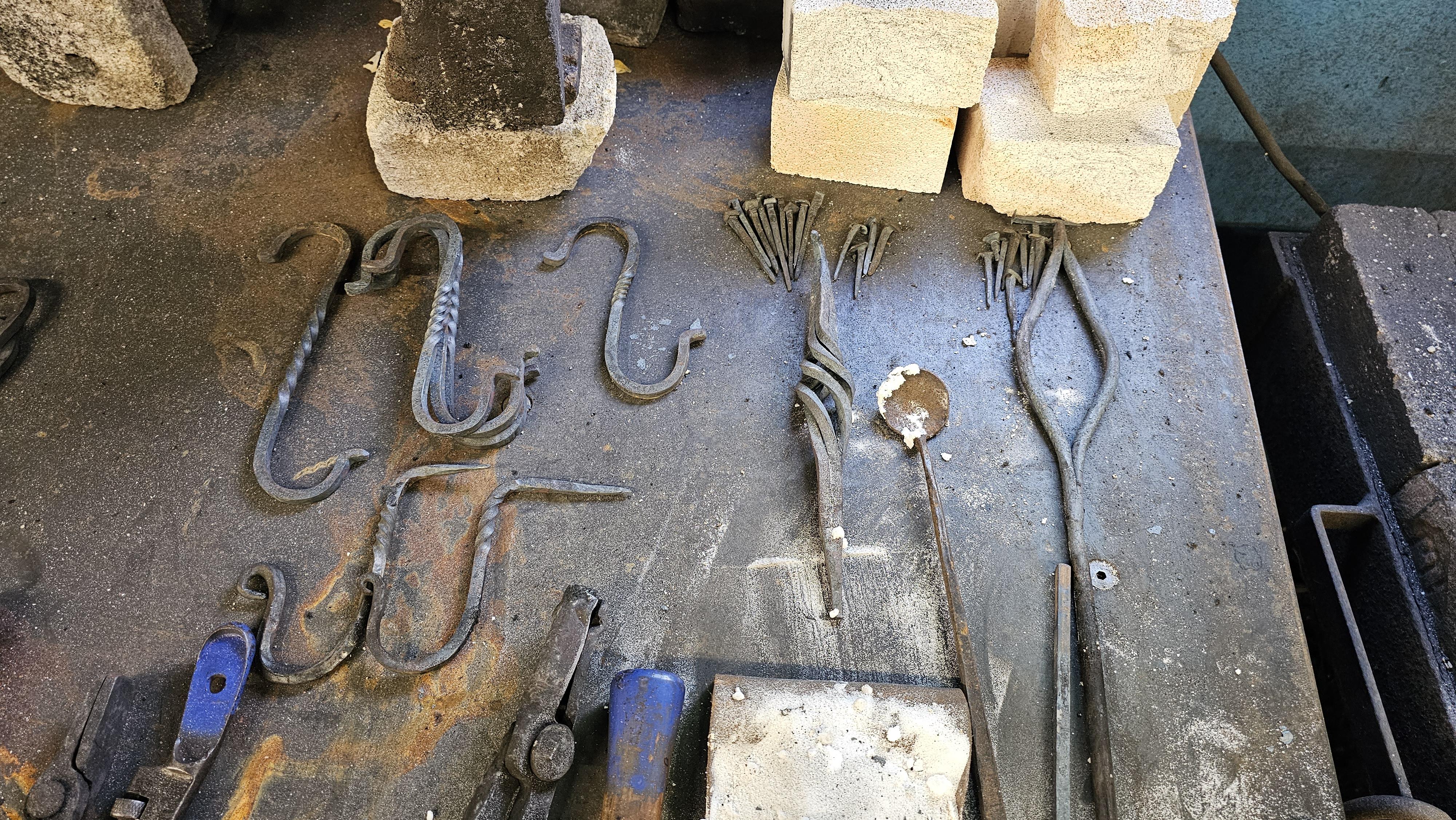

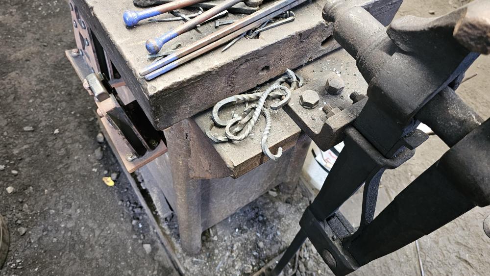

Here's a bunch of photos of students work and a few of my demo pieces and some tools up to day 4.
These gals and guys ranged in age from 16 to 65 and have been crushing it.

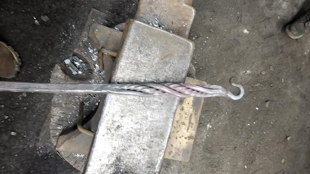

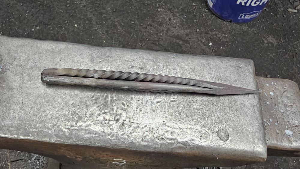

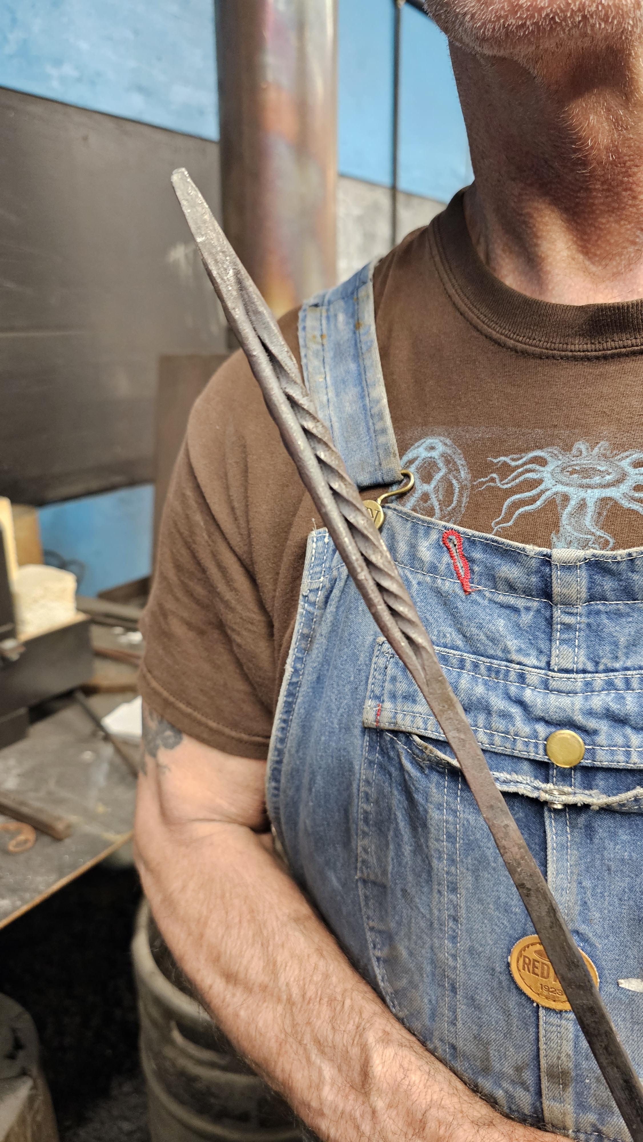

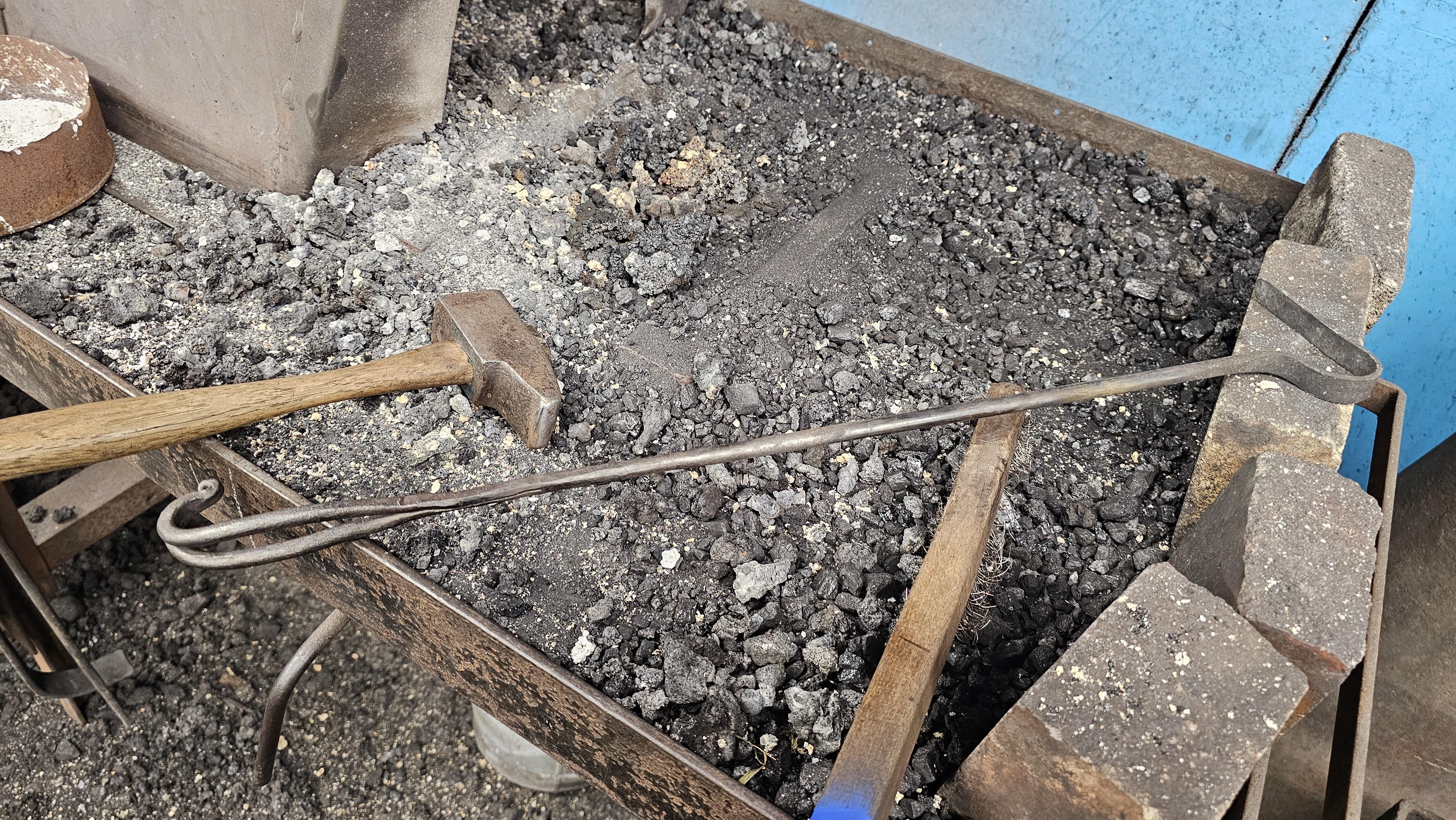

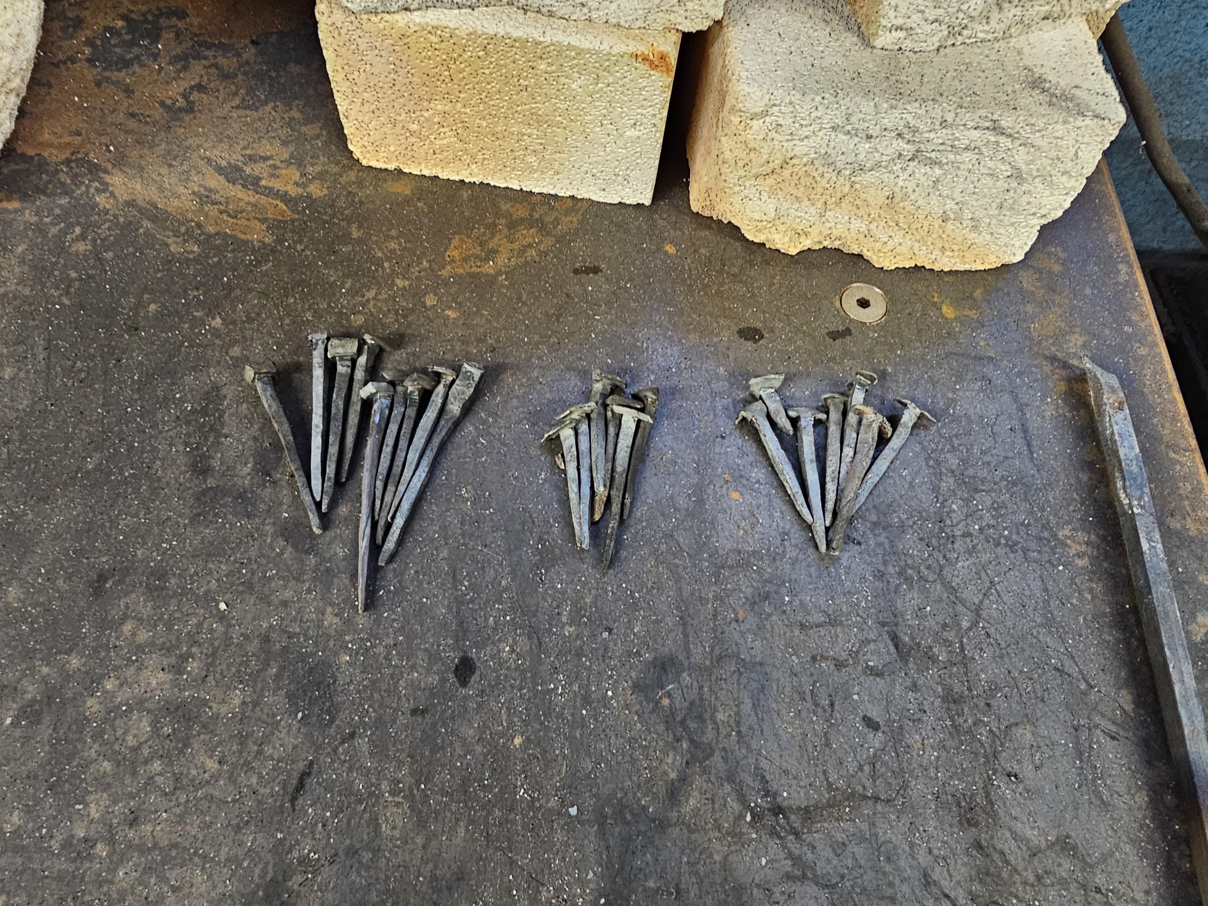

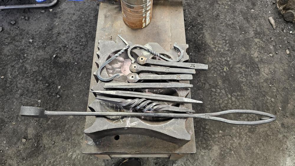

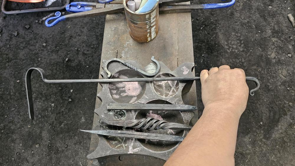

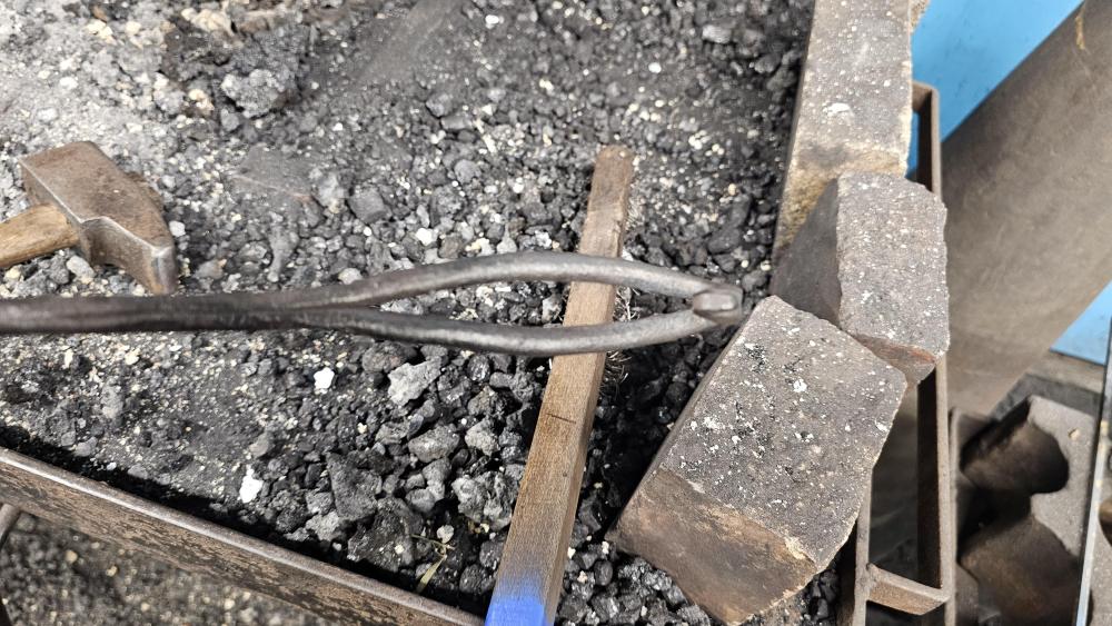

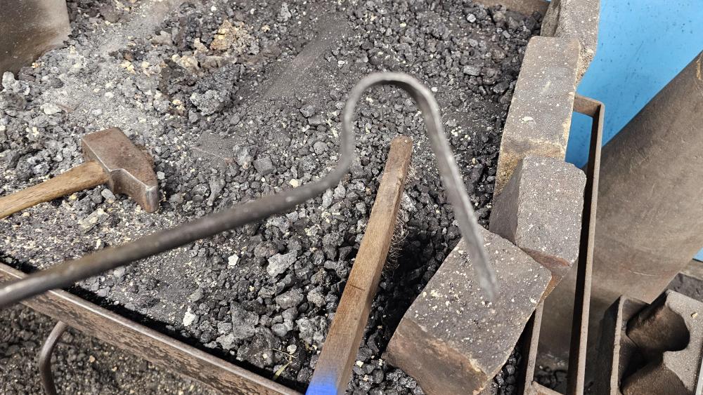

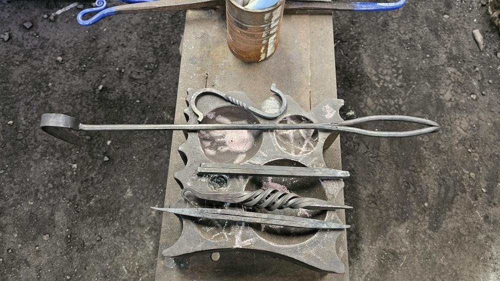

4 days to get a drop tong welded multi directional basket twist handled fireplace poker.  Not possible you say........

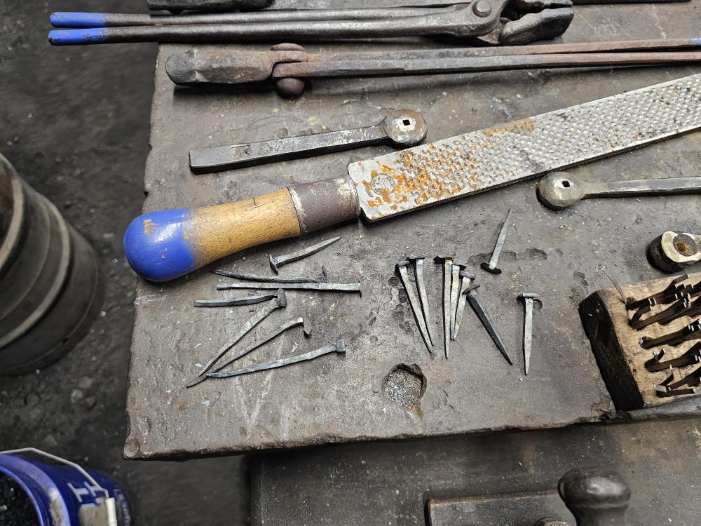

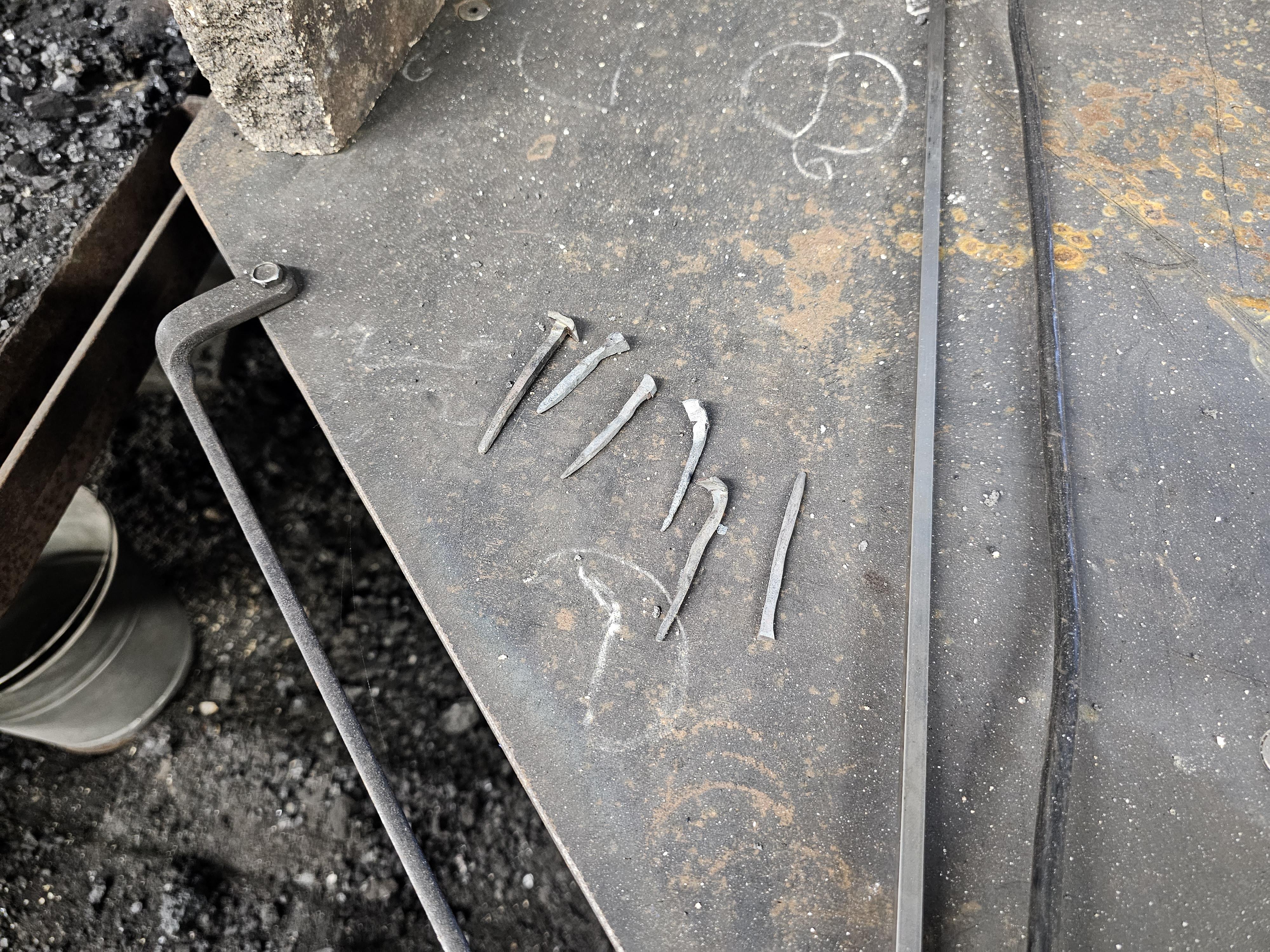

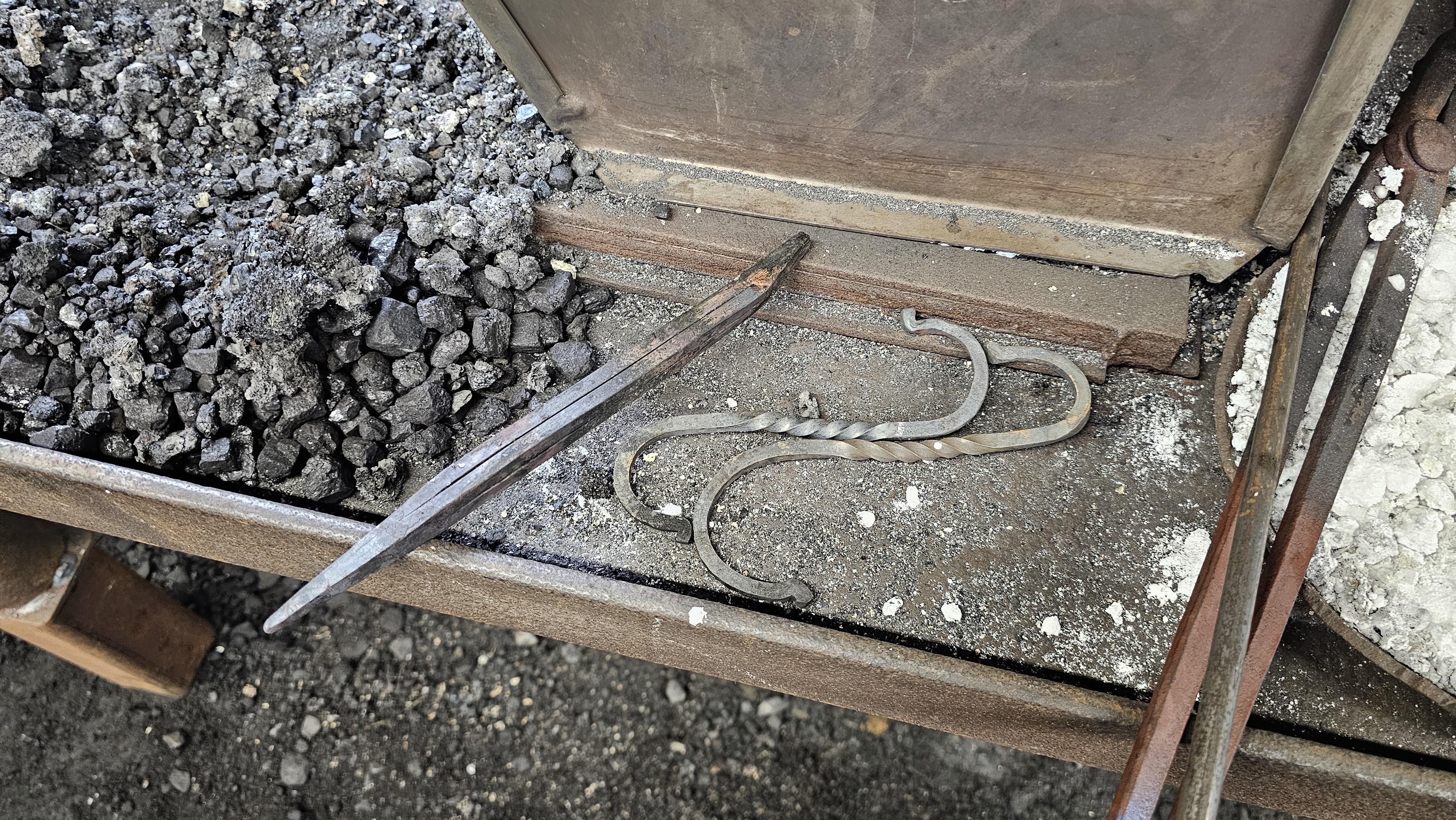

Day 1 nails (pyramid, rose head, and T heads, day 2 nib finial S Hooks, day 3, 4 bar icicle (free hanging basket twist) and welded side rake.

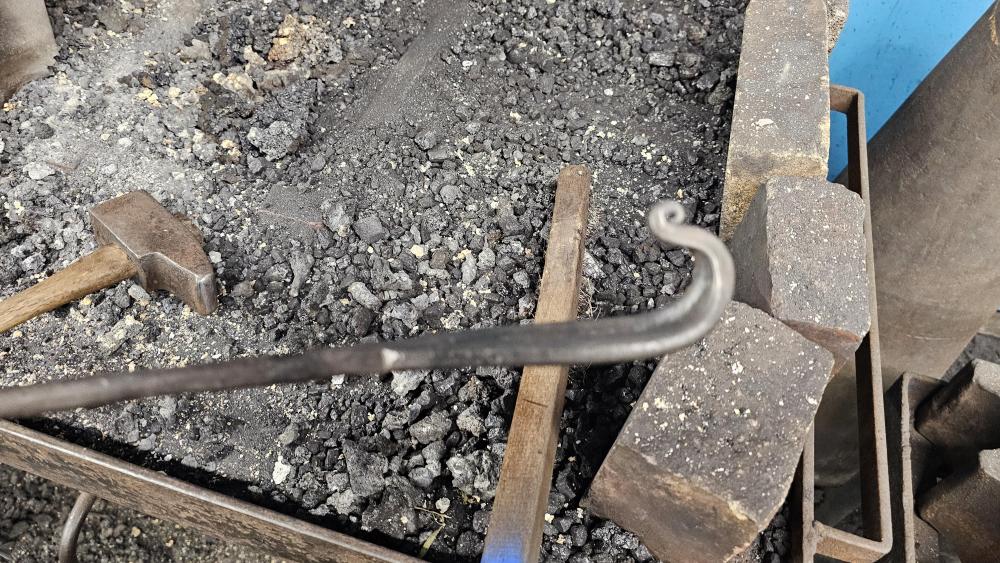

Day4,  multi twist Blacksmith basket twist fireplace poker (drop tong).
4 of the students completed the drop tong welding process as of day 4.

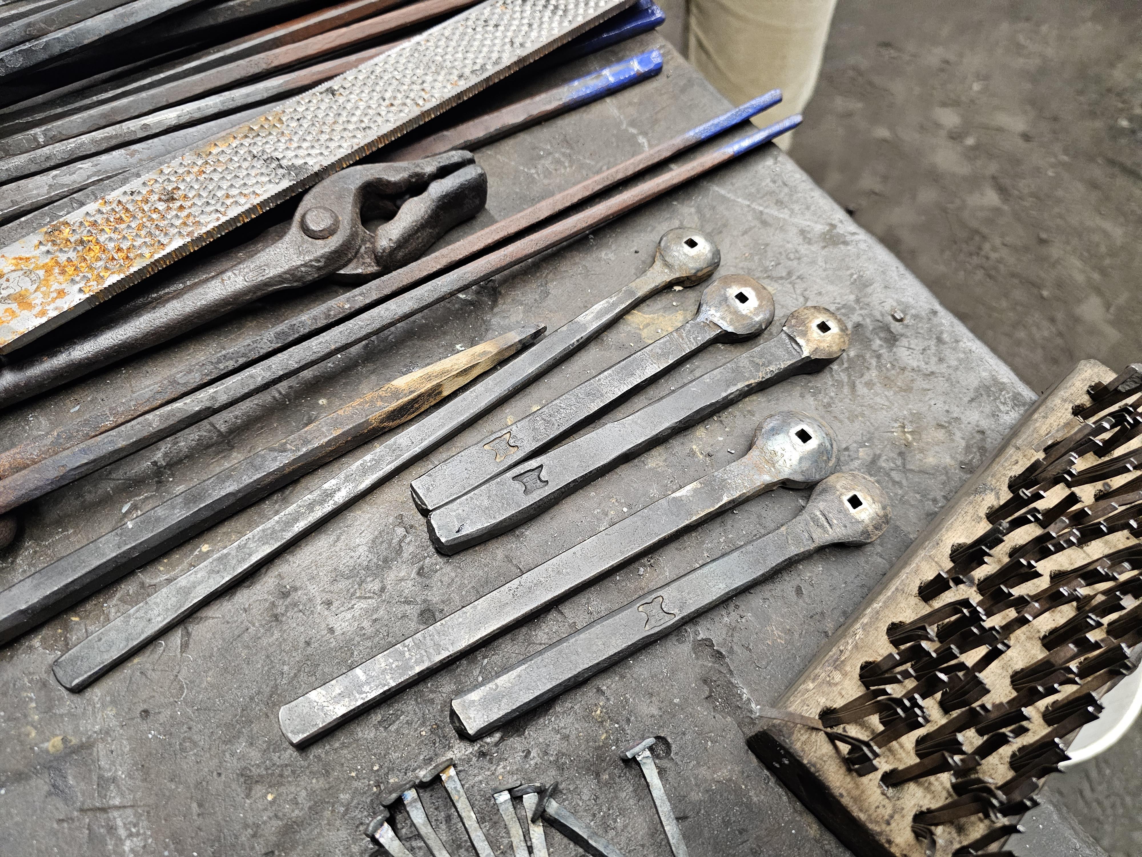

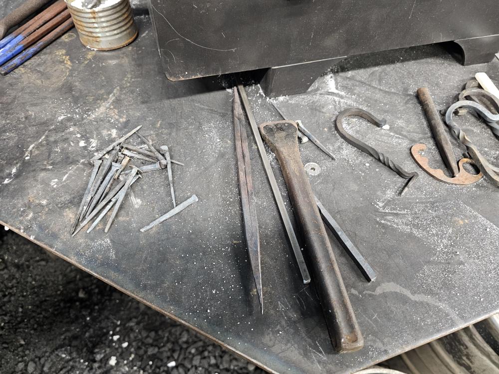

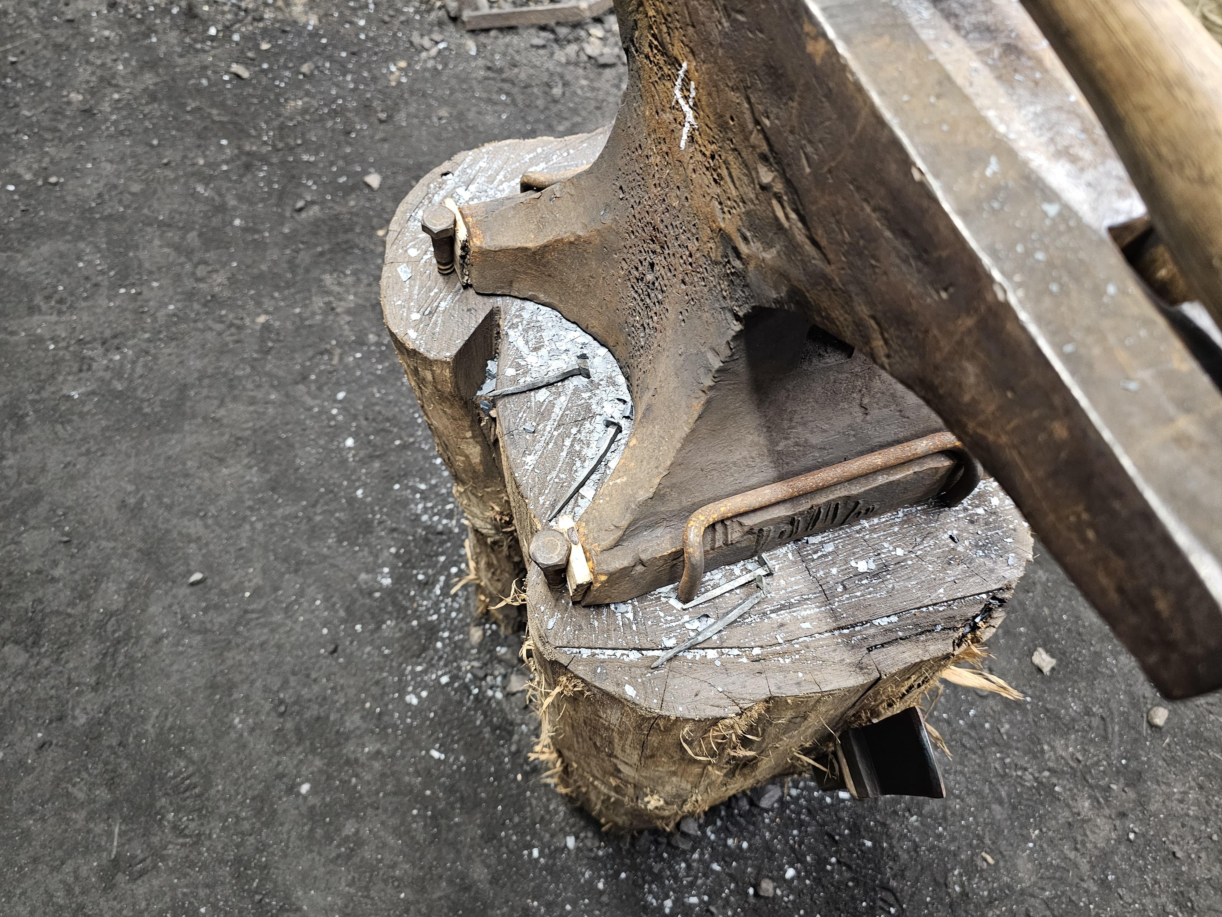

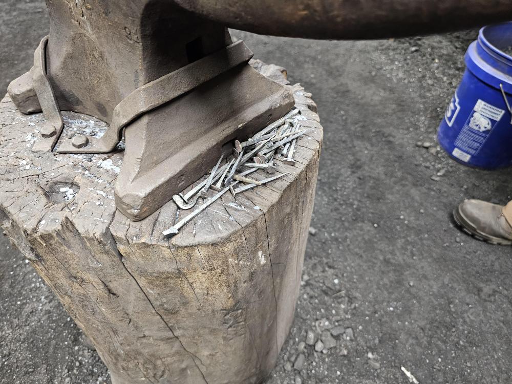

Gave a lesson on nail header maker to the assistant on arrival day. Forgot the nail headers at home.
We made 6 nail headers from coil spring in 2hrs. .

This looks like an excellent course! I love that you started with nails and I've always loved that you consider forge welding to be a beginner skill.
This is gonna make me seem dim, but I didn't realize there were different kinds of nails, lol
I've found your videos on nails and saving them to watch over my lunch break.

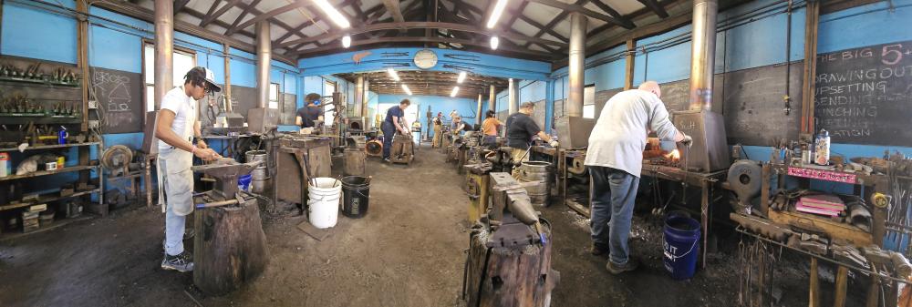

That one picture with all the students at the anvils, really shows the scope of the school you have built. Fantastic job and I'm n awe for all the work you have put into it Jennifer. Wish Debi & I were closer we would take classes till the cows came home.
Randy
I can't control the wind, all I can do is adjust my sails.
I can clearly see 9 forge stacks from the position the picture was taken, is there another hiding in the far left I just don't see? How many forging stations does your school have in all?

I am really taken with the basket twist in the little video, someone has a great eye and hand.

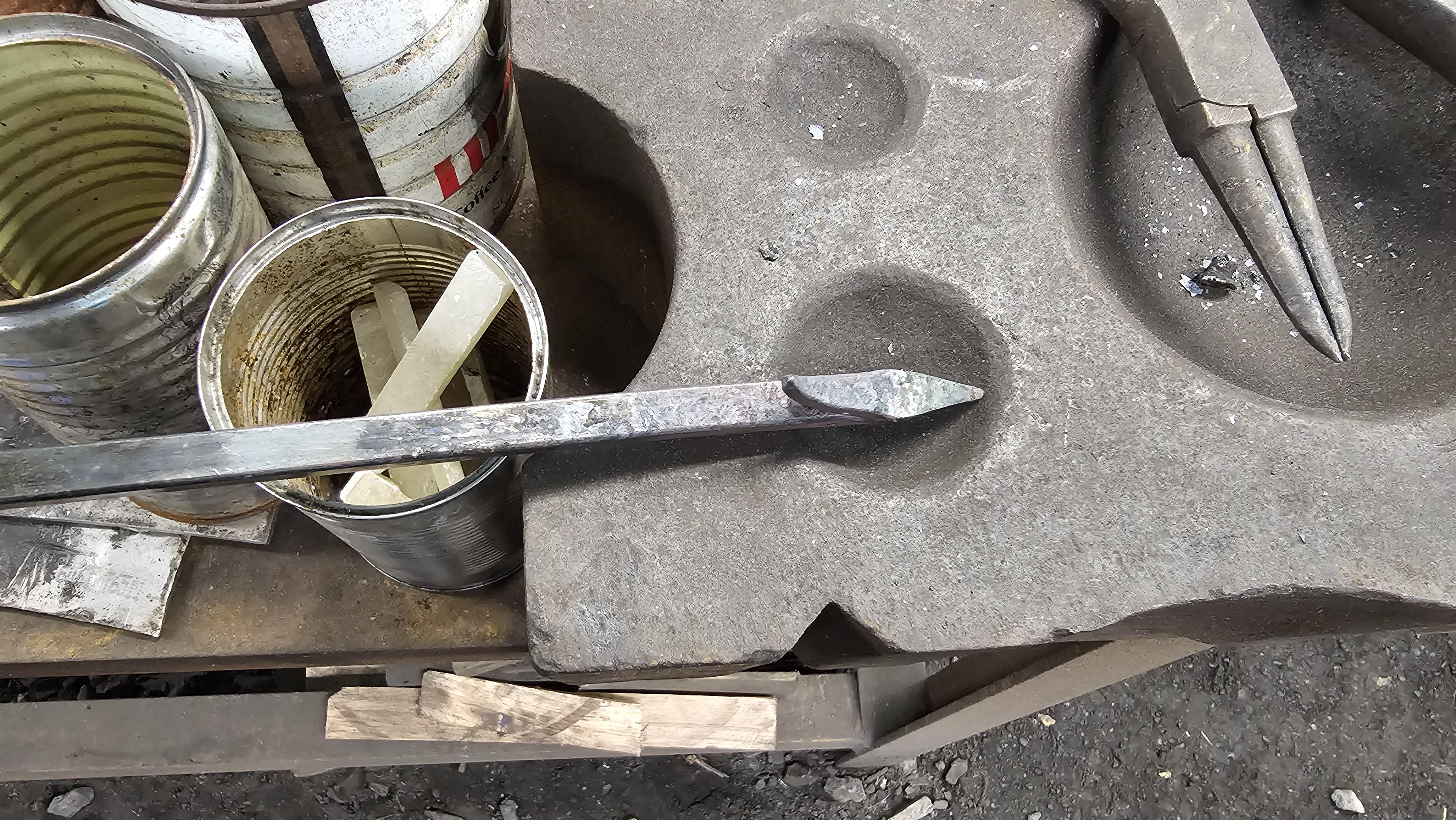

I gave lectures, show and tell on any subject that came into view..  The coal forge care and maintenance was terrible..    I finally got a little tire of people running their forges hollow to weld in so stopped the class and brought them over to see what happens in a coal forge and where the oxidizing, neutral and carbonizing aspects of a fire were and the reasons why we keep coal banked and constantly creating coke..

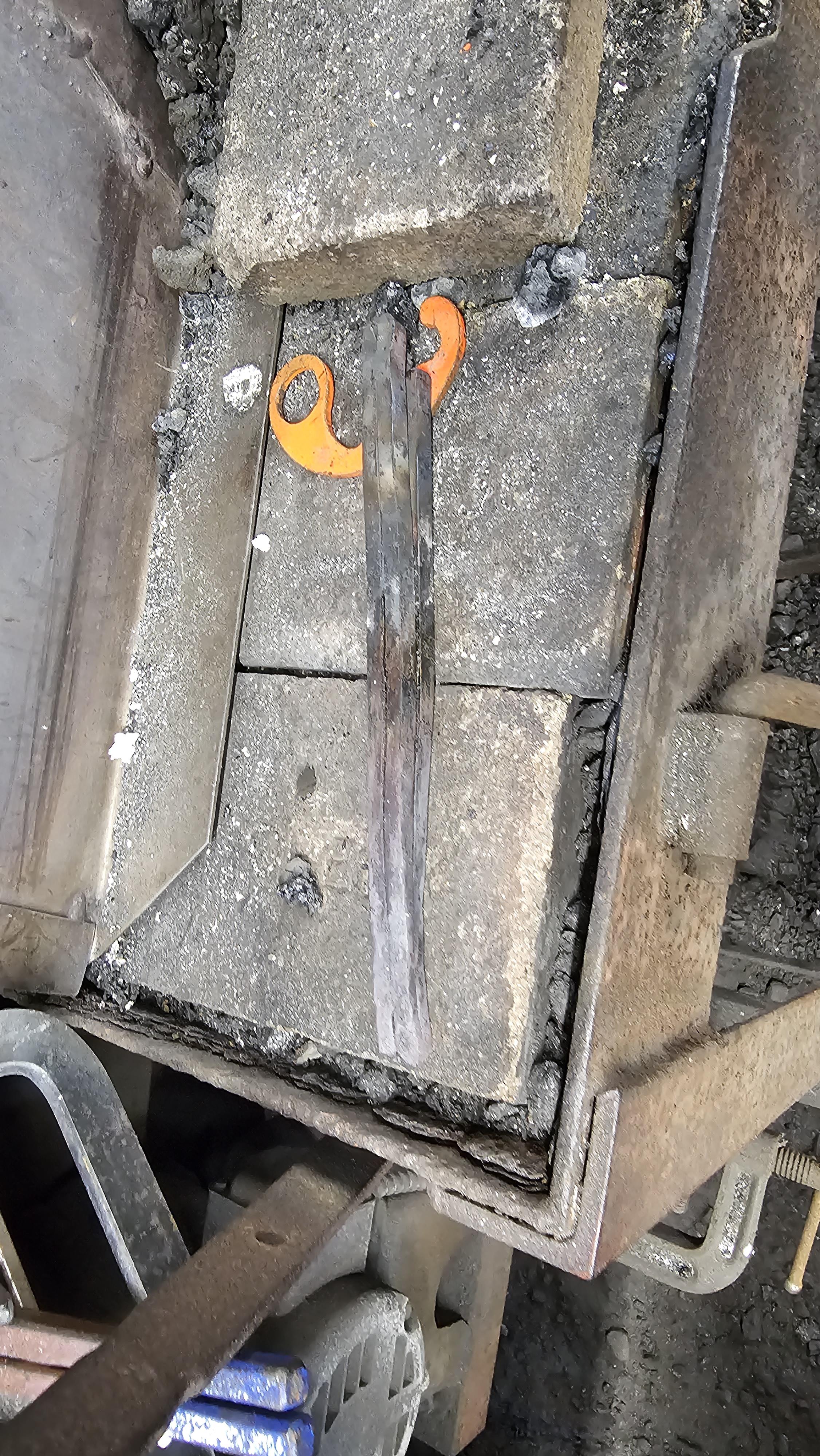

They all loved that..   1/4"sq CR all brought up to welding temps in an oxidizing, then neutral, then carbonizing parts of the fire..   They were surprised how much it sparked in the oxidizing zone..     Then the bar would not throw sparks until removed from the fire in the neutral zone, and in the carbonizing zone it took longer to get to a welding heat but the sparks were crazy lively..
They were also very surprised how thoroughly the bar picked up carbon once in the carbonizing zone  and these 200lbs guys could not bend that 1/4"sq piece  after it was hardened in water.
I snapped sections off to show them grain growth and why it's not good practice..     I then notched the bar I had done this to, about 1" long,  forge welded back in this section and from one welding heat.. Letting it cool to a dark red color forging it brought it back to orange color by hammer work and forged out a nice longer taper.
I then snapped this newly forged taper every 1/4"  and showed them how forging refines the grain structure.       The part that was forged from that dark red when hammered brought it back to about orange..
It was ductile enough to bend it cold in the vise using the hammer into a rat tail shape.   I then snapped off the pieces and showed them the difference.
Shaina, they made thousands of types.      More types of nails then they make today in fact.    Of course, a screw is a screw except for the bit used to drive it..  That is maybe the largest difference..   Back then a slot screwdriver and square wrench
