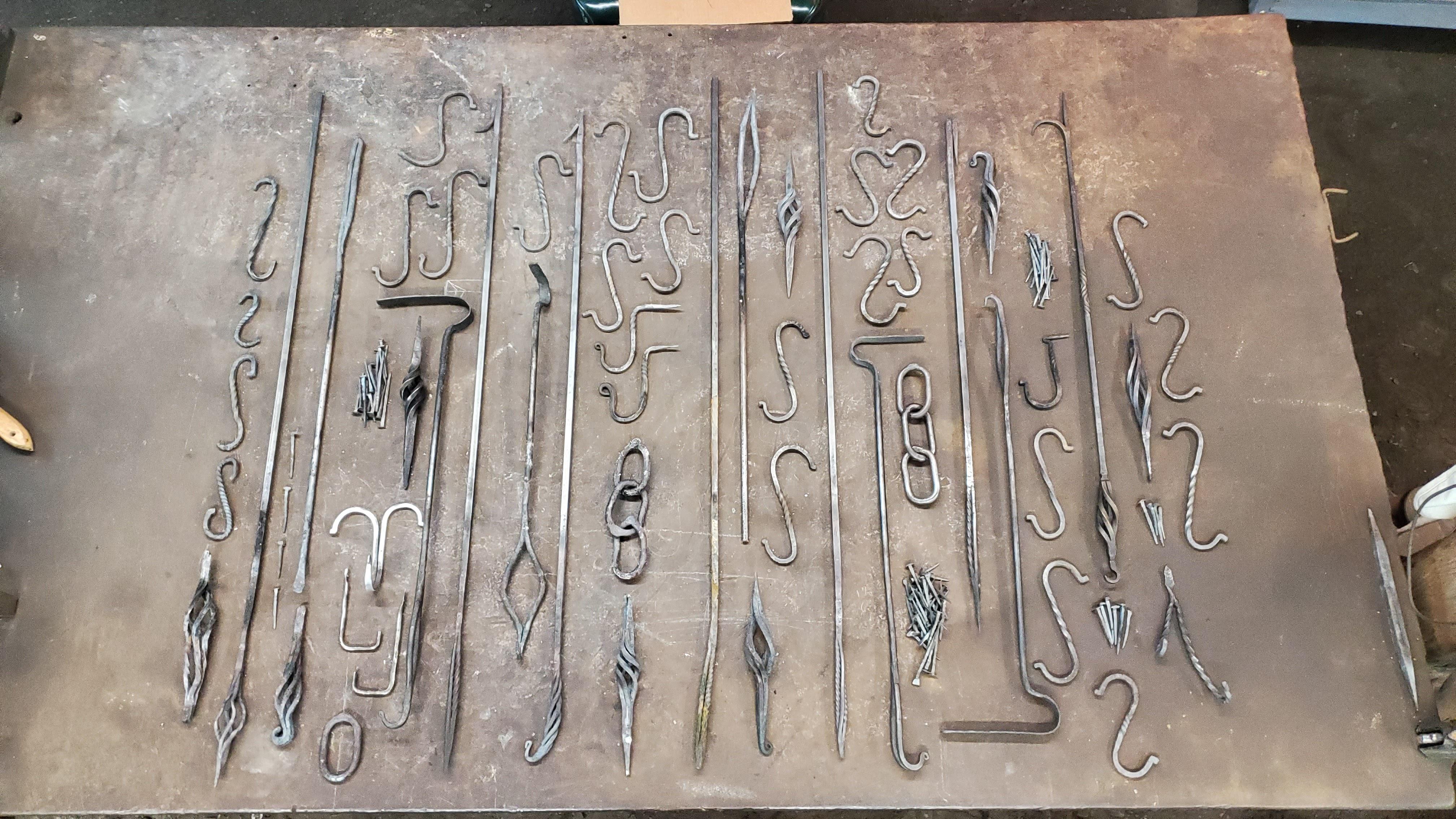

jlpservicesinc Posted August 5, 2023 Author Share Posted August 5, 2023 So here is the samples of the items the students covered. I auctioned off the samples I forged for the students to see. The video is of one of the students whom never forged in his life. This was his first class and this is the morning of day 4.. Interestingly nearly all the students completed their drop tong welds within a few hours of each other. The ladies of the group had a hard time with the longer bars.. Something I forgot to mention is to cut the bar to a comfortable length.. LOL.. Its funny how certain things just seem clear but open to interpretation. I could not be happier with the results of the class.. Few people who had lessons previously were a little tough to get to change their fire management.. a By day 2.. All the students knew how to start their fires and to create a welding fire vs general forging fire.. Was awesome.. 20230731_165722.mp4 Quote Link to comment Share on other sites More sharing options...
