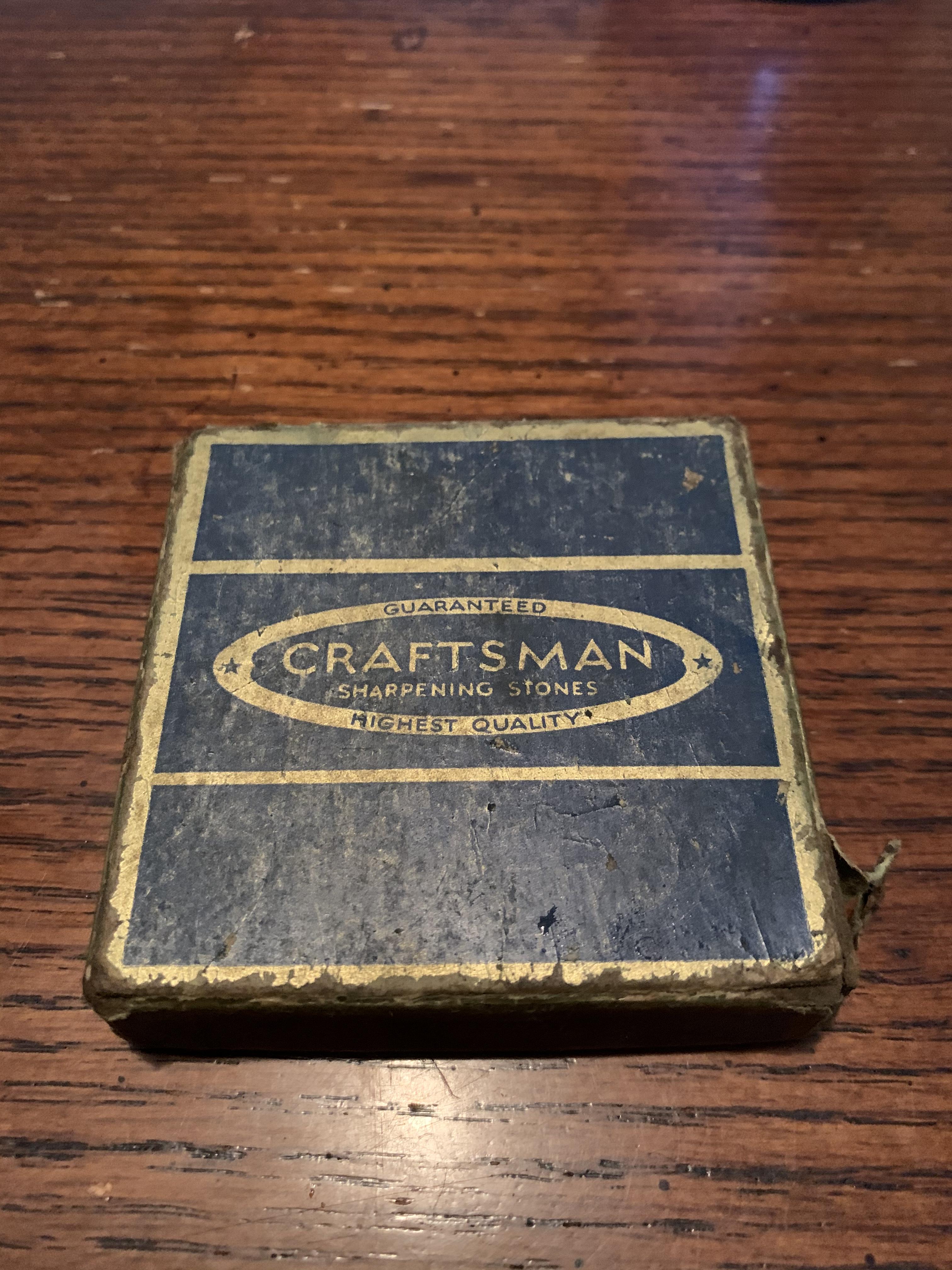

Owen Hinsman Posted July 21, 2020 Share Posted July 21, 2020 I got a whole load of antique brace and bit auger bits, plus a really weird looking hammer thingy and a nice little hatchet. I also got a little Craftsman sharpening stone, which is in good shape. Any idea what the hammer thing is in the back of the first picture? Quote Link to comment Share on other sites More sharing options...
Frosty Posted July 21, 2020 Share Posted July 21, 2020 You have me on the hammer thingy I almost want to think it's for chinking but those usually have short handles. I'd call the small hatchet a roofing hatchet. We used to call round sharpening stones Ax stones. Used in the palm of your hand to sharpen or hone an ax blade in the field. Frosty The Lucky. Quote Link to comment Share on other sites More sharing options...
Irondragon Forge ClayWorks Posted July 21, 2020 Share Posted July 21, 2020 I believe the hammer thingy is a Mill Pick, used for refacing the old millstones. I agree with the roofing hatchet for working shake singles. Quote Link to comment Share on other sites More sharing options...
JHCC Posted July 21, 2020 Share Posted July 21, 2020 Mill pick was my first thought as well, although the handle is rather long. Quote Link to comment Share on other sites More sharing options...
Farmall Posted July 21, 2020 Share Posted July 21, 2020 I believe it is a mill pick. see http://trowelcollector.blogspot.com/2015/12/millstone-tools.html Quote Link to comment Share on other sites More sharing options...
Frosty Posted July 21, 2020 Share Posted July 21, 2020 Looks like a mill pick on a too long handle to me after watching a couple videos. Holy Moly dressing a mill stone is a lot of work! Frosty The Lucky. Quote Link to comment Share on other sites More sharing options...

Owen Hinsman Posted July 22, 2020 Share Posted July 22, 2020 Thanks for ID-ing the mill pick. I got it for like $15 bucks and I was going to turn it into a handled hot cut. Also, it appears that the ax stone has been used with oil because water slides off. Can I clean it? Quote Link to comment Share on other sites More sharing options...
ThomasPowers Posted July 22, 2020 Share Posted July 22, 2020 Yes, what's your favorite solvent for oil and grease? Quote Link to comment Share on other sites More sharing options...
Irondragon Forge ClayWorks Posted July 22, 2020 Share Posted July 22, 2020 I clean mine with WD-40 and an old tooth brush, then wipe it good with an old T-shirt. Only have to do that if the stone starts to get clogged up, which doesn't happen if it well lubed while sharpening. Looking at the picture of yours it doesn't look worn or clogged. Quote Link to comment Share on other sites More sharing options...
ThomasPowers Posted July 22, 2020 Share Posted July 22, 2020 I generally use WD-40 as a honing oil. Quote Link to comment Share on other sites More sharing options...
Frosty Posted July 23, 2020 Share Posted July 23, 2020 WD 40 is a good oil on a stone as it's more of a solvent than oil. Lube on a sharpening stone's prime function is to keep cuttings from the blade from jamming between particles in the stone, once full a blade will slide on the cuttings and not be ground by the stone. I use water on the stone in the kitchen and 3 in 1 for it's litter mate in the shop. The wrong oil can start to gum the stone up, a big mistake I made on the kitchen stone by using cooking oil, it polymerized and turned it into a seriously non-functional sharpening stone. I soaked it in gasoline, let it air dry for a week or so then ran it through a few cycles in the dishwasher. Using it with water means if I start seeing signs of it loading with knife cuttings it goes into the dish washer and comes out ready for action. Frosty The Lucky. Quote Link to comment Share on other sites More sharing options...
