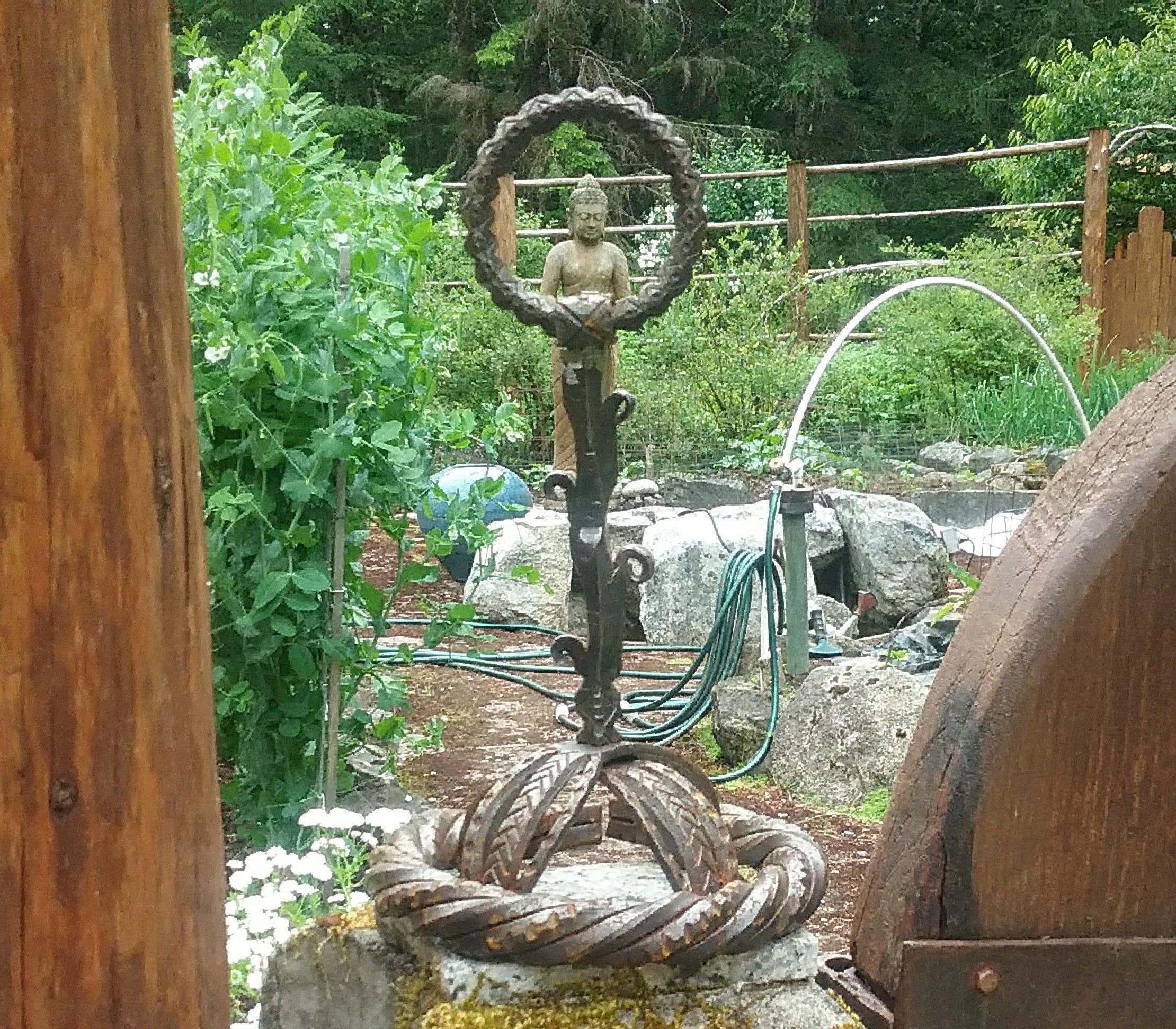

Garden before wind, rain, general grey nastiness.
Very nice sculpture.
Its hard to guess the size of it. What size is the square stock at the base?

Even if they are around 1"  square bars I am impressed with that bundle twisted and looped.
  I agree.  That arched section of the base is pretty cool too.

1 inch square stock base ring.

Flat stock chisel split & expanded, ends incerted into slots   (mechanical joint)

I like that a lot. Lots going on there. Any idea on the weight of it?
Ken, very impressive and I catching.  I am wondering about some of your techniques and tooling.  To twist a number of 1" square bars together like the base would take some pretty hefty equipment.  I also suspect that you use a good size power hammer.  How did you make the cuts for the curls in the upright portion?

Sorry, not very clear. The base is 1 inch square stock, not hard to twist with a long, deep heat, double handle monkey wrench, pipe to contain and stabilize the stock. Vertical is 3/4 square stock, curls chisel cut supported in leg vice. These are all Yellin elements, I think, or that is where I remember seeing them. He was a great one to seek out older stuff and make it his own. What we all do. Hard to be original except in the way elements are combined. Like music or any art/craft.
OK, thanks.  I was way off on scale.  I thought the base was several 1" bars twisted together rather than one 1" bar that was notched on the edges and grooved down the center and then twisted.  Sorry.  It looks like some of the things I saw Francis Whittaker do.  He was one of Yellin's apprentices.  Possibly, he learned it from the Master.
I've seen some impressive assemblies of angle iron and round and sq bars that were arc welded on the ends and then twisted.  Definitely high dollar work!
