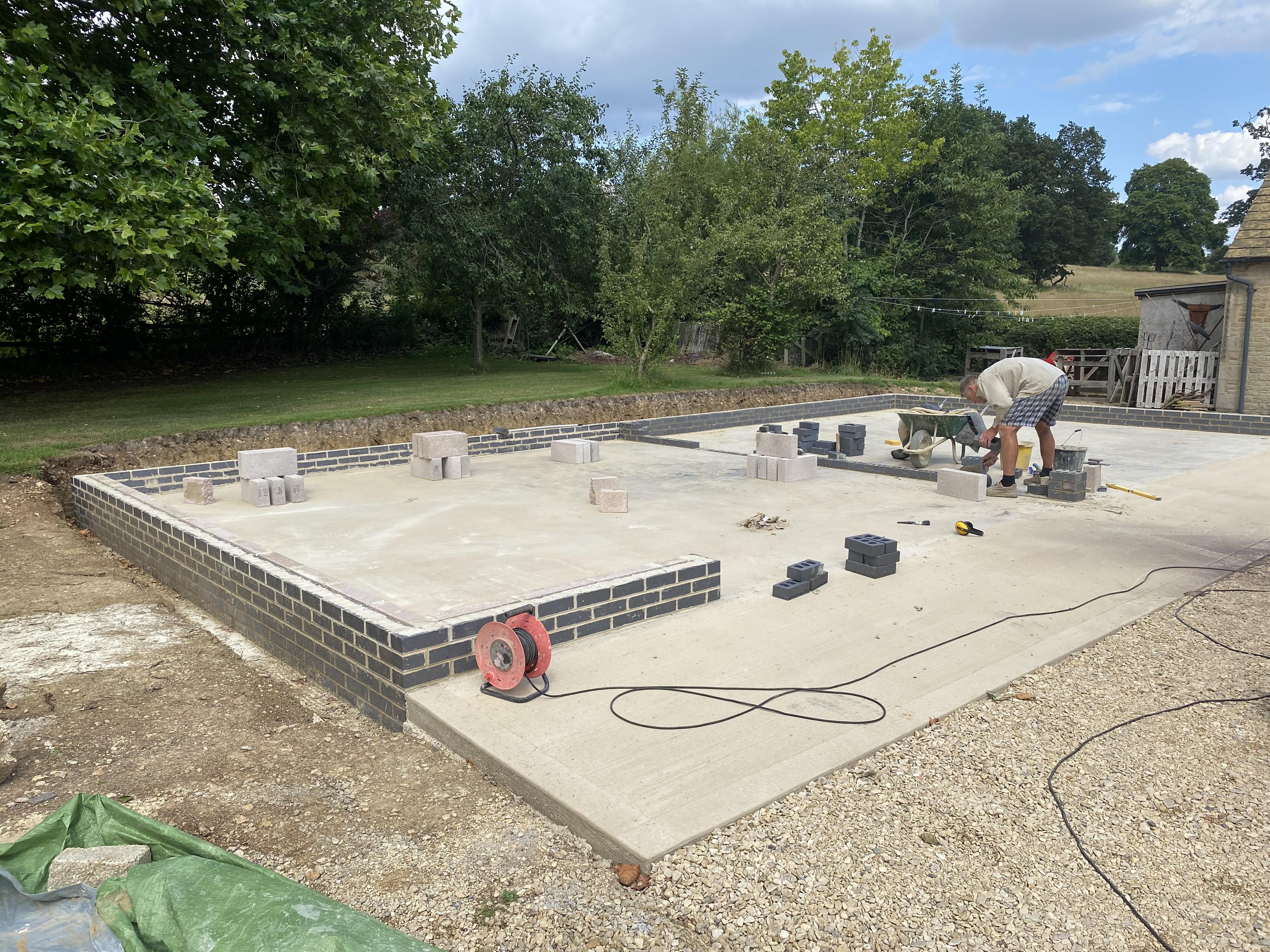

RogerrogerD Posted August 6, 2021 Share Posted August 6, 2021 I’m building new forge and workshop here in UK. Two halves, one “dirty” for forging, grinding, welding, etc, and next to it a metal workshop with lathe, drill press etc. Dirty side with the forge will be open at the front, clean side behind doors and attractive tools stored there to be wheeled out when needed on trolleys. It’s gonna be totally Oak frame oak rafters and oak weatherboard on a concrete pad. The size is equivalent of four bays - two on the right for the forge and two on the left for the clean workshop. The forge side Im gonna try to keep traditional, with my 130 year old bellows hooked up to the forge, and my old smithy stuff. The clean side can be more modern and well lit. This is where we are so far, more pics to follow in coming days. Link to comment Share on other sites More sharing options...

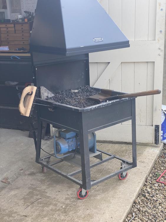

RogerrogerD Posted August 6, 2021 Author Share Posted August 6, 2021 it will have this hooked up to the back, hopefully traditional enough. i’ll hide the electric fan Link to comment Share on other sites More sharing options...
TWISTEDWILLOW Posted August 6, 2021 Share Posted August 6, 2021 That’s gonna look nice! Link to comment Share on other sites More sharing options...

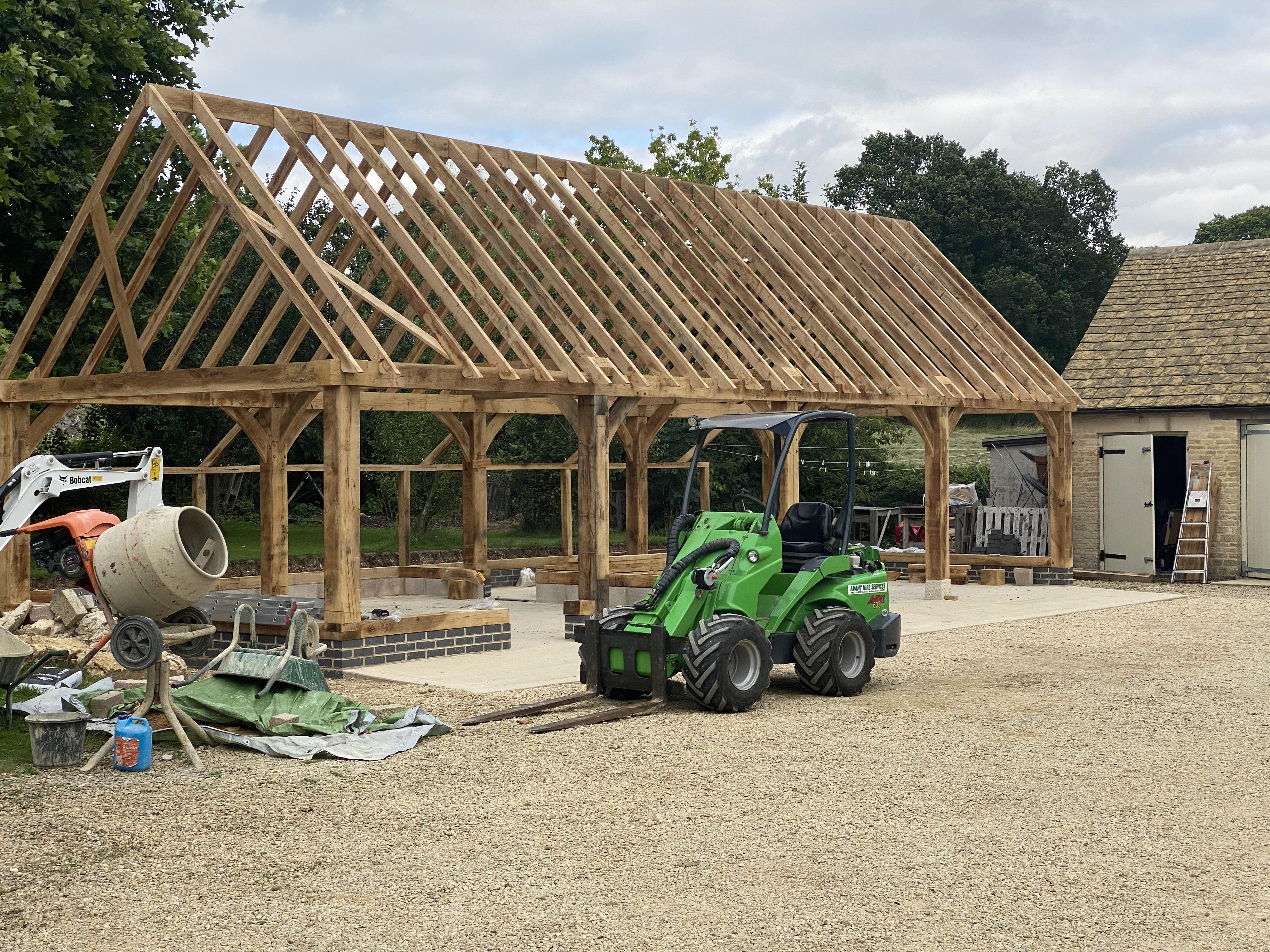

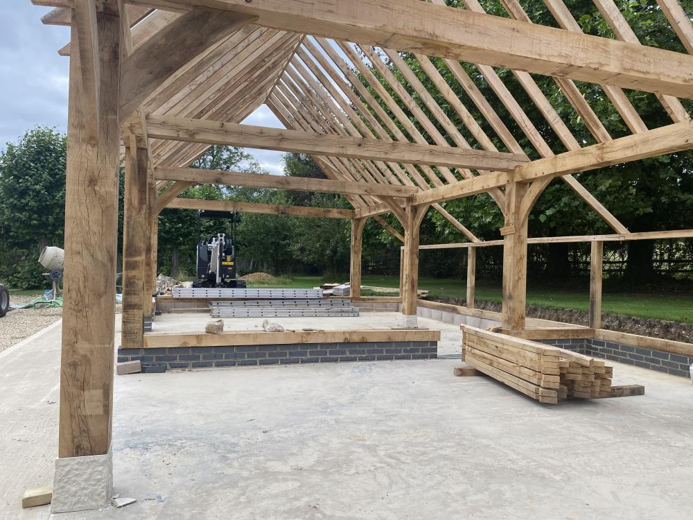

RogerrogerD Posted August 12, 2021 Author Share Posted August 12, 2021 Main frame now up. All oak…. Link to comment Share on other sites More sharing options...

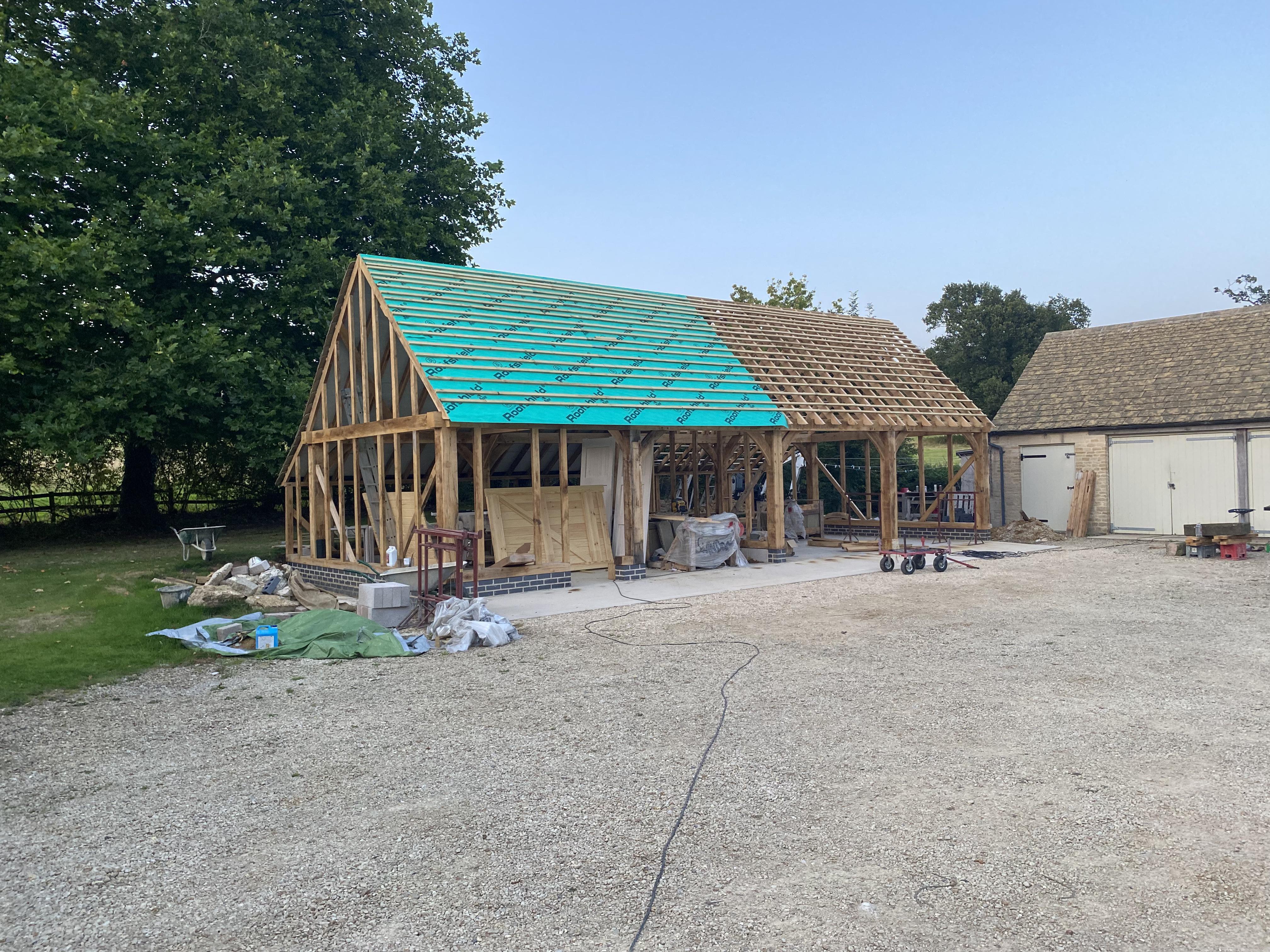

RogerrogerD Posted August 28, 2021 Author Share Posted August 28, 2021 Going up slowly Left side is the “clean” side. Lathe, machine tools, secure. Right side the “dirty side”. Forge, bellows, welding and grinding. Link to comment Share on other sites More sharing options...

RogerrogerD Posted August 29, 2021 Author Share Posted August 29, 2021 thank you. Running in a single phase 240V 40A through a buried armoured cable. My lathe will be run off a digital inverter. I intend to install a compressor for air tools, using 15mm copper pipe, because I hope it’ll look better than blue plastic pipe against the oak. You’ll note the left hand side has roofing felt but the right is deliberately without. You’ll see the underside of the tiles on that side - trying to make that side a little more traditional looking. At the far end, right hand side will be a lean-to structure for steels stock and forge fuel. Link to comment Share on other sites More sharing options...
