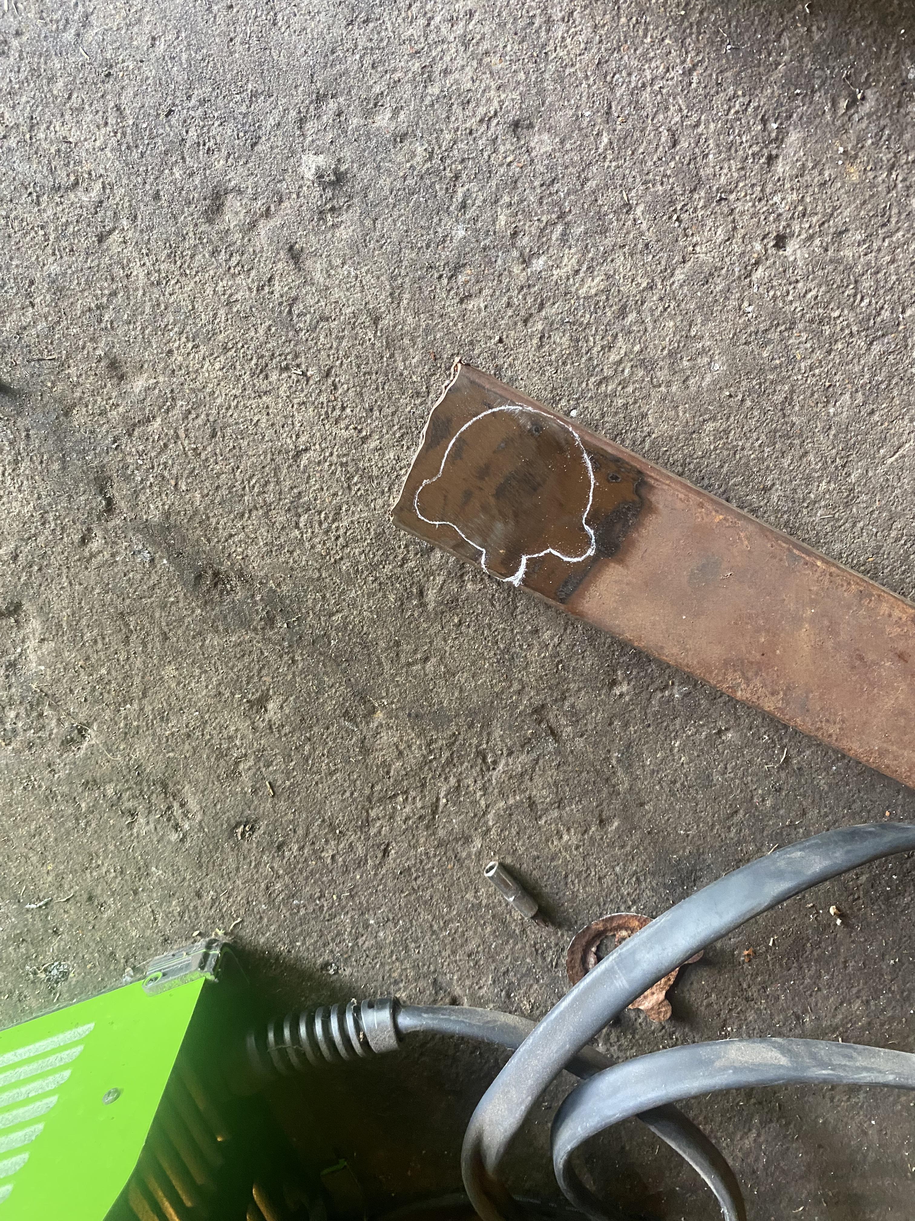

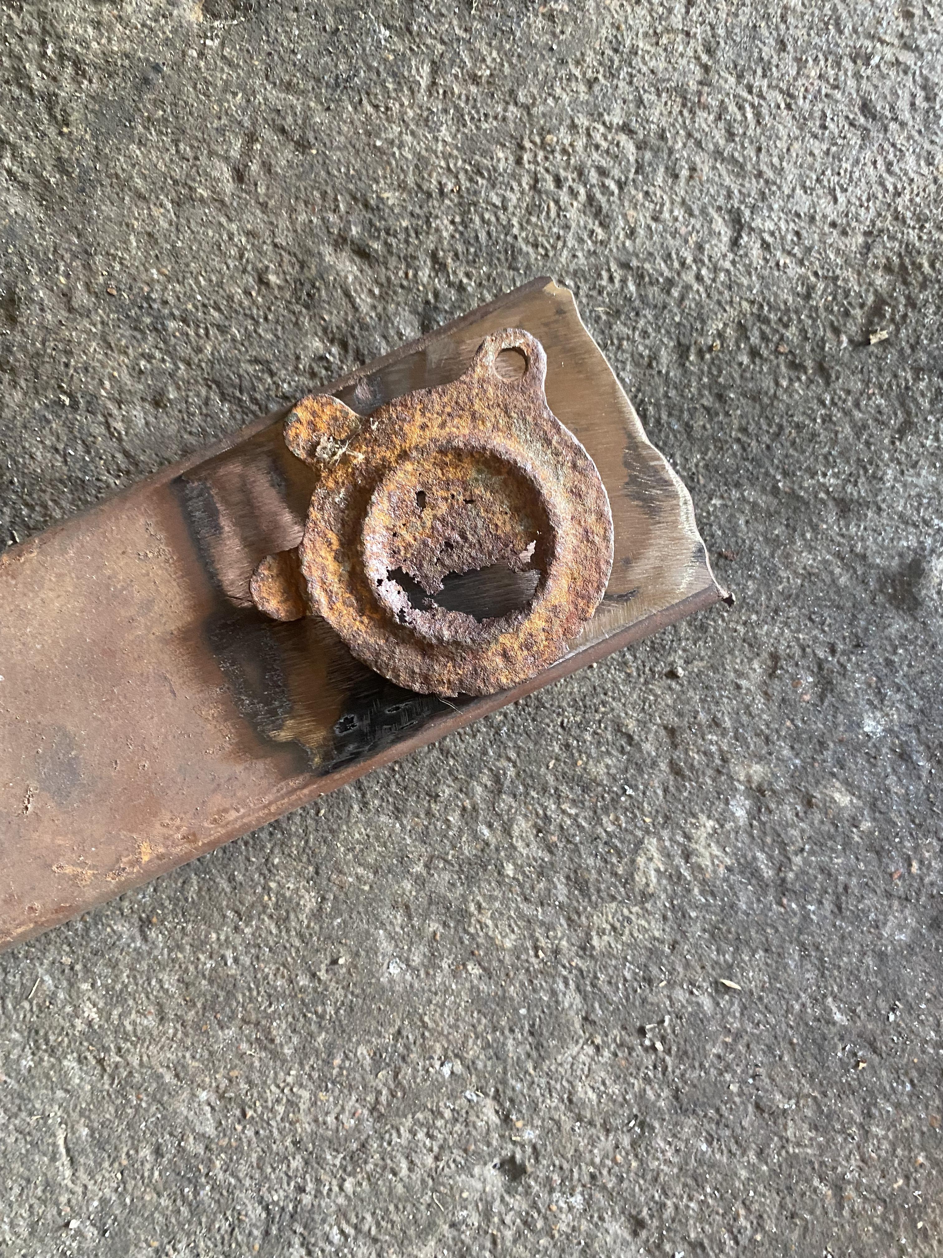

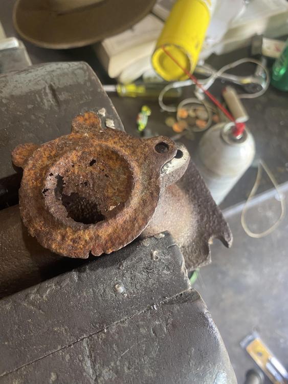

TWISTEDWILLOW Posted June 27, 2021 Author Share Posted June 27, 2021 Makes sense to me Goods, farmall do you happen to still have any pictures of the one you had, also Thats very interesting story about the salesman, mine doesn’t have the handle like the one in the advertisement so I think it has been removed at one point. I worked this afternoon to make a new clean out for it and drill out the frozen bolts. It’s not perfect but I think it’s gonna work. Quote Link to comment Share on other sites More sharing options...

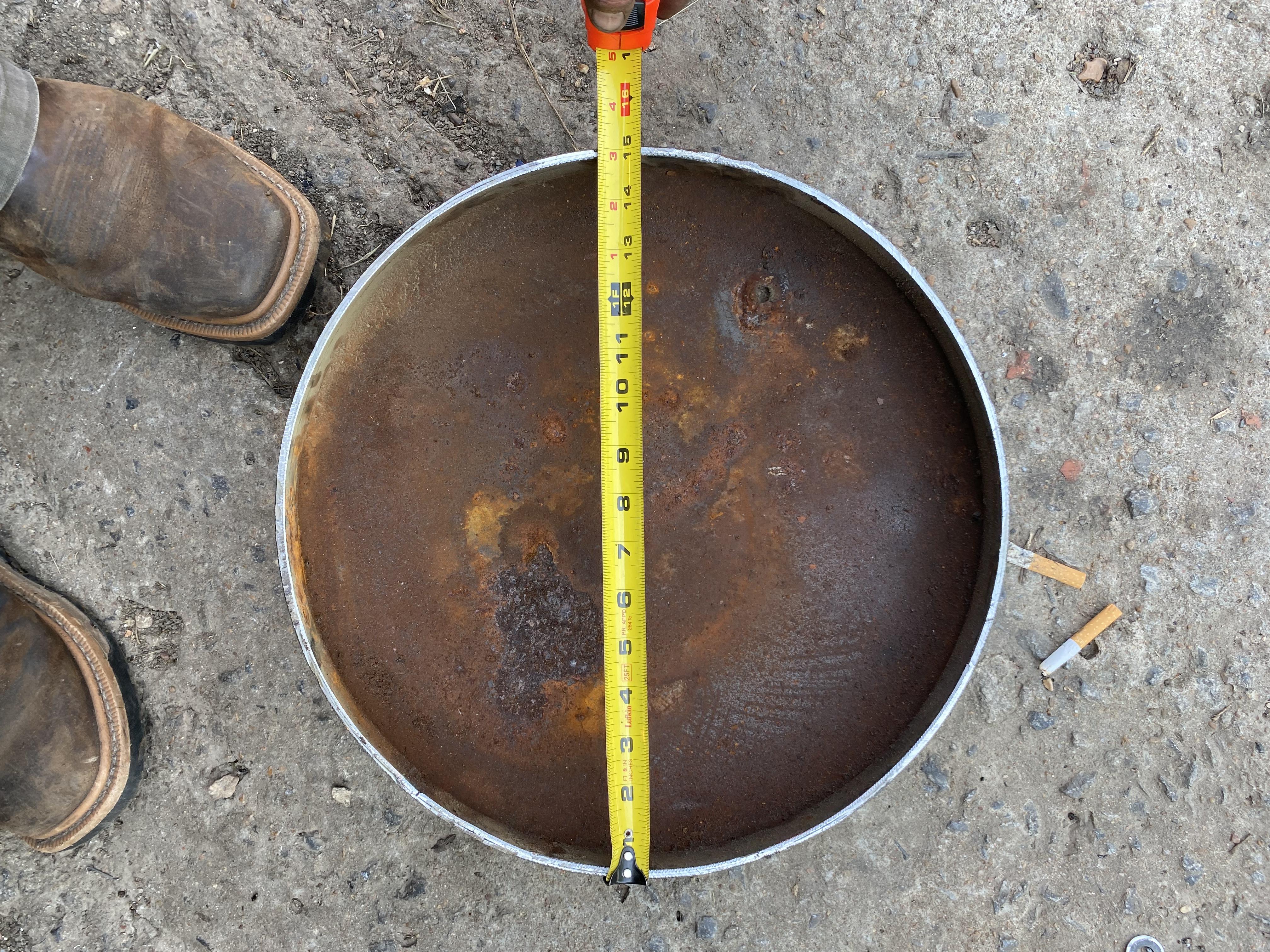

TWISTEDWILLOW Posted July 2, 2021 Author Share Posted July 2, 2021 Asked the guy that hauls my scrap off about pancake compressor tanks and he brought me these this morning! I’m gonna use one to make a forge for the tiny Buffalo Quote Link to comment Share on other sites More sharing options...

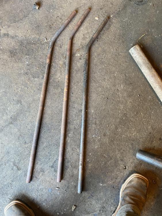

ThomasPowers Posted July 2, 2021 Share Posted July 2, 2021 Now forge some ornate legs for it! Quote Link to comment Share on other sites More sharing options...
TWISTEDWILLOW Posted July 2, 2021 Author Share Posted July 2, 2021 Not really ornate but functional, sucker rod. I’m still working on how I’m gonna connect the pan to the air supply. I’m thinking about using a hole saw and welding a pipe in the forge then have it drop down into the air supply and then cutting a plate out to match it an welding it to the pipe like a flange so I have something to bolt to. Quote Link to comment Share on other sites More sharing options...

Irondragon Forge ClayWorks Posted July 2, 2021 Share Posted July 2, 2021 That is going to be a great little coal forge. Lump charcoal would work but takes some tinkering in a bottom blast and if wanted it could be convertible to a BBQ by adding a grill. You will take some kidding about the cigarette butts, ask me how I know. Quote Link to comment Share on other sites More sharing options...
TWISTEDWILLOW Posted July 2, 2021 Author Share Posted July 2, 2021 Thank you irondragon, I have made a pancake compressor forge before a couple of times and they seem to work out okay, this one is different because of the little blower and air supply so I don’t know how well it’s gonna work but it’s a fun experiment either way, and like you said if it won’t forge maybe it can grill! not sure what your talking about on the cigarette butts so I’ll bite… how do you know? Quote Link to comment Share on other sites More sharing options...
