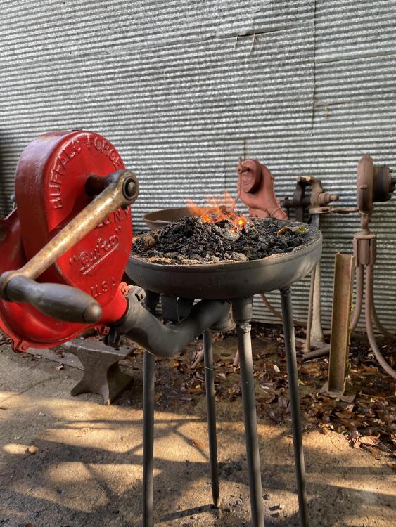

Irondragon Forge ClayWorks Posted August 5, 2021 Share Posted August 5, 2021 Charcoal gray and red is two toned. 21 hours ago, Frosty said: charcoal gray and red isn't multi colored? Link to comment Share on other sites More sharing options...
arkie Posted August 5, 2021 Share Posted August 5, 2021 I don't care what they say, it looks good! Link to comment Share on other sites More sharing options...
TWISTEDWILLOW Posted August 5, 2021 Author Share Posted August 5, 2021 Thanks arkie! Irondragon, I like the sound of that! I know it doesn’t change the functionality of my little pancake forge but I didn’t like it looking like Picasso built it lol. I’m gonna use this forge as is for now, but later I’m gonna swap the sucker rod legs out for some shorter pipe pipe legs, because this forge is a few inches to tall with the plugs welded on the rod, im gonna use these sucker rod legs on the next pancake forge but I’m gonna cut them down an I’m gonna weld them permanently on the next one instead of making them removable like this one, the next pancake forge I’m gonna build to use a stand alone blower, but after I found the tiny Buffalo I just had to build it a new home right away! lol. Link to comment Share on other sites More sharing options...
Irondragon Forge ClayWorks Posted August 5, 2021 Share Posted August 5, 2021 Well I'll say ya done a good job on it. Link to comment Share on other sites More sharing options...
TWISTEDWILLOW Posted August 6, 2021 Author Share Posted August 6, 2021 Thanks Irondragon! Link to comment Share on other sites More sharing options...
pnut Posted August 6, 2021 Share Posted August 6, 2021 Turned out nicely. I'd be proud to use it. Pnut Link to comment Share on other sites More sharing options...
TWISTEDWILLOW Posted August 6, 2021 Author Share Posted August 6, 2021 Thank you punt, if your ever out my way hit me up, I be happy to have you test it out and let me know what you think, I forgot to say thank you to everyone! who chipped In advice from the start of this little forge project! That really helped out using a little bit of everyone’s ideas along the way. I’ll be incorporating yalls advice and ideas on the next few pancake forge builds! Link to comment Share on other sites More sharing options...

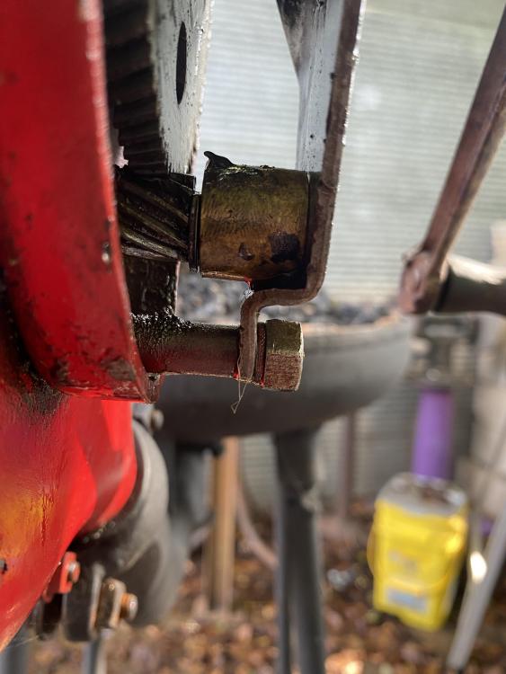

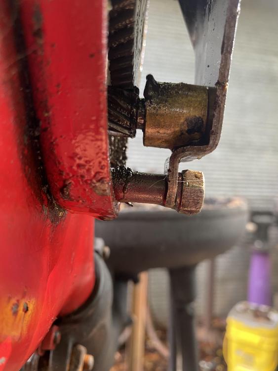

TWISTEDWILLOW Posted August 21, 2021 Author Share Posted August 21, 2021 So…. here I was forging another roasting fork on a bright sunny day, minding my own business and cranking away happily on the tiny Buffalo blower, when all the sudden I hear an unholy chatter of metal on metal and the blower locked up! so I try backwards and forwards to no avail! Then I look at the impeller and I see it’s set screw is loose, so I says to myself that’s an easy enough fix and I grab a wrench and I reset the impeller on the shaft to where it turns both ways agin without hitting anything and I tighten down the screw… it chatters agin…. So I grabbed the shaft and realized that it had play back an forth, i thought we’ll just pop the cover off an have a look, maybe something came unhooked? I got the cover off and started inspecting everything to see what caused the shaft to get play all the sudden, well as I was looking around I noticed a little chunk of something covered in grease and stuck to one of the gear teeth, I wipe it off to discover its part of a washer/spacer, and as I rubbed it between my fingers it crumbled, so I looked at all the other gears and shafts and noticed they all had these fiber looking washers on them, so I guess that this one finally just gave up the ghost after 70-80 years. I contemplated taking everything apart so I could just put in another washer but then the thought hit me, that if I take this dude apart I’m prolly gonna end up breaking all the fiber washers! Not to mention trying to get all the gears back together just right so I nixed that idea an went digging around the shop for inspiration, and that’s when I found my miscellaneous drawer of odd and end pins and keepers, so I grab that an start digging through it until I found a couple sizes of e clips that looked close to the shaft size, and a pair of needle nose pliers, I snapped it on the shaft and bam! That fixed the play in the shaft and now the blower turns free in both directions with no noise! anyways I thought I’d share because I’ve seen others asking for help before when their blowers go haywire, it may not fix every blower problem but if anyone runs into a similar problem where a spacer has gave way an allowed some slop in a shaft then this is a cheap easy fix and you may be able to do it without dismantling the blower risking making a bad problem worse, Link to comment Share on other sites More sharing options...
Irondragon Forge ClayWorks Posted August 21, 2021 Share Posted August 21, 2021 Very good information to have. Link to comment Share on other sites More sharing options...
Frosty Posted August 22, 2021 Share Posted August 22, 2021 Oooh, good fix TW. My question is it going to rub and be a wear concern? The spacer being fiber says "sacrificial wear point" to me. That's not an IS statement, I'm wondering IF. Frosty The Lucky. Link to comment Share on other sites More sharing options...
TWISTEDWILLOW Posted August 22, 2021 Author Share Posted August 22, 2021 Thank you Irondragon, and thank you to Frosty! I thought of that too, the clip snapped tight enough on the shaft so it’s not gonna fall off but just loose enough that it can spin on the shaft and there is clearance on Both sides of it between it an the gear teeth on one side and it an the brass bushing on the other side, I cranked it for a couple minutes watching to see if it was gonna ride up on one or the other an cause wear but it spins nicely and never froze up a didn’t rub on anything, so I figure if the blower stays well lubricated an everything stays clean then it would probably continue to work for a very long time with no issues, but I’ll probably pop the cover off a couple times a year an double check that it’s not wearing on anything just in case. An after thought that I had was this tiny Buffalo was designed for a bbq grill and was never intended for hours of use like I’m using it for, but I noticed yesterday that it has the same exact gear box as one of my stand alone Buffalo forge blowers so Later I think I’ll pull the cover off that one an see if it has the fiber washer also or if they put something different in it since it was designed for forge work? Link to comment Share on other sites More sharing options...
TWISTEDWILLOW Posted September 17, 2021 Author Share Posted September 17, 2021 Well so far the quick fix has been holding up good, ive put a lot more hours on the tiny Buffalo and no problems! Link to comment Share on other sites More sharing options...
