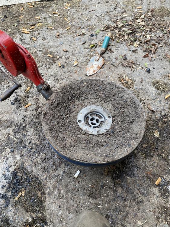

my plan is to line the the entire pan with clay mix,I wasn’t planning on using any dirt.

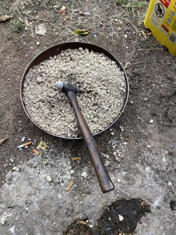

I’ve got plenty of red clay and I just got done crushing up quite a few fire bricks and I’ve got a bucket of wood ash. So I figured I’d have enough mix to completely line the pan and still have enough leftovers to line one or two more pans. Or I can use the leftovers to line an antique cast iron rivet forge I’ve got. 51B8B81D-4FB2-4638-953D-DD310272F794.thumb.jpeg.e26a2d96e5fe1bbe7ca1f38342e32cd6.jpeg2C3A3C94-09AB-4FA2-B901-16903B05B66F.thumb.jpeg.975f5a968b00fa70a22f21e5f1c866cf.jpeg
Here it is with all three mixed, It was moist but I had to add more water to it to get it to stick to the pan, then I built off of the wet part and I used a rubber mallet to pound it all in. I finshed by sprinkling a little dry over the top and pressing it into the wet. DEDD09D3-0F45-4313-BEA2-AAE24170B74F.thumb.jpeg.d4a88cc4406fd47438ffd19da78ac73f.jpeg383D4B22-211D-4D1A-89FB-A2EF8A45320C.thumb.jpeg.e1787a9b132a2f01c2e138f645bfa249.jpegF470371A-365C-4CDD-8F22-524E84707330.thumb.jpeg.341266c771bb7454e192bd7df9b9fbb7.jpegDF6AA014-C17A-4E97-847F-C10FDF8A67B7.thumb.jpeg.757849e3def12952185d2566ad36810a.jpeg9357CCFC-D17B-416B-8C0A-7233C3BF23CE.thumb.jpeg.6bf82654a1452db71edb2b4bc37762ce.jpegC4F28C44-6CF7-4A94-9AEF-4E563EE229FE.thumb.jpeg.10cbd63bef9bd4f7541c95bb90113893.jpeg

How thick did you clay it? An inch or so is plenty on a steel pan.
I think you'll have better luck keeping your air grate clean if you turn it over. With it making a bit of a dome the clinker will brush down off it fairly easily. If it forms a little cup you'll have to dig clinker out.
I think you could've crushed the fire brick almost to sand or used less. The chunkies look pretty large to me.

Frosty, I agree with you I don’t think I got the fire bricks hammered down quite enough… there were some chunks,
I may have overdid the liner it’s much more than an inch it’s probably closer to two or two and a half thick.
I’ll go ahead and turn the grate over while it’s still wet.
I just turned over the grate and used a rubber mallet to hammer it down. I like that much better now all the air holes are usable instead of just the center three, thank you for the suggestion Frosty, I hadn’t thought of that. 6C9CA49F-CCAD-44F8-8334-8F31614C9FBC.thumb.jpeg.7e30cec8af77af9a61cf5e9304f8e06d.jpeg

Frosty, after this forge is done I’m gonna hammer down the leftover mix some more to get the chunks down finer and the next pan I think I will definitely line a little thinner. Because this one is turning out a little heavier than I wanted but maybe it’s all the water? Im gonna let this set all week in the heat with a fan blowing over it so hopefully by this coming weekend it will be dry enough to put a fire in.

If it's cracking you used too much water just hammer it down again. It's just dirt you know. ;)
I don't wait for the liner to dry before firing mine up on the occasions I use coal. I don't keep my cast iron pan forge lined, I keep the clay in a bucket in the shop.
You only want JUST ENOUGH moisture it will form a clump in a squeezed fist. If it leaves your hand dirty it's too moist, add some more dry soil and leave it over night to temper.
If you've ever done and green sand casting that's the moisture content you are shooting for.
