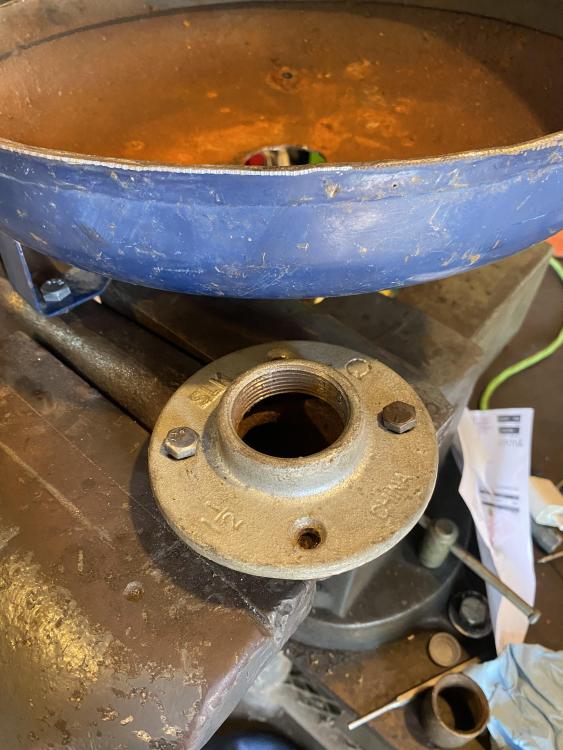

I think I’m gonna cut a plate to match the flange on the air supply and weld this coupling to it then weld the pan to the coupling. Then drill the holes in the plate so I can bolt it to the air supply flange.
     Then I’ve gotta go find some clay, I was thinking about using Oklahoma red dirt clay, it’s everywhere, it free and easy to find, but it’s also full of little bitty rocks so I might get lazy and just buy some fire clay.
Also I haven’t figured out how I wanna do the legs yet, I’d like to make them removable with sockets for them to slide into and set screws to lock them in place. That way this mini forge can be completely disassembled and moved portably. 32533FCC-90D4-41A2-9ED4-D43490298A58.thumb.jpeg.b7e78efd0f1d9c0b6c34ad39400e9c85.jpeg

I was thinking the handle material from the pancake compressors may be strong enough for legs on such a small forge and would be a lot lighter than sucker rod. For portability, you could weld pipe unions to the forge and pipe nipples to the handle material and be able to quickly screw/unscrew the legs. Could even set three legs angle out with 1/4” rod bar hooked on the ends to brackets on the legs  to prevent them splaying out.

Why don't weld use a Floor flange to the bottom of your pan and bolt the blower to it? You'll need to match the bolt holes, there should be a corner to corner distance that matches well enough. This is a forge air tight is not necessary but you DO want to be able to remove the blower without having to deal directly with rusted bolts or breaking welds. Hmmm?

Goods, I really like your idea of making the legs screw on and off, still want to use my sucker rod legs so I have more weight on the bottom preventing the forge from being top heavy, but your idea about welding couplings on so I can thread them off and on is great! I hadn’t thought of that. And it a lot easier than drilling and tapping set screws.
Frosty, I like your idea about using a floor flange that’s a lot less headache than what I was over thinking,agin I hadn’t thought about that either!
I'll probably use both of those ideas, thanks for y’all’s help

I’m just glad that I have piles of random pipe fittings laying around. It looks like it’s all gonna match up perfectly. 4F21768C-479C-4993-B872-6F02D3265C11.thumb.jpeg.5bab17cf5aeda1b051a396d0f370e04c.jpeg0AD163A1-7AF5-402F-9AE0-61FDC109AED4.thumb.jpeg.c6f964a32211a0ff2db044e2a7ef92b1.jpeg

Legs, I would do simple equally spaced sockets around the perimeter of the forge pan that they slip into with a depth stop welded to the leg. The legs can stick up a few inches past the socket which would provide posts for a windshield, or hood with sockets, to be dropped over them.  Having the legs out that far will provide a lot of stability, easy to install / remove, and wouldn't require tools for assembly.
