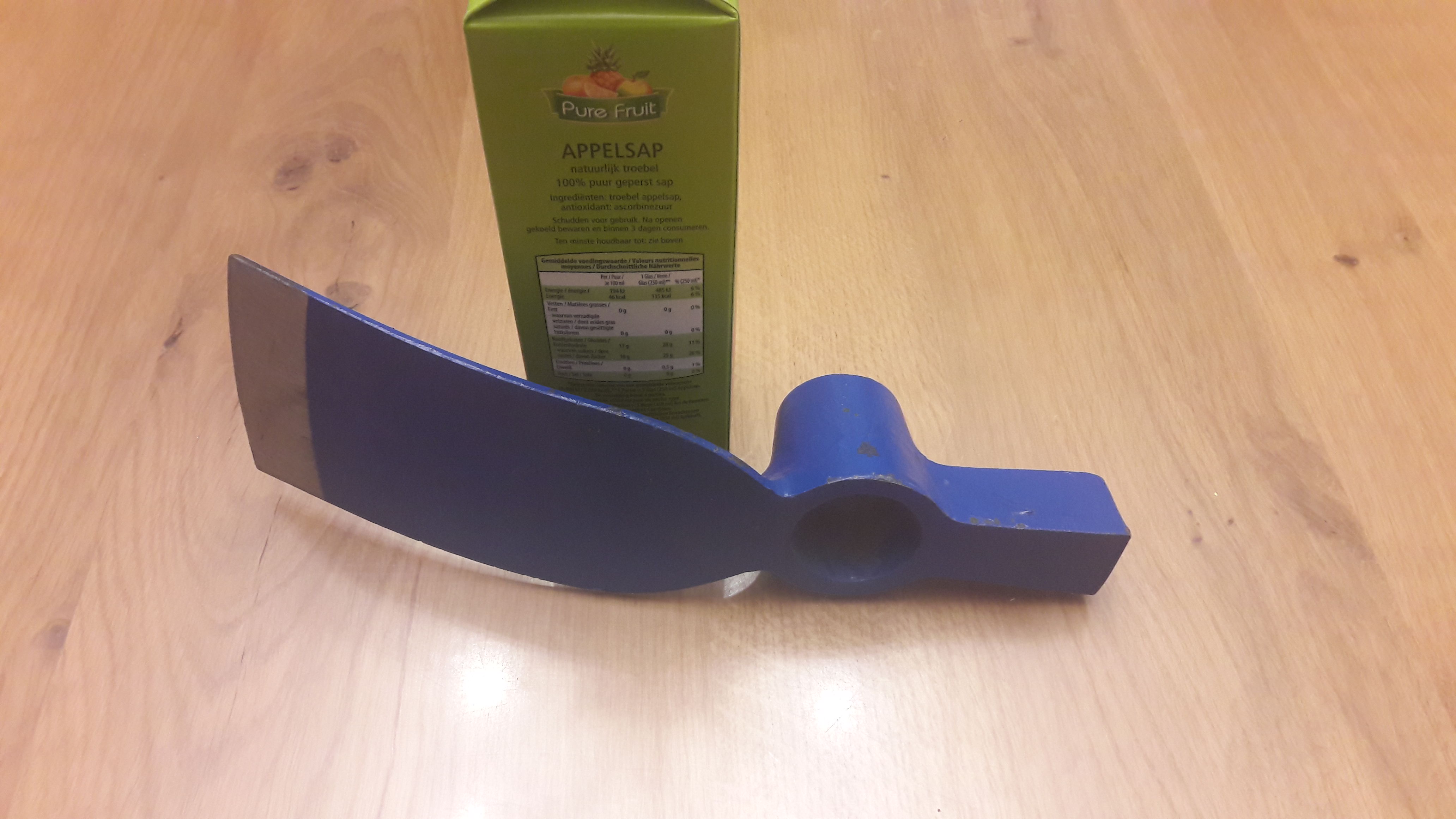

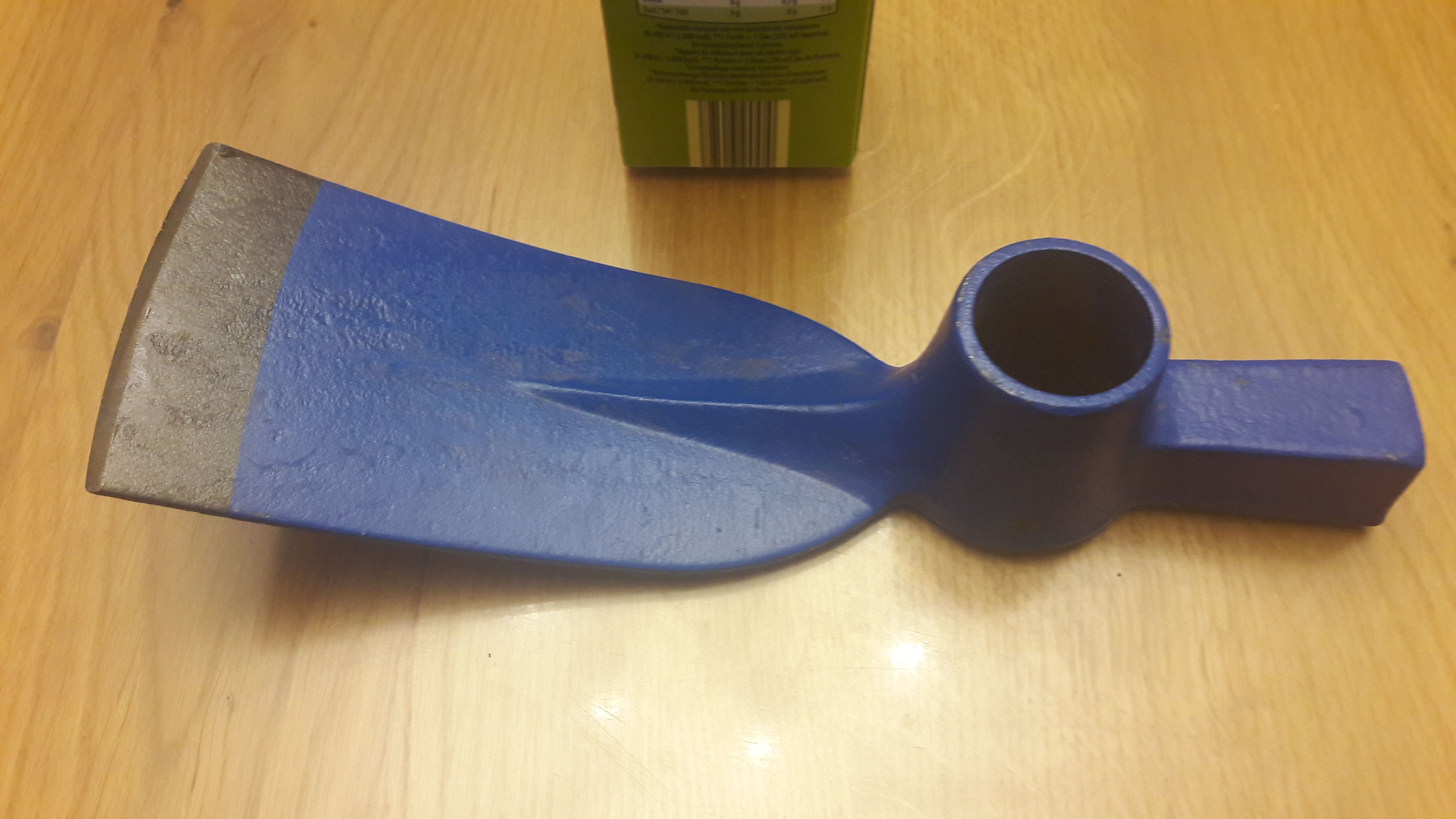

BartW Posted April 26, 2021 Share Posted April 26, 2021 Hello Everybody; I recently got a box of these (literally a couple dozen). I handled 3 (long handle; medium and short) and parked them in the garden shed; but how many does anyone need .... Goofing around I already made a warhammer from it, but this is more cutting parts off and grinding some. But it's good steel (I guess C50, as it hardens in water and it's somewhat the standard steel of the supplier), so I wonder; can you forge this thing into an axe ? Quote Link to comment Share on other sites More sharing options...
pnut Posted April 26, 2021 Share Posted April 26, 2021 You could probably use the blade for wrapped eye tomahawks or make a froe from the entire thing. I'm sure some people will be by with some other ideas as the day goes on. Pnut Quote Link to comment Share on other sites More sharing options...
Rojo Pedro Posted April 26, 2021 Share Posted April 26, 2021 I wonder what the intended purpose was.? I have used a life time of digging and pounding tools but thats a new one for me. I would cut off the blade and try to forge the hammer end into an axe. Have fun and post some pictures Quote Link to comment Share on other sites More sharing options...

ThomasPowers Posted April 26, 2021 Share Posted April 26, 2021 Blowhorn stake for tinsmithing? I just got a pickaxe head with the points on either end and cut off one to make a sq drift out of. Any way to trade those for something more suited to your uses? Quote Link to comment Share on other sites More sharing options...
BillyBones Posted April 27, 2021 Share Posted April 27, 2021 C50 in the states is equivalent to 1050. At least that is what the inter web machine tells me. So i would say, why not? I can see a few things. Tomahawk, adz, garden trowel or spade, etc. Quote Link to comment Share on other sites More sharing options...

Frosty Posted April 28, 2021 Share Posted April 28, 2021 Uh. . . . that is an adze, Billy. Frosty The Lucky. Quote Link to comment Share on other sites More sharing options...
arkie Posted April 28, 2021 Share Posted April 28, 2021 On 4/26/2021 at 7:37 AM, Rojo Pedro said: I wonder what the intended purpose was.? I have used a life time of digging and pounding tools but thats a new one for me. I would cut off the blade and try to forge the hammer end into an axe. Have fun and post some pictures That's just a plain old grubbing hoe. I have one just like it, and my dad did as well. The knob on the thing could be used to bust up rocks you uncovered. Quote Link to comment Share on other sites More sharing options...

Leather Bill Posted April 30, 2021 Share Posted April 30, 2021 Tools with grainy finish like that tend to be low quility. I've been digging for various reasons many years and never saw a tool like that. I would call it a mattock and mattocks come in many configurations. Most popular are pick mattock and cutter mattock. Handle hole is oval in every mattock I've seen. Quote Link to comment Share on other sites More sharing options...
